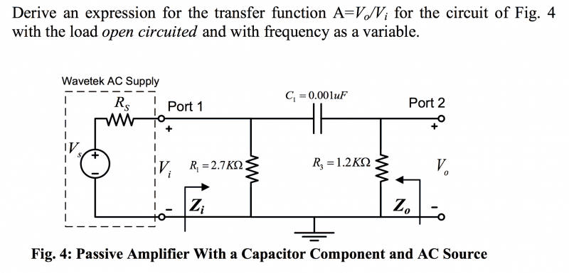

Here is the problem:
Circuit schematic of a passive amplifier with a Wavetek AC supply, Rs, Port 1 with Vi and Zi, R1 = 2.7 kΩ, C1 = 0.001 µF, R3 = 1.2 kΩ, Port 2 with Vo and Zo, and a ground connection.

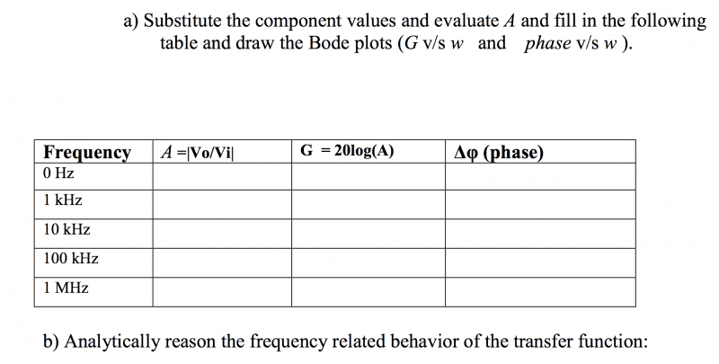

Table with columns Frequency, A = |Vo/Vi|, G = 20log(A) and Δφ (phase), rows for 0 Hz, 1 kHz, 10 kHz, 100 kHz and 1 MHz, with the value cells left blank, above the text b) Analytically reason the frequency related behavior of the transfer function.
