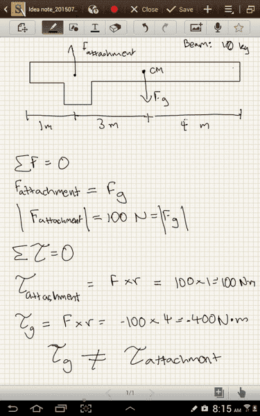

I am trying to resolve for the forces in the attached diagram. In order for this object to be in rotational equilibrium, the torques of the normal force and the garvitational force would have to be equal. However, this would imply that normal force produced by the fulcrum would be far greater than force of gravity at center of mass. The problem is that for an object to be in mechanical equilibrium, the forces must also be equal. So how can both of these be true? The other issue I am having is that you are allowed to find torques using any axis. If that is true and I set the axis of rotation to be the point of contact with the fulcrum, then there will be a net non zero torque. So how is this situation pssible?

So at the attachment of a cantilever beam there is a torque as well as a net force. Without that additional torque, as you mention, there is no static solution. For example, if you attach with a hinge instead of a cantilever then the beam will fall until it hangs below the hinge.
But then, if a net force is present, how is it possible for the beam to remain in translational equilibrium?
If it is in equilibrium then there is no net force and no net torque.
##F_{normal }=-F_{g}##
Then that means that there is a net force on the beam. But the beam is in static equilibrium and for that to be the case there cannot be a net torque or net force.
Sorry, my words are confusing. The net force on the beam is 0. The force at the cantilever attachment is non zero.
So then if the forces are equivalent, how then can the torques be equal? The normal force has a smaller lever arm than the gravitational force.

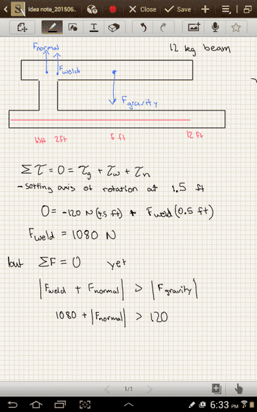

I am still having issues with this. When I put in actual numbers I still end up having a net force or net torque. Can you see my work?
So again, I would not treat it as two forces. I would follow the standard practice of treating it as a force and a torque. If you do that then the force is clearly equal to ##-F_g##. The torque can then be calculated by setting the axis at the normal force and calculating the opposite of the torque due to gravity.

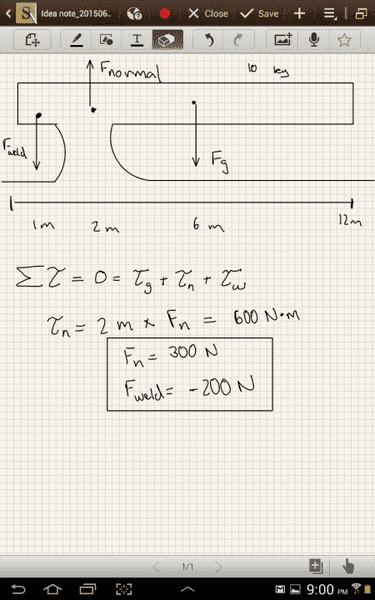

Is this how it should be?
Yes. That is the right idea, but I think your numbers are off.

It looks like the distance from ##F_{normal}## to ##F_{weld}## is 1 m and the distance from ##F_{normal}## to ##F_g## is 4 m. So the weld force should be 4 times the gravitational force.
