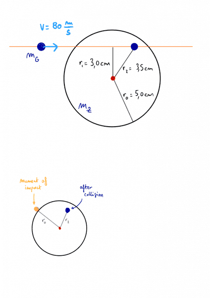

Hi everybody! I'm preparing myself for upcoming exams, and I struggle a little with conservation of angular momentum. Can anybody help me understand how to solve such problems?
1. Homework Statement
(for a better comprehension, see the attached image)
We have a wooden cylinder of mass mZ = 600g and of radius r0 = 5cm, which can rotate around its symmetry axis. Someone shoots on it, and the projectile has the mass mG = 5.0g and initial velocity v = 80m/s. The distance between the linear trajectory of the projectile and the rotation axis of the cylinder is r1 = 3.0cm. The projectile penetrates the cylinder and stays stuck at a distance of r2 = 3.5cm from the rotation axis of the cylinder.
a) What is the frequency of rotation f of the cylinder after the impact? Where and how should you shoot the projectile in order to obtain maximum/minimum frequency?
b) Which part of the kinetic energy is used to deform the wooden cylinder?
c) If the cylinder was not fixed on a rotation axis but on a thread, what would be the differences to previous case when the projectile hits the cylinder?
So I imagine both conservation of linear momentum and of angular momentum are important. We also know that ω = 2πƒ.
Okay I give it a go:
We know that the linear momentum is conserved, that the cylinder is not moving before the collision and that the two objects are moving together after the collision:
mG ⋅ v = (mG + mZ) ⋅ v'
Here I already see a problem: v' is supposed to be the tangential velocity of the system cylinder-projectile after the collision, but I believe a projectile located at r2 = 3.5cm does not have the same tangential velocity as a point located at r0 = 5.0cm. Is that correct? Then we would have mG ⋅ v = mG ⋅ vG' + mZ ⋅ vZ', which is also not so great.
I encounter the same problem with the conservation of angular momentum:
mG ⋅ v ⋅ r0 = (mG + mZ) ⋅ v' ⋅ r0
or
mG ⋅ v ⋅ r0 = mG ⋅ vG' ⋅ r2 + mZ ⋅ vZ' ⋅ r0
I feel like I'm missing something, since none of those equations lead me anywhere :( Furthermore, I never manage to involve r1 in the equations, which obviously plays a role because of the 2nd part of the question. Can someone give me a clue so that I clarify my misunderstandings?Thank you very much in advance.Julien.

You appear to have completely ignored the moment of inertia of the cylinder.

I'm not sure I follow what you are doing. You seem to be unsure what is moment of inertia. In this problem, you have two examples of angular momentum:
1) Angular momentum of a point mass about a point/axis, which I think you understand.
2) Angular momentum of a rigid body about an axis of rotation. In this case you need the moment of inertia (MoI) of the rigid body about that axis. This is not the mass of the body, but a measure of the mass distribution of the body in terms of distance from the axis.
You should know or be able to calculate the MoI of a solid cylinder. This is what you are missing. Your last equation looks wrong as well.

That's the MoI of a hollow cylinder, where all the mass is ##r_0## from the centre.
@PeroK
Sounds bad, but I won't give up :)
Yes I indeed used the wrong formula since the beginning. The moment of inertia of a full cylinder is I believe:
IZ = ½ πhρr4 = ½ mZ ⋅ r2
Now for the rest, I will try to explain you thoroughly my train of thoughts:
I assume the angular momentum of the point mass "projectile" about the axis of rotation of the cylinder just before the collision should be equal to the angular momentum of the cylinder about its axis of rotation + the angular momentum of the bullet embedded inside the cylinder after the collision:
LG = LG' + LZ'
⇔ mG ⋅ v ⋅ r0 = IG ⋅ ω + IZ ⋅ ω
⇔ mG ⋅ v ⋅ r0 = mG ⋅ r22 ⋅ ω + ½ ⋅ mZ ⋅ r02 ⋅ ω
ω being the angular velocity, it should be the same at r0 for the cylinder and at r2 for the bullet, right? At least that's how I attempted to resolve:
ω = (mG ⋅ v ⋅ r0)/(mG ⋅ r22 + ½ mZ ⋅ r02)
Unfortunately I get a bit of a crazy result. I probably still mess something up.

That looks right. What did you get for ##\omega##?
Sorry, just saw you used ##r_0## on the left-hand side. Can you see what it should be?
@PeroK
Well... Around 1468 rad/s2, which would give a frequency of 233.6 Hz.
Nevermind I made a mistake: now ω = 26.45 and ƒ = 4.2 Hz.
That's not right, because you are using ##r_0## for the initial angular momentum.
Aaaah that should be r1, right? I used r0 because I thought the initial velocity would be affected while penetrating the cylinder.
Yes, it must be ##r_1##.
@PeroK
Thank you so much for all of your efforts to help me understand this problem. I now get a frequency ƒ = 2.5 Hz. Would you mind explaining me why we must take r1 on the left side of the equation? I never really got how we are supposed to choose our reference point before a rotational collision, especially in this case of plastic collision.
Thank you very much, I'm going to try to figure out the rest of the problem now.

The angular momentum of a projectile about a point is actually a vector quantity and is the cross product of the linear momentum with the displacement from the point:
##\vec{L} = \vec{r} \times m\vec{v}##
This equates to
##L = dmv##
Where ##d## is the perpendicular distance from the point to the line of the projectile.
