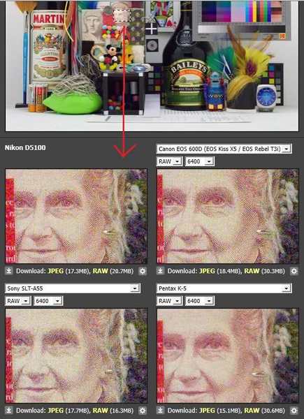

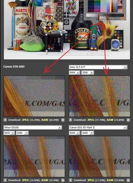

Here are more answers, dpreview has made test shots available with the A77. So if you go to any test, like this of the Canon 60D then you can compare crops of many cameras on this page (in RAW).
In the individual drop down menus you can select available cameras (I selected Sony A77, Nikon D5100, and Canon 5D mkII) you can also select ISO and the crop to compare.
So I went to ISO 3200 and selected a grey area for better noise comparison:
I would consider the Sony A77 a bit underwhelming. The Canon 5D mk II clearly leads the pack, while the Nikon D5100 is slightly better than the three year older sensor of the Canon EOS 60D.
Maybe the Nikon D5100 should be in the very short list of least noise for the best price.
I spent at least a good hour the other day checking out the A77 photos on dpreview and comparing to other camera's I'm looking at. While the JPEGs are questionable, the RAW files definitely bring out the shortcomings of the Sony 24MP sensor. I think I can cross that one off the list given the type of photos I want to take.
