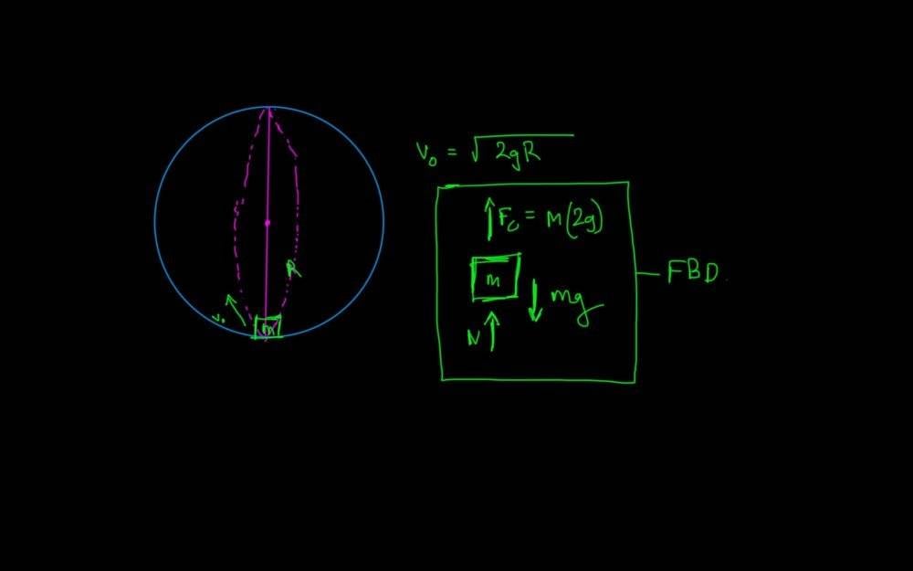

A small block ##m## is projected with speed ##v_0 = \sqrt{2gR}## from bottom of a fixed sphere of radius ##R## , so that the block moves in a vertical circular path.
Attached below.
Does the block move along the pink dotted lines as attached in the figure below?
I tried to draw the FBD of the small block ##m ## at the lowermost point which is also attached below.(The direction of ## v_0 ## is actually tangential)
Is the figure above correct? If not, why?

Your diagram is fine for the initial motion, but the speed will drop as the block rises. What exactly is the question to be answered? You probably need an FBD for a more general position.

Then, as I posted, you need to draw the FBD and write equations for the general position, as described in (i).
Don't bother trying to draw perspective, as you seem to have done in post 1. Just show the plane in which the block moves.

The diagram does not look correct. Since the initial velocity is tangent to the circle, the block will start sliding on the inside surface of the circle, presumably without friction. The questions to consider are, will the block slide all the way up to the "12 o'clock" position or will it fall off at some intermediate point and, if so, where is that point and what is the subsequent path of the block?

The "lowest vertical " means the radius line from the centre of the circle to the bottom of the circle. Take another radius line from the centre of the circle to the block and call the angle between the two radii theta,
Draw the FBD for that.

Hint: Mechanical energy conservation plus a free body diagram. I assume the question to be answered is "Draw the complete path of the block inside the shell."

Good. Now draw a free body diagram of the block wjen it is at ##\Theta=0##. However, before you do that count how many items outside the block exert a force on it. You should draw as many forces acting on the block as you have items interacting with it. Also, draw the acceleration of the block outside the FBD.

The forces I noticed are - Normal Force( Centripetal force here), Weight.
That's it, good job. Now what do you think you should do next? What's the purpose of drawing a free body diagram?

Now should I equate ## F_{net} ## to centripetal acceleration? Is it ## N = 3mg ##?
Yes and yes.

No and no.
##F_{net}## is only equal to [mass times] centripetal acceleration if tangential acceleration is zero. The vertical component of the block's velocity will not be maximized at the bottom of the circle.
