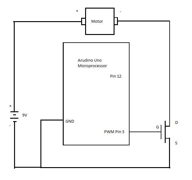

Arudino (UNO) is a Microprocessor. As 13 I/O pins and 8 digital pins and 6 PWMs.
the problem is I don't know how I can power it. I don't think the digital I/O plug can be used as a power source. So I don't know where the I/O pin 12 would go as well as where it would connect, with the resistor , along the circuit. Or How I can power the Arudino. Any Suggestions?
What is "it"? The Arduino Uno or the motor?
Yes I'm using that one. The pins refer to the pins on the board. And I need to power everything with the battery. But I already know how to power the motor I don't kow how i can power the arduino.
Ok...
Check the spec here..
http://arduino.cc/en/Main/arduinoBoardUno
There is a section on the power requirements. The board has a regulator on it that allows you to feed it anything between 7-12V and it will make 5V for the microprocessor. So I would connect the 9V battery to the DC socket. The way you have shown the motor/FET is correct. The motor/FET should have it's own wires to the battery, particularly if it's a powerful motor.

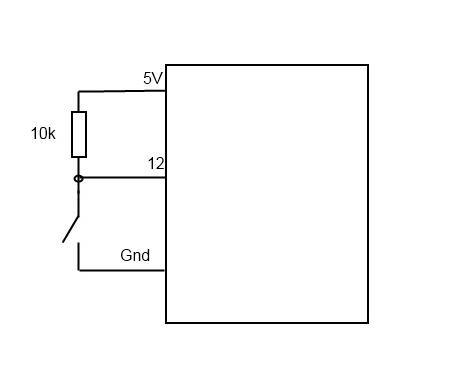

They thoughtfully provide access to the 5V and 0V rails on pins on the board edge which you can use for the control switch (eg Pin 12) as follows... PS I've used a rectangle for the resistor. You should use the symbols in the question.
PS: As an alternative to the DC jack socket you could instead use Vin and Gnd pins for the battery. These are electrically the same. In other words the +ve pin on the DC jack is connected to the Vin pin on the board edge. Both go to the regulator.
