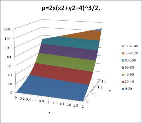

problem statement, all variables and given/known data
A finite sheet of charge, of density ρ=2x(x2+y2+4)^3/2, lies in the z=0 plane for 0≤x≤2m and 0≤y≤2m.Determine E at (0,0,2)m
Ans:(18x10^9)(-16/3ax-4ay+8az)
E=kQ/R2
dE=ρdA / R^2 aR
dA=dxdy[/B]
E=k 2x(x2+y2+4)^3/2 dy dx (-xax-yay+2az ) /x2+y2+4)^3/2
E=k∫∫ 2x dy dx (-xax-yay+2az)
E=(18x10^9)(-4ax-4ay+8az)
How x and y component of E are different in the answer?
Do you see a difference between the x- and the y-dependence of ##\rho## ?
Or: Can you see x = y is not a symmetry line ?
(edit: forgot the +4 in the first upload)

Thanks for the visual. Is there method to find a point of symmetry on that surface?
What if there isn't ?
Do I have to use mathematical theorem? If so I have to give up on this problem. I know how to use Coulomb law and multiple integration with help of Mathematica. This question no 2.50 from Schaum's Electromagnetics.
Ah, didn't really read the small print :smile: and just answered the question "How x and y component of E are different in the answer?". So now it's time to go through your steps and see why you and Schaum end up with different answers.
Let me please use ##\hat\imath,\ \hat \jmath ,## and ##\hat k## instead of ##a_x, a_y, a_z## as Cartesian unit vectors.
Stumble on the first step:
Your relevant equation only describes ##|\vec E|\ ##, so it doesn't help you find the components.
Google (or look up in Schaum) the right equation and look at it carefully: the only vector that determines the direction of ##|\vec E|\ ## in there is ##\vec r-\vec r'## and you can't take it out of the integral because it varies with ##d\vec r' = dx dy##.

My advice: Don't give up. This exercise is very important for your understanding and further curriculum. Make a drawing that shows ##\ \vec E\ ## at ##(0,0,2)## due to a small patch of charge ##\rho dxdy## located at ##\vec r' = (x, y)## in the x,y plane. You will see that the maker of the exercise chose a very nice expression for ##\rho##.
The consider what you have to integrate to find the x-component of ##\vec E##, ##\ \vec E_x = \vec E \cdot \hat\imath \ ##, and remember that you can bring constant factors into the integral. Then idem the y component and the z-component.
Sounds perhaps a bit cryptic. But you should really work this out yourself - if I do it for you it does not help you. So try a first step and post when you get stuck.
Nice of you to like my post. I hope it's for the encouragement, because I am far too critical about your contents. Let me repair the expression with an extra bracket and look at it again... :rolleyes:
OK, so it's all pretty minor. You're doing great and the only glitch is for the x component. All my well-intended teaching blabla doesn't help if you do the ##Ey = k\iint 2xy\, dx dy ## completely correctly and all you are missing is the ##Ex = k\iint 2x^2 \,dx dy ##. Look at this last one again and tell me it was in fact easy ! (and hopefully also that you could have done it without crutches like Mathematica (*) just as well !)
I did find a worked out example for the first few steps. Later on he brings ##\sigma = \rho## outside the integral because it's constant -- you can't do that, but thanks to the nice ##\rho## function you could do other things to get simple integrals...and you did. It was just the last step that went off the rails a little bit.
(*) I have nothing against Mathematica, but here it's just like using a calculator for 2 x 3
Thanks. My fault is on the unit vector. I used to deal with constant z component.
So the unit vector should be (- xi - yj+2k)/|R|. Maybe using aa, ay and az is confusing.
