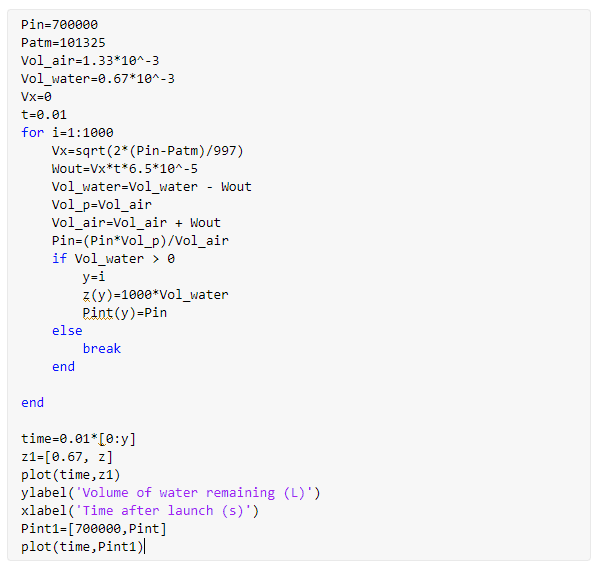

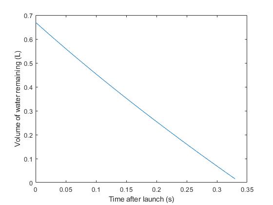

Thanks, that was very helpful. I was able to put the info into Matlab and get some promising data. I was able to use 0.01 second iterations since I am using Matlab. I have posted my code, as well as the data. The almost linear relationship of the volume of water surprised me.
I am also wondering if it is possible to write out this iteration as a differential equation? I assume using calculus would give more exact results.

The next step is to verify your simulation. Anchor your water bottle rocket, video it in action, then measure the time of discharge by counting frames in the video. If you used the correct numbers, and your code is correct, then the simulated discharge time should match the measured time within 5% or so.
If the difference is larger than 5 to 10%, then recognize that your simulation is only as accurate as your assumptions. Did you include entrance loss in the nozzle? Are you assuming that air expansion as the pressure drops is isothermal, adiabatic, or in between? Friction loss in the nozzle? Does the water make a vortex as it discharges? In this type of simulation, errors due to faulty assumptions and simplifications are normally much larger than numerical errors.
I suggest adding code to calculate the acceleration, velocity, and position of the rocket. And verify that code. The last part, of course, is to use your simulation to find the optimal amount of water to get the greatest height. Then, knowing exactly how to get the maximum height, challenge your friends to a water rocket height contest. :smile:
