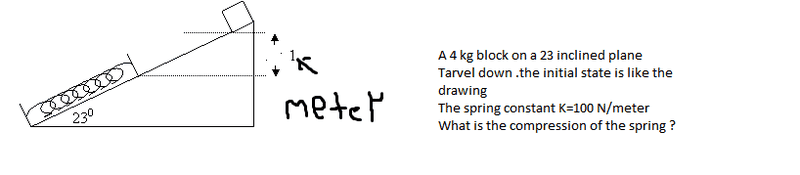

Hi
I need help in work and energy
I Attached the File
tank's
I need some help to help you. Would you mind posting some of the ideas that come to your mind in how to solve this. There are three types of energy in this problem: kinetic, gravitation potential, and spring potential. Which do you think are relevant? Where are the possible places that the energy can be?
I meaning kinetic energy and spring potential
The cube is to striking down the spring
:confused:
Has the question specified that there is no frictional force or drag forces? That is, is all gravitational potential energy being converted to kinetic and all kinetic being converted to spring potential?
yes I believe that is what he means. What I meant to say is that do you see a role for kinetic energy in this question?
Initially, it is evaluated when the block is at rest. It then asks to find the maximum compression; when the block is also at rest.
No, I don't see a role for Kinetic energy, I was just going through the steps.
If you mean how much force it would be if it was just placed onto the spring, at that angle, then it would be weight of the object, in the horizontal direction. So, you would have to resolve the forces, then solve as a usual spring compression: F=kx.
If we are talking about letting it lose, then calculating it, it would be the change in gravitational potential is equal to the elastic potential energy acting on the spring, as it is all converted.
