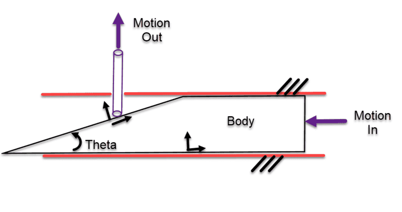

Having trouble forming a FBD to understand a latch mechanism I'm designing. See details below.
I apologize if this is the wrong area to post this in, I've never posted on thisforum before.

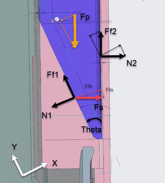

I'm trying to form a FBD of a mechanism that uses linear motion to actuate a pin in a transverse direction. I've attached the general idea in a picture where the pin is free to move up and down. In reality the pin is more of a spring, but I think it will be easier to model as a pin with a given weight so I can assume constant force in that direction. Also attached a more detailed FBD representing actual CAD.
I would like to know the relationship between the incline angle, and resultant push force required to move the body. When I plug my systems of equations into Wolframalpha, I get negative results for N2 and Fp, which indicates I am making wrong assumptions. I even tried a couple different coordinate systems with no luck. My hunch is that my assumption highlighted in red is incorrect.
This is my work so far. Thanks in advance!
General Idea:

FBD for Purple Body:
Free-body diagram of a purple inclined block in contact with a pink surface, showing forces Fp, Fs, Ff1, N1, Ff2, N2, FSx and FSy, with angle theta and X-Y axes in the corner.
Assumptions:
  • Frictionless Top surface of purple Plunger (green surface)
  • Normal Force in X direction is equal to Fs (Fsx = N1)
Known Variables:
Mu1 = Mu2 = 0.3
Fs = 17N
Unknown Variables:
Fp =? (Plunger Push Force)
N2 =? (normal force from cap)
Declaration of Equations:
Fsx = Fs*cos(theta)
N1 = Fsx
Ff1 = N1*Mu1 …. N1 = Ff1/Mu
Fsy = Fs*sin(theta)
Ff2 = N2*Mu2Summation of Forces:
Sum of Forces in X = N1 – Fsx + N2*cos(theta) - Ff2*sin(theta) + Fp*sin(theta) --------->
0 = 17*cos(theta) – 17*cos(theta) + N2*cos(theta) - N2*0.3*sin(theta) + Fp*sin(theta)
Sum of Forces in Y = Ff1 – Fsy – N2*sin(theta) + Ff2*cos(theta) – Fp*cos(theta) --------->
0 = 17*cos(theta)*0.3 – 17*sin(theta) + N2*sin(theta) + N2*0.3*cos(theta) - Fp*cos(theta)
I would flip your diagram so “motion in” is in the +x direction, so that “motion out” will be in the +y direction.
Resolve forces at the contact of the pin on the wedge, to be in the x and y directions.
You then have a classic wedge problem.
Is the pin restrained to remain vertical? If so, how?

I agree that the biggest problem is how you hold the pin and that will be the important design element
to get a feel, first assume all the surfaces are frictionless. Then the "force multiplier" is the inverse of the "distance multiplier"##=\ tan (\theta)##. So a slope of a half will double the force delivered to the pin. Friction will change it a little but the design intent will be to minimize friction

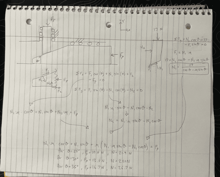

Thanks Guys,
I think I found my main error. I had the Normal force on the plunger body backwards. This should have been pointing inward to the body rather than outward. I did however, redo my coordinate system like you suggested, split the bodies, and added a roller assumption to the vertical pin. Cleans things up nicely! Let me know if you see anything wrong with it, however, I'm getting values that make sense finally.
I did notice when I plug in too large of incline angles, the resultant forces end up switching negative. I assume this is the point in which the wedge "self locks" ? It's greater than 65 degrees or so.
Handwritten free-body diagram and force equations on lined notebook paper for an inclined-plane latch: a plunger with force F_p, an incline at angle θ, normal forces N1 and N2, friction, and worked values for θ = 25°, 30° and 35°.
Fundamentally, a wedge or taper is “self locking” when the arctangent(taper angle) is less than the friction coefficient. But I thought you had eliminated friction in your model.

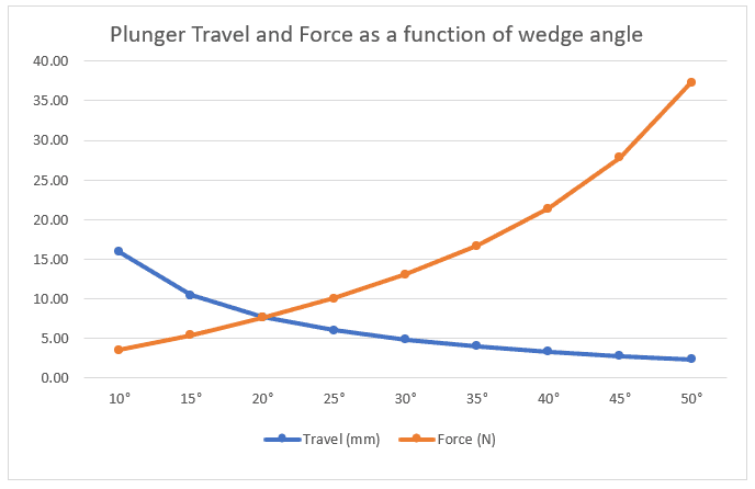

This is kind of what I was after. In order to move the button 2.8 mm, these are the distances needed with forces to go along with the wedge angle.
Line graph titled Plunger Travel and Force as a function of wedge angle, plotting Travel (mm) in blue and Force (N) in orange against wedge angles from 10 to 50 degrees. Travel falls from about 16 mm to about 2.4 mm, while force rises from about 3.5 N to about 37 N.
In a friction free world, the work done on the wedge, is also the work done on the pin.
Work done is force * distance moved.
At 45° the ratio is 1:1, and I read a wedge force of 28 units.
That should be the same as the vertical force on the pin. Is that the case?

It may be the case, but my graph is showing the output assuming friction.
In either case, my model has the Normal force to both the pin and the plunger at contact being equal. And if it was a 45° incline, then I would expect the travel to be the same, so that would be equal amounts of work done on both bodies.
Yes, and the position graph shows about 2.8 units of wedge movement at 45°.
I see no way of knowing what friction coefficient you used for that graph, nor what force was on the pin. Can you reveal those numbers?
Yep, these are the equations I plugged into Wolfram. I varied the theta value and it spit out my N1 variable as well as the Fp variable (push force). A force of 17 N is the external force on the pin. X is my friction coefficient (0.3).
N*X*cos(theta)+N*sin(theta)+X(N*X*sin(theta)-N*cos(theta)) = F,
N = 17/(cos(theta)-X*(theta)),
X = 0.3,
theta = 25*pi/180
