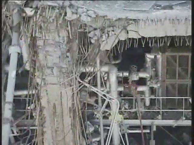

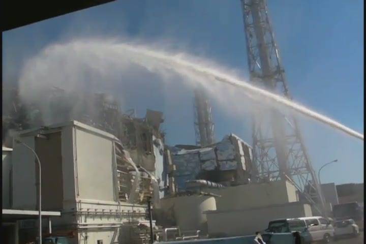

These two photos ...
are linked from the Tepco handout page. Above the links the page says:
"A picture taken from the concrete pumping vehicle, the spent fuel pool, Unit3, Fukushima Daiichi Nuclear Power Station
(pictured on April 14, 2011)"
The picture to the left I cannot recognize as having anything to do with unit 3 at all, nor indeed, a spent fuel pool. I am not sure this photo is even from the vicinity of unit 3.
The picture to the right appears to me as something that could very well be from unit 3, however that would be from the north end of the building, not at the spent fuel pool, which is situated in the south end of the buiding
I wonder if anyone might have been more successful than I, in an effort to locate the motives of these two photos?
For comparison, here's how the roof floor of unit 3 with its SFP (the greeny area) looked in Tepco's skyview from April 15th:
[URL]http://www.tepco.co.jp/en/news/110311/images/110415_1f_3_4.jpg[/URL]

NHK, Japan's national broadcaster, positioned a TV camera 33 kilometers southwest of the plant, and broadcast the helicopter operation live. At 9:48 a.m. local time a helicopter flying from the west dropped the first load of water almost directly over the No. 3 reactor, though a significant amount spread away from before reaching the target.
http://spectrum.ieee.org/tech-talk/energy/nuclear/helicopters-and-cannons-spray-water-on-japans-unstable-nuclear-plant" Field of view is about the same in this video after appox. 30secs as with the #3 explosion video. A good guess for syncing a sound track.

Found an article in IEEE Spectrum that says Honeywell's T-Hawk drones took radiation measurements along with hours of (lousy IMO) video. TEPCO has yet to release any of that data.
http://spectrum.ieee.org/automaton/.../robotic-aerial-vehicle-at-fukushima-reactors
The flow of information is going to get much worse on Monday. That's when the Japanese government takes control of the public information releases and puts the muzzle on TEPCO. Foreign journalists and bloggers have so far been banned from the government press conferences. At the TEPCO affairs the foreign reporters are the only ones asking the tough questions. If they continue to keep the foreign press out of the loop at official government press points then the information flow will be reduced to a trickle.
