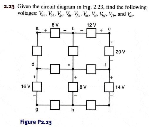

I am having trouble with the attached circuit to find the voltage drops. Can anyone please assist. Thanks

Ok I used the loops ad, be, dg, ef. All going clockwise from the node.
to get 4 equations and I set them equal to zero. however, from those four equations. you can't solve for any unknown variable. Please let me know if this is solvable as I have tried several different ways and can't come up with any solution.
Thanks

Yes … there are only 4 independent equations, and 6 unknowns.
In fact, it's obvious that you can choose Vde and Vef to be anything, and still solve for all the others. :frown:
Was there any other constraint … for example, all the resistances being equal? :confused:
It's strange that they would ask for the voltages, Vfa, Vac, Vai, and Vfb, since they can be determined without solving anything.
The remaining voltages can be found by traversing paths that don't pass through Vhg and Vih.
If you define 6 loop currents I1 through I6 in the loops as indicated, clockwise:
I1 = abed
I2 = bcfe
I3 = dehg
I4 = efih
I5 = abcfed
I6 = defihg
and create a 6x6 matrix to solve for the 6 unknown voltages, you will find that the matrix is rank deficient. The matrix has only rank 4, which means that two of the unknowns can be selected arbitrarily.
Designate a voltage by the symbol Vxy, which represents the voltage between nodes x and y, with node x being the positive end.
Let Vhg and Vih be selected arbitrarily; the we can solve for the other four:
Vda = Vhg+Vih+14
Veb = Vih+14
Ved = 8-Vhg
Vfe = -6-Vih
If you let Vhb = 0 and Vih =0, then:
Vda = 14
Veb = 14
Ved = 8
Vfe = -6
I hope I didn't make any mistakes, but you should check it out yourself.
