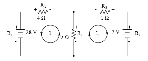

Using kirkchhoff's, how do I work out the branch currents using three or more loops?
Usually what I do is just assume just make two loops like this:
I do clockwise = anti-clockwise for both loops and then I do simultaneous equations.
For three loops, after I've got all the equations, do I still use simultaneous equations? If so, how do I do simultaneous equations? What two do I use to calculate each branch?
Yes you still use simultaneous equations. You will have as many equations as there are loop currents (equal to the numebr of independent loops).
There are several methods to solve simultaneous equations. That's a matter of mathematics and largely a personal choice that depends upon your educational experience in equation solving. Some people stick to manual equation manipulation and substitutions, others use matrix methods such as Cramer's rule. When the number of loops exceeds three or four, manual methods become tedious and error prone, and most will resort to computer based solvers or matrix methods.

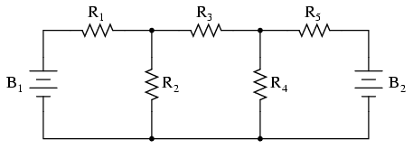

If I'm doing a circuit like this:
If I have the equation for loop 1, 2 and 3, how is it I use them when I do simultaneous equations?
To find I1, do I just do (loop1-loop2).
To find I1, can I just them sub I1 into loop2's equation?
Then to find I3, do I do loop1-loop2-loop3?
You'll have three equations with variables as i1, i2 and i3. To find each, you'll need to solve the equations simultaneously using a convenient method.

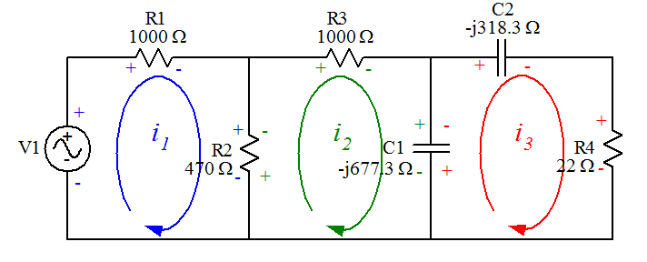

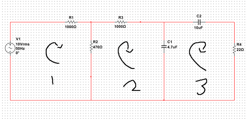

If you look at the attachment, that is the circuit I'm actually using. It doesn't have two voltage sources, it has only one, but it does have three loops, which I highlighted as 1, 2 and 3.
For this, would I do the same thing?
i1 = loop1-loop2
i2= i1 substituted into the loop2 equation
i3 = loop1-loop2-loop3
Again, you should show the actual equations that you are referring to as "loop1" through "loop3". I have to presume that your "loop2" equation will contain all three variables i1, i2, and i3 since loop2 boarders both other loops. So you won't find i1 directly by taking the difference between two equations.
So, what are your three loop equations for this circuit?
That diagram that is shown above, is that the correct direction that I put the loops?
Usually when I do kirkchhoff's, I have two sources, one at the left and one and the right, and two loops. Usually I have two loops going different directions.
I'm trying to do clockwise = anti-clockwise, but when I'm doing the second loop, I don't know what to do with R2, is that clockwise or anti-clockwise. In one loop it's clockwise, in the other it's anti-clockwise.
Am I talking rubbish? I'm confused.
Your diagram is fine. You are free to choose the current directions any way you wish: it won't matter, the math will take care of finding correct values for the currents. If the chosen direction happened to be "wrong", the result will be a negative value for the current, indicating that the current is actually flowing in the opposite direction to your guess.
Usually one simply chooses all the currents to have the same direction, clockwise as you have done it being the most common choice.
R2 has two loop currents (also called "mesh" currents) flowing through it. Your equations must take into account both of them. Once you've solved for the loop currents, then the actual current flowing through R2 will be given by their superposition: ##I_{R2} = i_1 - i_2## given the choice of current directions that you've drawn.
The equation I got for loop 1 is:
(1470+j0)i1 + (470+j0)i2 = 10+0j
The equation I got for loop 2 is:
(470+j0)i1 + (1470-j677.26) + (0-j677.26)i3 = 0Is that correct?

No, the signs for your i2 and i3 terms are both incorrect. You need to respect the chosen loop current directions when determining whether they contribute a potential drop or a potential rise when doing your "KVL walk" around a given loop.
For example, when you follow the current i1 around loop 1 and come to R2 you are proceeding in the same direction as the current so the resulting potential change is a drop. But note that loop current i2 is also flowing through that resistor but in the opposite direction. Thus your "KVL walk" is against that current, so its contribution to the potential change there is a rise. So since you're summing potential drops you would write for the R2 term: ##470 ( i_1 - i_2)##. That gives a negative sign to the i2 term in your first equation.
I corrected my answers, is this now correct?:
Loop 1:
(1470+j0)i1 -(470+j0)i2 = 10+j0Loop 2:
(470+j0)i1 + (530-j677.26)i2 - (0-j677.26)i3 = 0
Your Loop 1 equation looks fine.
There are problems with your Loop 2 equation. How did the first term end up being positive? If you do a KVL walk around loop 2 following the clockwise direction of i2 then current i1 is flowing against the direction of that walk as you pass through R2. That means i1 provides a potential rise for that walk. I also don't see how you found a real component of 530 for i2; the total real impedance in that loop is 1000 + 470, or 1470 Ohms.
It may help you to mark up your circuit diagram with the expected directions of potential changes for the loop currents before you start writing your equations. Then you can compare the terms in your equations with what you expect to find:
Is this now the correct value for loop 2:
-(470+j0)i1 + (1470-j677.26)i2 - (0-j677.26)i3 = 0
Yes, that looks fine.
