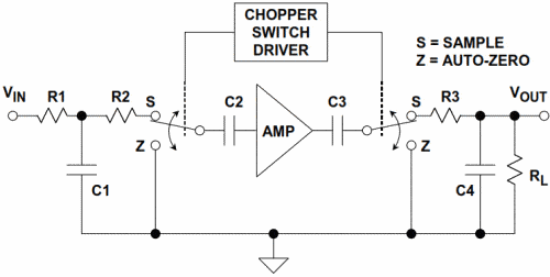

How will you measure a voltage of range 0.0001 volts using the 741 OP-AMP?
This a viva question and i couldn't answer. I don't know how to begin. Should i use Sample and Hold circuit or something else?

It's been 30 years since I did this so I'm very rusty but I'm thinking perhaps build a chopper amplifier? You add a square wave to the input voltage, amplify it, then demodulate it...
http://electronicdesign.com/analog/chopper-stabilized-op-amps
Perhaps this is what he was hinting at when he said
"Even a small value of current will cause the voltage to drop.It is very low Voltage. Current shouldn't pass."
Perhaps by adding a square wave you can alternate the direction of the current through the source so on average it's zero?
Like I said I'm very very rusty!
Google found a block diagram...although it's not quite what I expected...
http://www.programmableplanet.com/author.asp?section_id=3034&doc_id=266134

I tried understanding this Chopper thing but i just couldn't. I haven't studied this chopper amplifiers in my course work.
