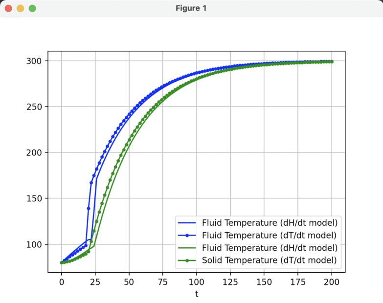

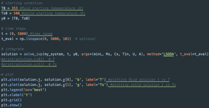

Agreed. I checked and RK45 - or Runge-Kutta 4th and 5th order - the method used by solve_ivp in this case is explicit. The package offers implicit methods also (just involves changing the method = 'RK45' keyword).
I switched to LSODA, which is a wrapper from the FORTRAN solver ODEPACK, and the instability issue was fixed:

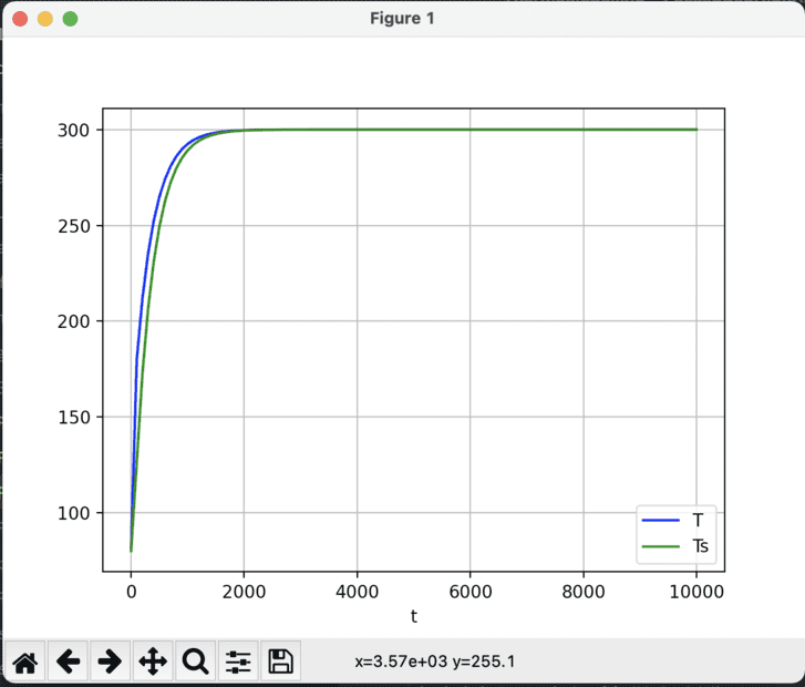

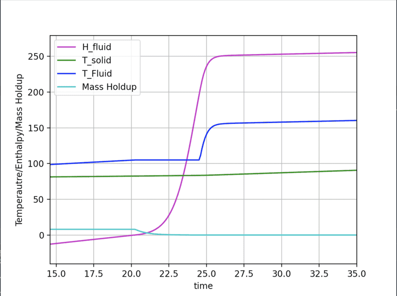

As I said, working on the phase change model this morning

Chestermiller said:
I would use $$h=C_{PL}(T_1-T_R)+$$$$[C_{PL}(T_{sat}-T_1)+\Delta h_{vap}+C_{PV}(T_2-T_{sat})]\left(\frac{T-T1}{T2-T1}\right)$$
So given the heat balance to the fluid:
##m\frac{dh}{dt}=\dot{m}_{in}(h_{in}-h)-UA(T-T_S)##
And the enthalpy equation for the liquid:
##h=C_{PL}(T-T_R)## for ##T\leq T_{sat}##
Leaves us with this equation for the liquid phase:
##mC_{pL}\frac{dT}{dt}=\dot{m}_{in}C_p(T_{in}-T)-UA(T-T_S)##
I'm unsure about the phase change zone though (haven't tried the gas phase yet but it looks to be similar to this one). Heres my train of thought:
For ##T1 \leq T \leq{T2}##, your equation is:
##h=C_{PL}(T_1-T_R)+####[C_{PL}(T_{sat}-T_1)+\Delta h_{vap}+C_{PV}(T_2-T_{sat})]\left(\frac{T-T1}{T2-T1}\right)##
So we need to take the derivative of this term. The first term will be zero, as ##T1## and ##T_R## are constants. For me it seems to make sense to expand the fraction on the right to:
##m\frac{dh}{dt}=0+####[C_{PL}(T_{sat}-T_1)+\Delta h_{vap}+C_{PV}(T_2-T_{sat})]\left(\frac{T}{T2-T1}\right)#### - ####[C_{PL}(T_{sat}-T_1)+\Delta h_{vap}+C_{PV}(T_2-T_{sat})]\left(\frac{T1}{T2-T1}\right)##
Now, the last term seems to be zero also as these terms are all constant (I know my definition of the derivative above is technically wrong as I'm still cancelling terms). This leaves us with:
##m\frac{dh}{dt}= ####[C_{PL}(T_{sat}-T_1)+\Delta h_{vap}+C_{PV}(T_2-T_{sat})]\left(\frac{T}{T2-T1}\right)##
If the above is correct, this gives us the final equation for ##\frac{dh}{dt}##, I'm not sure how to go from this to a ##\frac{dT}{dt}## term though, as we can't just sub in ##dh = C_{pL}\frac{dT}{dt}## like before.
Is the above approach correct? If so, how could I go about getting a dT/dt term from the dh/dt term?

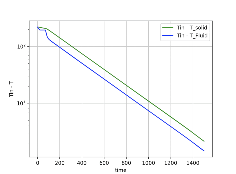

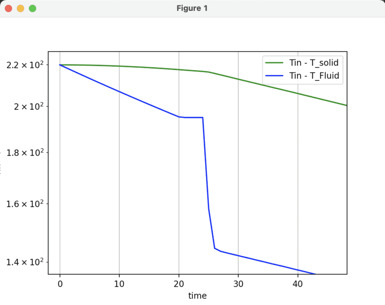

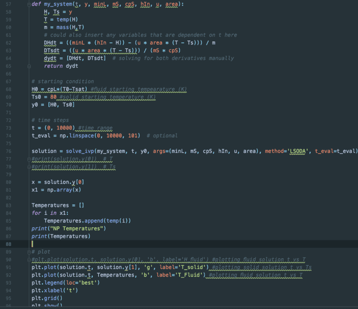

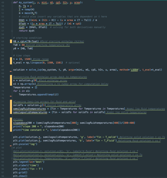

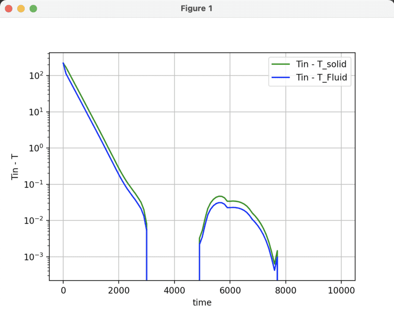

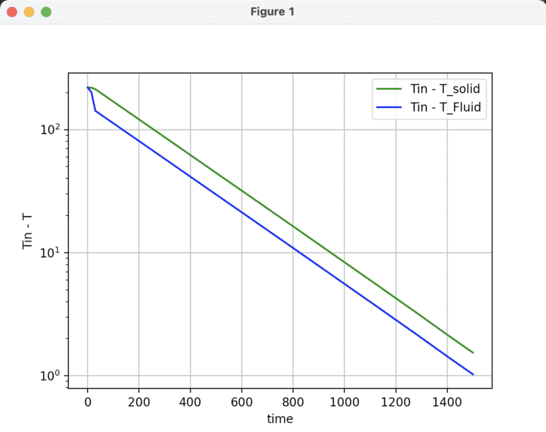

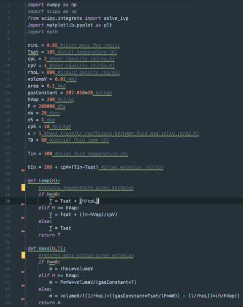

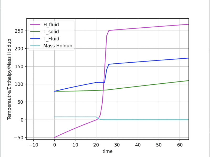

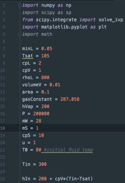

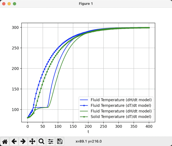

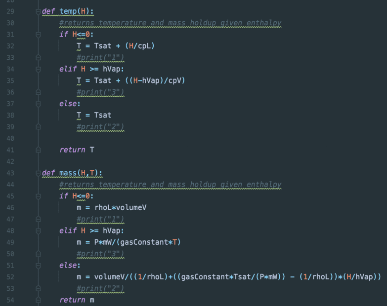

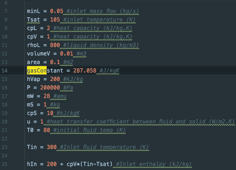

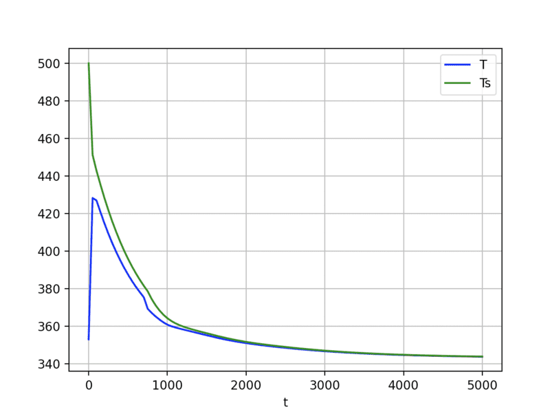

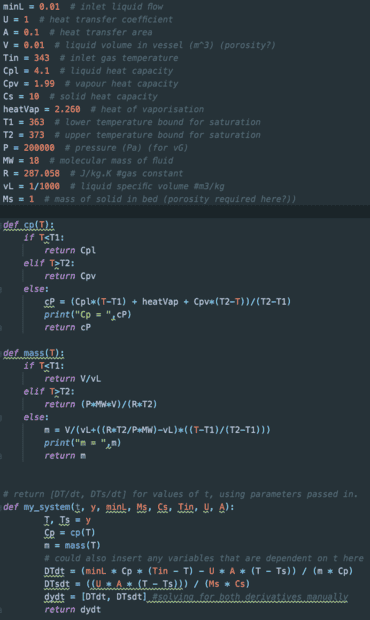

Hi Chet, phase change model code below with a graph of the fluid and solid temperatures over time. I could tweak the inputs until the graph looks nicer but in the interest of saving time I wont. Basically the code is exactly the same as the last model, except now we just take m and cp as variable rather than constant (as shown in the mass and cp functions).
So looking at the graph, initially the fluid temperature and the solid temperature jump towards one another, and then gradually both reduce to the gas inlet temperature. This happens slowly though, meaning that the mass flow in is small relative to the volume holdup. We also have the linear increase/decrease in temperature between T1 and T2 (shown by the straight line sections on the blue curve)
How does this look to you? What are your thoughts on adding in temperature variation along the direction of flow? Is this a reasonable development?

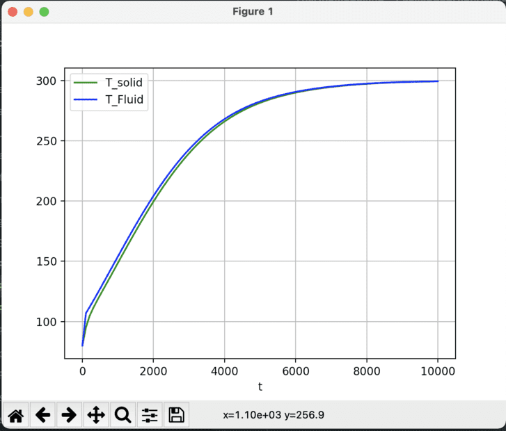

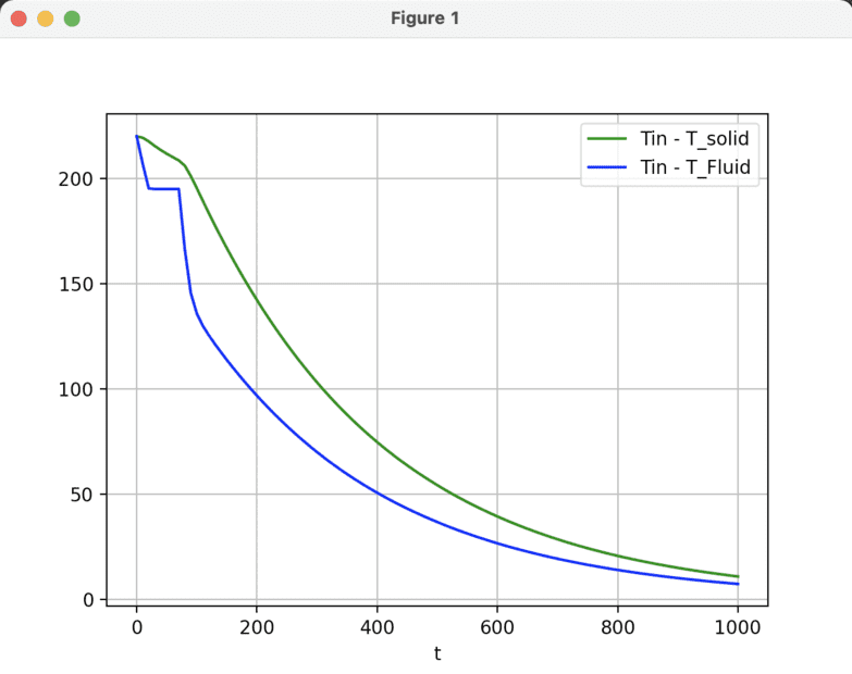

This doesn't look anything like what I expected. I was expecting to see something like the previous graph. Wasn't the initial temperature of the bed supposed to be < 80 K, and the gas temperature supposed to be about 300 K? What did you use for T1 and T2, for the inlet gas temperature, and for the bed-filled-with-liquid temperature? Also, on the graph, please show times from 0 to 1000 s only.
Reply

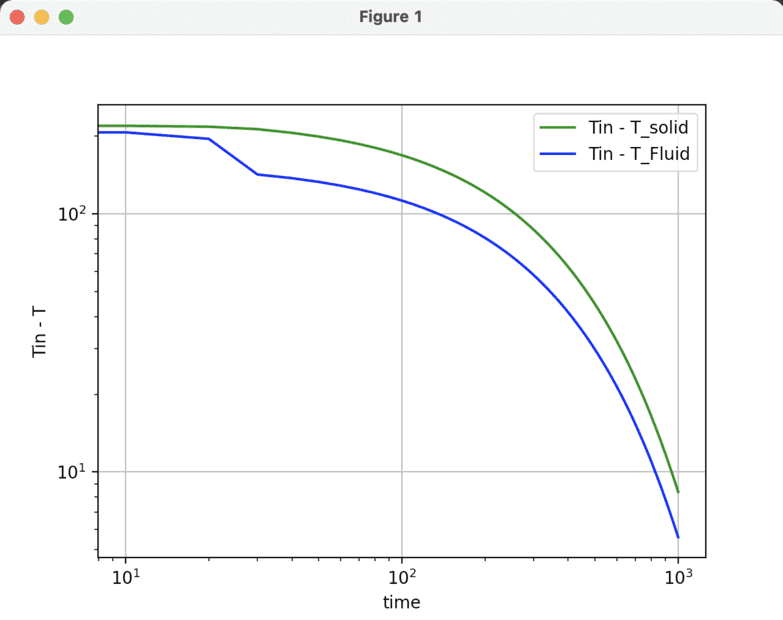

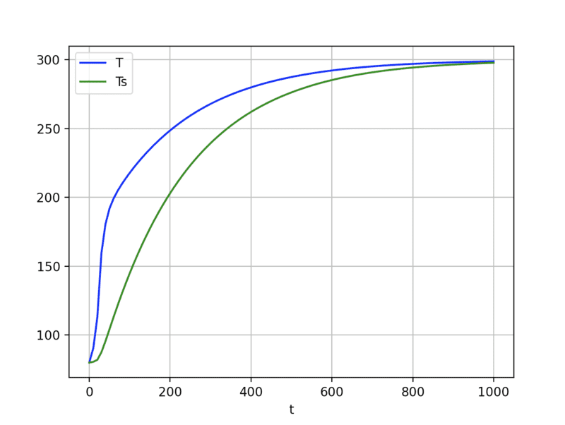

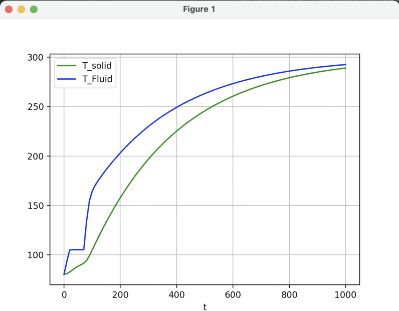

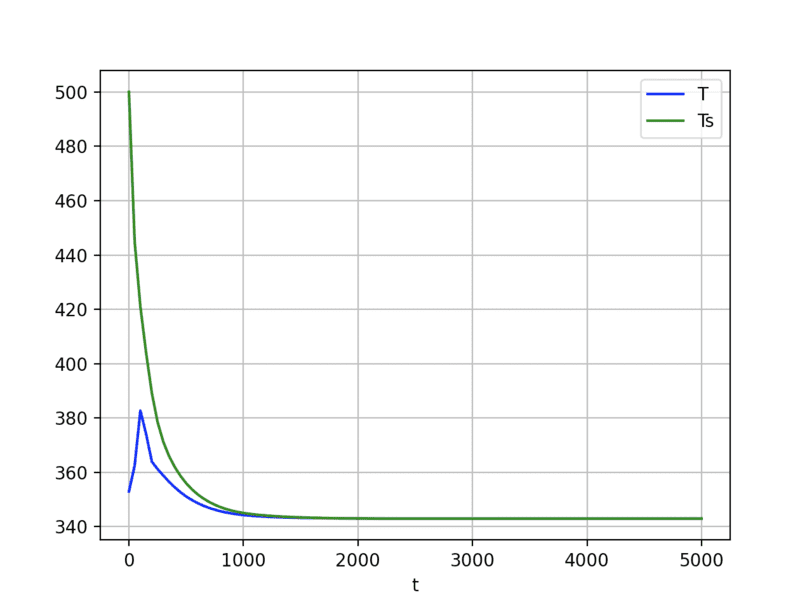

Ah my apologies, the ##80K/300K## temperatures refer to the liquefaction of air model. I just chose water/steam for the model above to test this phase change model. I've switched it now so the initial temperature of the bed and fluid in the bed are both ##80K##, and the gas entering is ##300K##. I used ##T1 = 100K## and ##T2 = 110K## to approximate a boiling range. Range adjusted to ##1000s## also. I've also switched the input values (cp, vL, etc to reflect average air properties).
My apologies for the confusion there. What are your thoughts on adding in temperature variation along the direction of flow? Is this a reasonable development?

Try modifying the stirred tank version of the numerical model by solving the fluid heat balance equation ##m\frac{dh}{dt}=\dot{m}_{in}(h_{in}-h)-UA(T(h)-T_S)## (from post #12) in terms of the enthalpy h rather than the temperate T. (The heat balance for the solid can be left in terms of T and TS). The reason I'm asking this is that I think there would be an advantage to working in terms of h in the full model because the heat capacity is discontinuous, which would lead to logistical complexities in evaluating spatial derivatives numerically; such complexities could be avoided by working in terms of h (which is continuous). If this doesn't make a lot of sense, please take me at my word. Once the enthalpy is known, the temperature follows directly (in our scheme). Please make comparison plots so we can see how the results for the temperature dependence compare. Thanks.
Chestermiller said:
Try modifying the stirred tank version of the numerical model by solving the fluid heat balance equation mdhdt=m˙in(hin−h)−UA(T(h)−TS) (from post #12) in terms of the enthalpy h rather than the temperate T. (The heat balance for the solid can be left in terms of T and TS).
Will do. Just some questions to clarify:
1) Am I to solve this for a single phase only, or for two phase flow?
2) The equation you supplied: ##m\frac{dh}{dt}=\dot{m}_{in}(h_{in}-h)-UA(T(h)-T_S)## seems to be in a useful form already. So if we are working on a single phase model then I actually only need an equation of state here I think, H(T) and T(H), and then we can solve using the ODE solver as usual
Is the above correct? i.e. your equation is in a useful form and I just need an EOS (thermodynamic property library) to solve?
Two phase.
You use the property equations for M and h that we have written for the 2 phase model. It's easiest to express T and M as functions of h over the three intervals.
Chestermiller said:
You use the property equations for M and H that we have written for the 2 phase model.
Are we assuming ##C_{PL}## and ##C_{PG}## are constant?
So the differences in terms of calculations here would be:
1) We are first calculating the inlet enthalpy using the previously developed property equations
2) The mass holdup will now be a function of enthalpy instead of temperature, meaning that we should solve for ##T_{sat}## in each of the three enthalpy property equations
3) At each time step we solve for the fluid ##H##, and then convert to ##H## to ##T## for input into the solid equation
4) Also we would need the enthalpy at ##T1## and ##T2## rather than the temperature bounds
I will start on this solution this evening however I'm not sure why this enthalpy model would output different results to the temperature model. Why would it?
I'll do the necessary equation adjusting and comment with a clear algorithm before I start coding

OK. Let's do the interval thing with this approach.
1. If ##h\leq h_{sat,L}## , then $$T=T_{sat}+(h-h_{sat,L})/C_{PL}$$ and $$m=\rho_L V$$
2. If ##h_{sat,L}\leq h \leq h_{sat,V}##, then $$T=T_{sat}$$and $$m=\frac{V}{\left[\frac{1}{\rho_L}+\left(\frac{RT_{sat}}{PM}-\frac{1}{\rho_L}\right)\left(\frac{(h-h_{sat,L})}{(h_{sat,V}-h_{sat,L})}\right)\right]}$$
3. If ##h_{sat,V}\leq h##, then $$T=T_{sat}+(h-h_{sat,V})/C_{PV}$$ and $$m=\frac{PM}{RT} V$$ with T given by the previous equation.
Hmmm...This method gets us out of the artificial approach of using T1 and T2, and is "exact" for the relations between enthalpy, temperature. and mass.
We expect that the results of this calculation will match the results from the temperature-version, so it should provide a good validation of the model. Plus, it will show the effect of the temperature remaining exactly constant with time at the saturation temperature while the fluid is converting from vapor to liquid.
Note finally, that, with no loss of generality, we can simplify further by taking the reference temperature for zero enthalpy of the liquid as ##T_{sat}##, such that ##h_{sat,L}=0## and ##h_{sat,V}=\Delta h_{vaporization}##.
