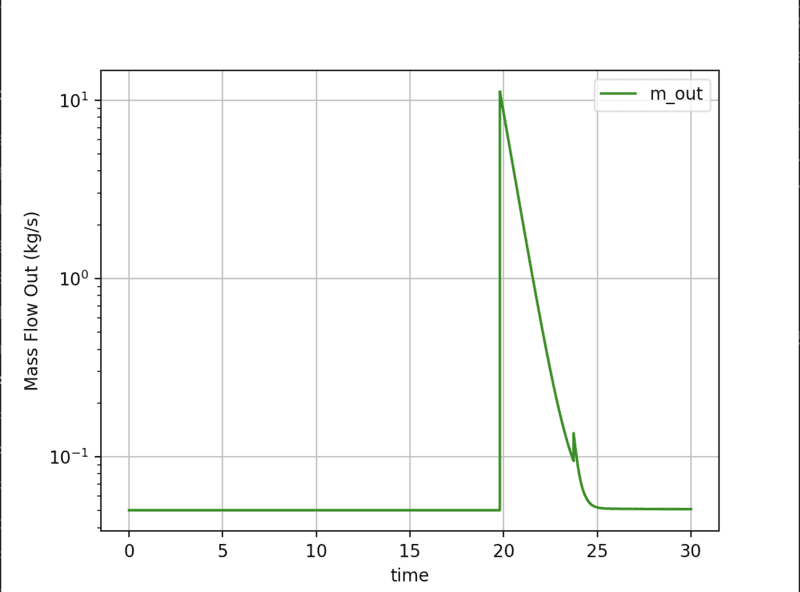

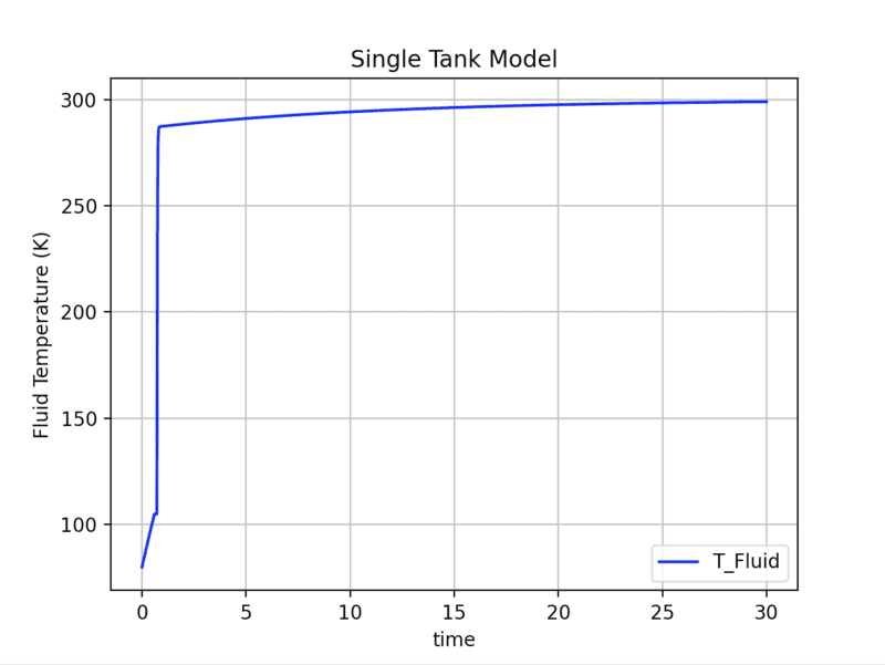

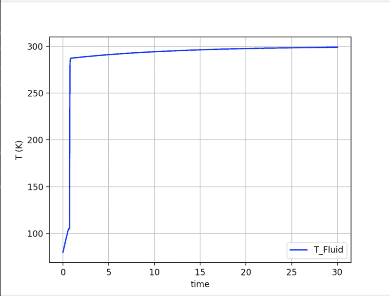

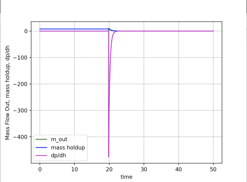

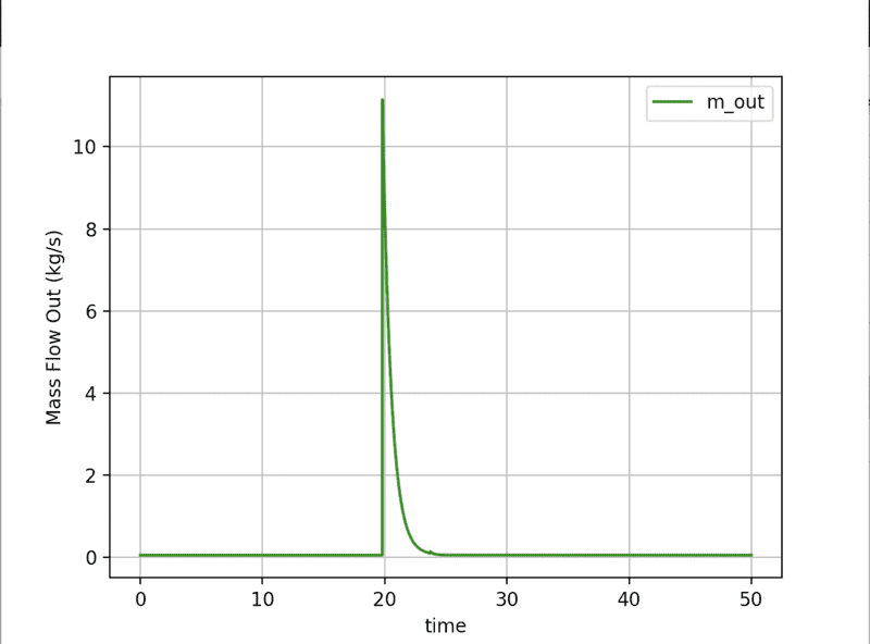

Chestermiller said:

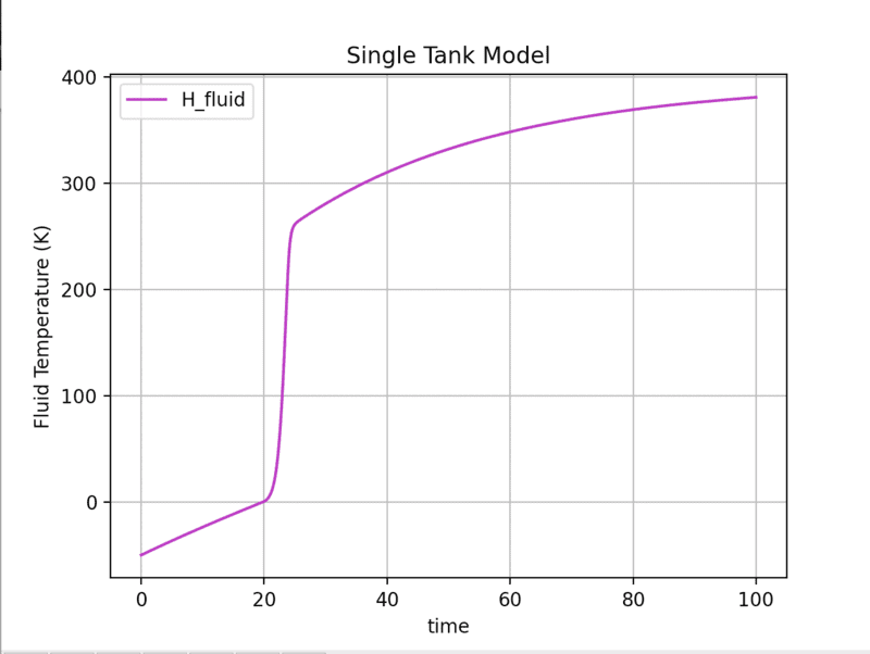

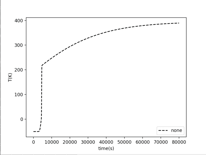

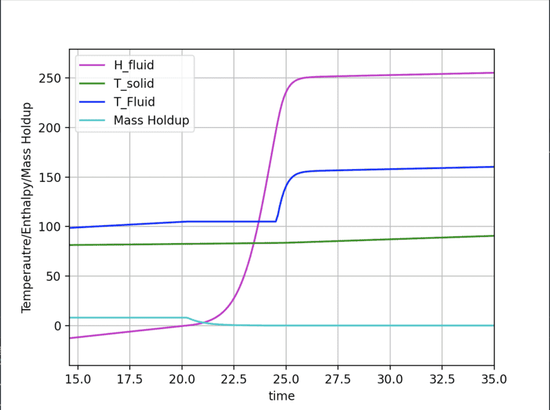

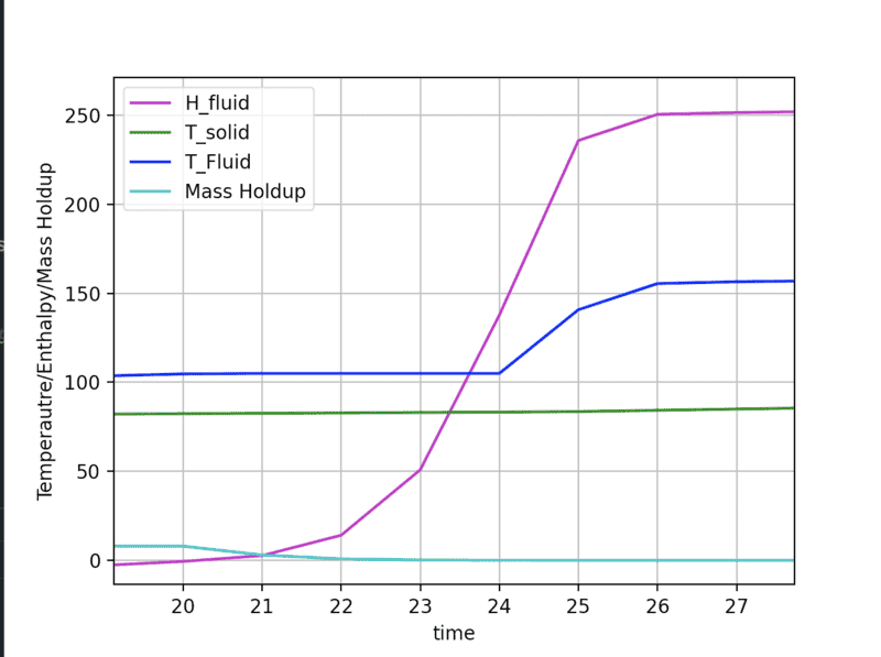

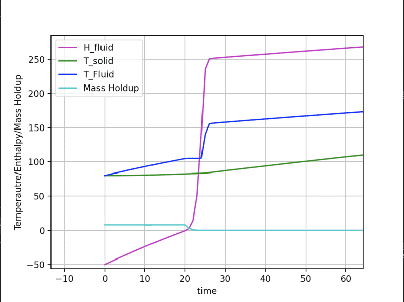

Run some diagnostic calculations where you print out things like h and m vs t to see if they are behaving the way you expect them to behave.
I ran some tests to see if this is expected behaviour, and it seems to be. These plots are of ##T_{fluid}##, ##T_{solid}##, ##H_{fluid}## and mass holdup versus time. I plotted it like this to see what other variables changed significantly around the time temperature does the weird jump:
Zoomed in version around the saturation zone:
The 'resolution' of my plot was too low. I was calculating one data point for each time value, nothing in between. So the temperature seemed to jump up randomly in this case. However when I increased the number of points (10 points between every second), the jump is really a curve and it happens exactly when the enthalpy goes above the heat of vaporisation (h>200):
This seems to answer the question about the sudden temperature jump. Looking into the time constant difference now
Very nice. Excellent
For the mass holdup, it would more instructive to examine it on a logarithmic scale.
  • #93
Understood yes the values are tiny in comparison to Temperature/Enthalpy. I'll change the scale for the mass holdup. Although it seems to do what is expected i.e. start at 8kg (V*rhoL = 0.01*800), gradually reduce across the phase change zone and then level out in the vapour zone
For the time constant, are we assuming this equation produces an accurate time constant?:
$$\tau=\frac{m_SC_{PS}}{\dot{m}C_{PV}}$$
And that the model should produce a value close to this if its correct? i.e. close to 200
I'll check the slope now with the higher resolution model

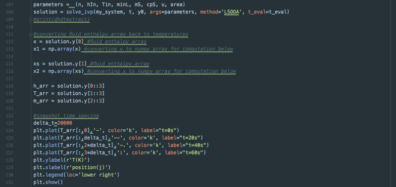

Heres the code snippet:
The questions I would have here are:
1) Where do the two equations for tau come from?
2) Is it ok that I've only calculated the slope in the vapour region? i.e. I haven't found an 'averaged' slope across all regions?
See post #71. The following is an approximation for the vapor region only, based on the approximation in post #71:
$$m_SC_{PS}\frac{dT_S}{dt}=\dot{m}C_{PV}(T_{in}-T_S)$$The solution to this equation is $$\frac{T_{in}-T_S}{T_{in}-T_{sat}}=e^{-t/\tau}$$where t is measured from the time that we have all vapor, with $$\tau=\frac{m_SC_{PS}}{\dot{m}C_{PV}}$$
In this approximation, the vapor temperature T is approximately equal to TS.
Yes. The approximation applies only to the pure vapor.

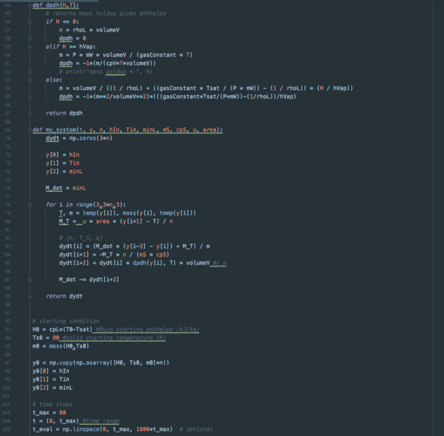

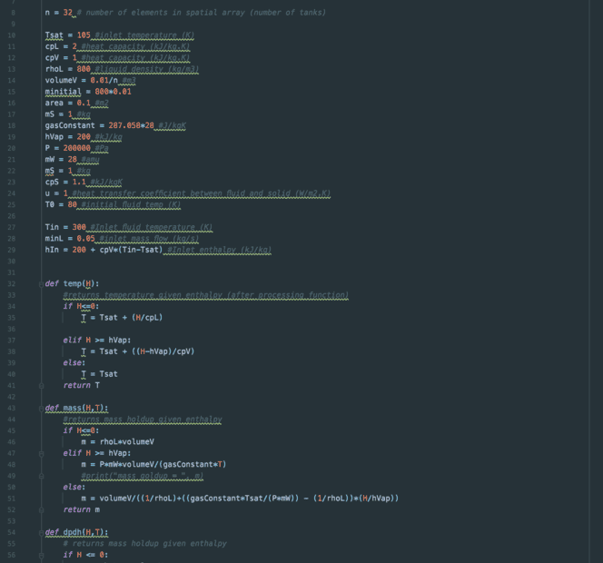

I'll clean up the code so far and split it into the various models done so far. Are there other things I should add before we spatial variation?
Actually I'm also going to map this timeline of model development into a powerpoint

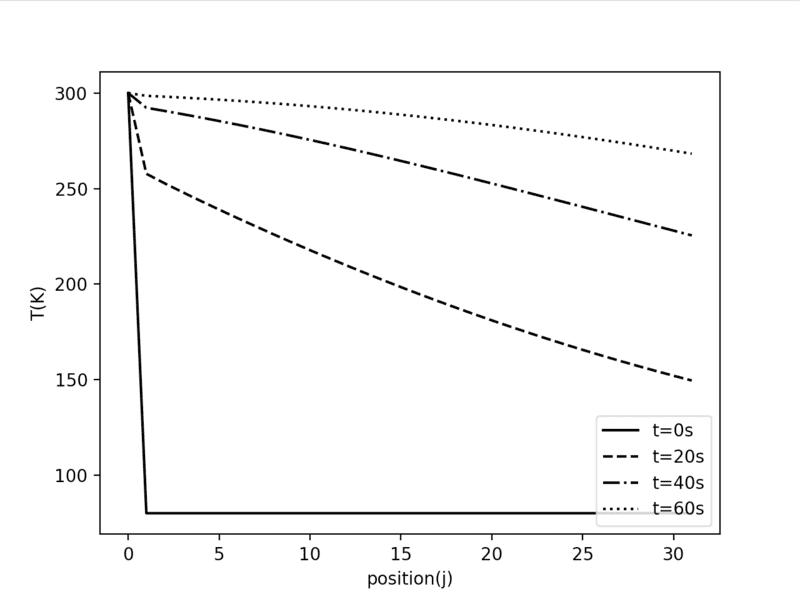

I think the next step is to move on to spatial variation. I'll write something up tomorrow.
  • #98
Looking forward to it! Again thank you Chet for walking through the modelling process with me, this is hugely appreciated.

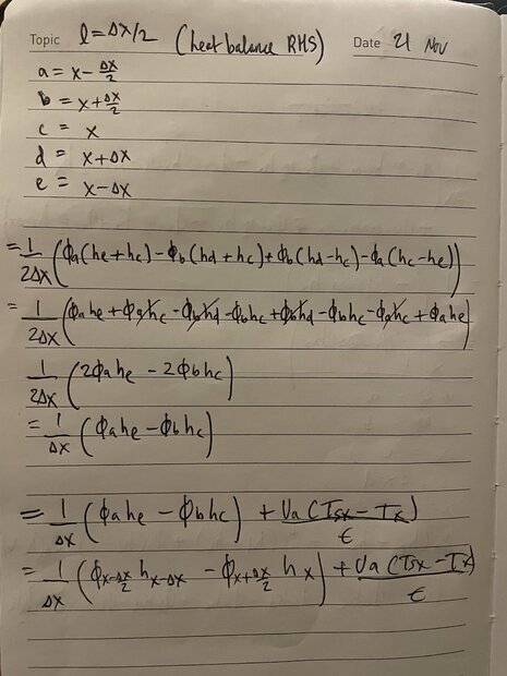

FORMULATION
Considering the fact that the fluid density is varying substantially with time and spatial position within this system, in my judgment, there is asignificant advantage to formulating and solving the heat balance equation for the fluid using the so-called divergence representation of the equation (see below); this also provides the added advantage of automatically converting mass not only in the PDE form of the equation, but also when it is expressed in finite difference form. The divergence form of the mass and energy balance for the fluid are thus written as: $$\frac{\partial \rho}{\partial t}+\frac{\partial (\rho u)}{\partial x}=0$$and$$\frac{\partial (\rho h)}{\partial t}+\frac{\partial (\rho uh)}{\partial x}=\frac{\partial}{\partial x}\left(\rho D\frac{\partial h}{\partial x}\right)+\frac{Ua}{\epsilon}(T_S-T)$$where D is the axial thermal dispersion coefficient (assumed to be much larger than the thermal diffusivity of the fluid at all typical operating conditions of the bed).
In these equations, if we substitute ##\phi=\rho u## for the axial mass flux, and express the thermal dispersion coefficient in the typical approximate form D = ul (where l is the characteristic thermal dispersion length parameter), these equations become:
$$\frac{\partial \rho}{\partial t}+\frac{\partial \phi}{\partial x}=0$$and$$\frac{\partial (\rho h)}{\partial t}+\frac{\partial (\phi h)}{\partial x}=\frac{\partial}{\partial x}\left(\phi l\frac{\partial h}{\partial x}\right)+\frac{Ua}{\epsilon}(T_S-T)$$
In lieu of any definite information on the effects of fluid density on the dispersivity parameter l, it will probably be necessary to assume that l is a constant depending only on packing geometry and to treat it as an adjustable 'tuning" parameter.
Thoughts so far?

We'll get:
##=\frac{\phi_{x-\Delta x/2}h_{x-\Delta x} -\phi_{x+\Delta x/2} h_{x}}{\Delta x}## ##+\frac{Ua(T_{S,x}-T_x)}{\epsilon}##
Working:
  • #113
casualguitar said:
We'll get:
Working:
Correct. Do you realize that this is the exact same result you would get if you used upwind differencing on the advection term and if the system did not feature any real physical dispersion? Any thoughts on how you could capitalize on this?
