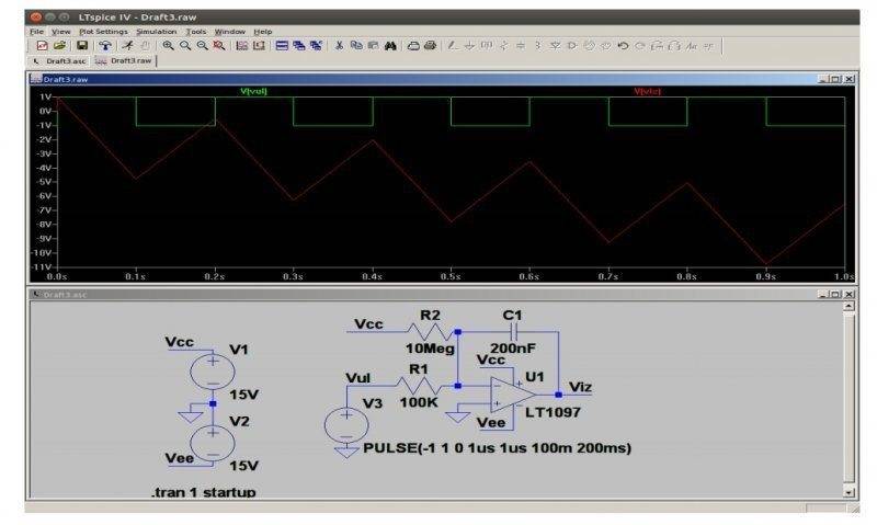

Hi!
Here is my task:
OPAMP circuit and output voltag are shown in image below. Assuming that OPAMP is ideal, come up with a solution by hand.

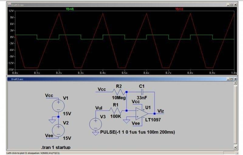

Then change capacitor's value from 200nF to 33nF and output voltage will be:
Explain why output voltages are different ( first has triangle shape and gradually decreases and second has cut off bottom and doesn't decrease).

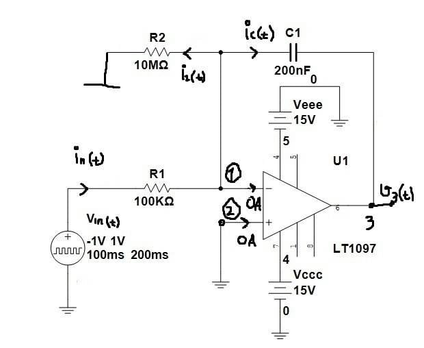

Here is what I have done:
Since there are two sources, one DC and one time dependent pulse waveform, I used superposition method. When time dependent source is active, our circuit is:
[tex]v2(t)=0\rightarrow v1(t)=0[/tex]
[tex]i2(t)=0\rightarrow iin(t)=ic(t)[/tex]
[tex]iin(t)=\frac{vin(t)}{R1}[/tex]
[tex]v3(t)+\frac{1}{C}\int ic(t)dt+R1iin(t)-vin(t)=0[/tex]
For positive input voltage [tex]vin(t)=1V[/tex] we have:
[tex]v3(t)=-\frac{1}{RC1}\int vin(t)dt=-50\int 1dt=-50t,\,\, 0\leq t\leq 100*10^{-3}s[/tex]
For negative input voltage [tex]vin(t)=-1V[/tex] we have:
[tex]v3(t)=-\frac{1}{RC1}\int vin(t)dt=-50\int (-1)dt=50t,\,\,100*10^{-3}s\leq t\leq 200*10^{-3}s[/tex]
But I don't know what to do next :(
The output should comprise a triangle wave produced by integrating the squarewave, plus a slow ramp produced by integrating a small fixed current. Does your mathematical derivation exhibit these two features?
The waveform from your simulation is what I'd expect to see.

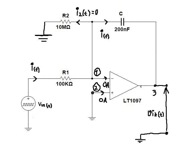

Here is how I have done it:
I found Fourier series of [tex]vin(t)[/tex], [tex]vin(t)=\sum_{n=1}^{\infty}\frac{2(1-(-1)^{n})}{n\pi }\sin{(nw0t)}[/tex]. Then I used superposition method to find [tex]viz(t)[/tex]. When [tex]vin(t)[/tex] is active, our circuit is (I didn't show OPAMP power supply):
Using KVL I got:
[tex]viz(t)+\frac{1}{C}\int i(t)+Ri(t)=vin(t)[/tex]
[tex]viz(t)+\frac{1}{C}\int\frac{vin(t)}{R1}dt+Ri(t)=vin(t)[/tex]
[tex]viz(t)+\frac{1}{R1C}\int vin(t)+R1\frac{vin(t)}{R1}=vin(t)[/tex]
[tex]viz(t)=\frac{-1}{R1C}\int (\sum_{1}^{\infty}2\frac{1-(-1)^{n}}{n\pi }\sin{(nw0t)})dt[/tex]
[tex]viz(t)=\frac{-2}{R1C}\sum_{n=1}^{\infty}\frac{1-(-1)^{n}}{n\pi }\int \sin(nw0t)dt=\frac{2}{R1C}\sum_{n=1}^{\infty}\frac{1-(-1)^{n}}{n^{2}\pi w0 }\cos{(nw0t)}[/tex]
Here is plot of viz(t)
Now it is necessary to do DC analysis and add viz(t) and Viz and (hopefully) we will get output as in simulator. I didn't do DC analysis yet.

It might be instructive if you were to extend the duration of your simulation, so you capture some "interesting output" when non-linear things start to appear.
Before you dive into complicated maths you should look back at what you are specifically asked to explain, in post #1. I interpret it to be they want you to demonstrate a practical understanding of that circuit's behaviour under the two different conditions.
Likes etf
When using the 33nF capacitor, could you also please record the waveform at the junction of R1 and R2. It might contain some answers ...

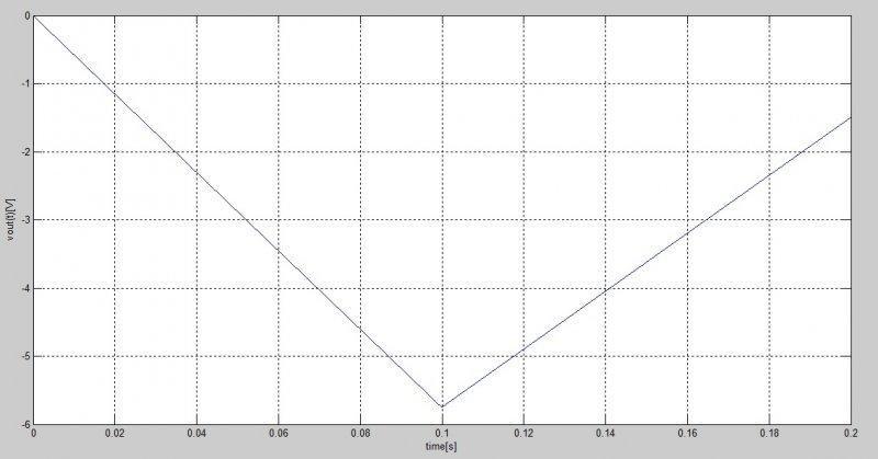

I think I solved it (without Fourier series :) )
Firstly I analysed circuit for t between 0 and 0.1s (VCC=15V, vin(t)=1V). I got vout(t)=-57.5t. Then I analysed circuit for t between 0.1s and 0.2s (VCC=15V, vin(t)=-1V). I got vout(t)=42.5t. On time interval between 0s and 0.2s our output voltage vout(t) is
What do you think? I didn't plot it on some wider interval since it's a little bit tricky to connect those lines and plot :)
Here is code I used for plot:
>> t1=linspace(0,0.1,100000);
>> t2=linspace(0.1,0.2,100000);
>> vout1=-57.5.*t1;
>> vout2=-5.75+42.5.*(t2-0.1);
>> plot(t1,vout1,t2,vout2)
>> grid
It is necessary to plot decreasing line, then on it's end increasing one etc. :)
That looks good, providing it agrees with your actual circuit. You don't need to do anymore computations in order to be able to sketch a dozen or more cycles, because each will drop by 5.75V and then rise by 4.25V --- so you can fill in the rest of the waveform by hand.
