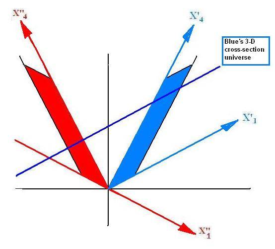

In an earlier thread, I asserted that a rod has one true length, its rest length. If so, then the shorter coordinate length which is measured in some other frame must be somehow untrue. In this thread I argue that the coordinate length is a distorted view of the true length.
In the graphic below (fig. 1), there are two rods, each with a rest length of four units. The horizontal rod is at rest in frame S; the other rod is at rest in frame M. Frame M is moving at 0.6c relative to frame S. In this discussion, the focus will be on the rod in frame M [red], and its coordinate length in frame S [purple].
http://www.how-do-i-know-its-true.net/media/wpmu/uploads/blogs.dir/1/files/2011/02/RodMovementNumbered.png
[1] The rod which is at rest in frame M will always be parallel to the XM axis, no matter at what time the rod is drawn. Thus each instance of the rod in the graphic is parallel to the XM axis.
[2] The view of the rod from frame S (its coordinate length) is horizontal. Therefore, the view is not one view, but a composite of many views. The coordinate length is composed of many snapshots, each snapshot showing a specific point on the rod at a specific time in frame M. In the graphic, four instances of the rod are marked as they cross time TS = 6.68. The four marked points of the rod are at times TM = 5.35, 6.01, 6.67, and 7.33, respectively. The fifth mark, at TM = 7.75, is where the trailing end of the rod crosses TS = 6.68; no instance of the rod is drawn at that point.
[3] As one moves along the view of the rod in frame S, from leading end to trailing end, the time in frame M increases. This means that, in the view as seen from frame S, the trailing end of the rod has traveled farther than the leading end of the rod. This explains, qualitatively, the contracted coordinate length in frame S.
[4] When the velocity is reversed, the effect is the same, as shown in this graphic (fig. 2):
http://www.how-do-i-know-its-true.net/media/wpmu/uploads/blogs.dir/1/files/2011/02/RodMovementReverse.png
[5] The time differential from the leading end to the trailing end is equal to the relative velocity of the two frames multiplied by the rest length of the rod. In this example, (7.75 - 5.35) = 2.4 = 0.6 * 4, where T = ct and V = v/c. This can be better seen in figure 3:
http://www.how-do-i-know-its-true.net/media/wpmu/uploads/blogs.dir/1/files/2011/02/LengthContraction.png
Thus, the apparent contraction of the rod is directly related to the relative velocity of the frames. Taylor and Wheeler show that the contracted length can be developed by integrating from relative velocity 0 to V. (See exercise L-14 in Spacetime Physics.) Their interpretation is that the trailing end of the rod, as seen in frame S, begins to move before the leading end, thus contracting the rod in frame S. (The same is true for each differential segment of the rod. The differential time at each segment is smaller than at the trailing end, thus leading to a contraction proportional to the length.)
The interpretation proposed here is that the integration describes the compressive shifting of the individual snapshots in frame S. The coordinate length of the rod in frame S is thus a distorted view of the rod, while the rod itself is completely unaffected. The rest length of the rod is therefore its one true length.
Of course, the measured coordinate length is the same regardless of the interpretation of the result.
In relativity the length of an object doesn't change due to an outside observer traveling at relativistic speeds as it is anyways. For example, a ship traveling 0.6c relative to Earth couldn't make us earthlings observe ourselves to be distorted in the ships direction of motion. I don't think it actually proves that there is no length contraction, but the contraction is only observed differently by different observers.
I think it is key to remember that the length contraction is used to only maintain the constant speed of light. In time dialation, the amount of time you observe another object to expereince has to be a value that makes you see them measure the speed of light to be the same as you do. If they expereince the dilation themselves this wouldn't happen because they measure light to still travel the same 300,000 km/s or so faster than them. So then two observers couldn't see themselves as their measuring rods as being a different length because the measured speed of light is always the same speed faster for both of the two, otherwise the theory would be useless because they would measure different speeds of light with their distorted measureing rods.

Hi GregAshmore, none of what you presented here is new, surprising, or unusual. It does not change the way that the term "length" is defined nor does it make anything about that definition invalid.
You are certainly free to adopt the arbitrary personal definition that the term "true length" means the same as the common term "proper length". In fact, you don't need any of the above justification to do so, you can simply assert "I am defining the term 'true length' to mean the proper length". However, since a common term already exists for the concept why not use it? All you are going to accomplish with this approach is to make communication barriers and encourage confusion.

I'm saying that when two rods are in relative motion, Greg needs to understand that they cannot both be at rest at the same time, and so it is not a true statement that their "true lengths" are the same as their "rest lengths".

Although you are free to introduce new terms and their definitions you are not free to un-define already defined terms.

GregAshmore, please listen to what DaleSpam is trying to tell you. You're not accomplishing anything meaningful here.

GregAshmore, I really think JesseM is right about this. Look at a symmetric spacetime diagram of your rod. Except, this time I've imagined a red rod and a blue rod were prepared at rest in the same system, then each rod is made to move at the same speed in opposite directions relative to the rest black coordinate system in the sketch. I've made the sketch symmetric so that the red and blue sketched line lengths correspond to the same distance, and the time coordinates are scaled the same as well.
You could have put in some hyperbolic calibration curves (for both distance and time) with your sketch. Then proper distances and proper times would have been obvious.
Now, who's 3-D cross-section of the universe has cut out the 3-D rod with the "True" length?" Which 3-D rod has the Proper length?
