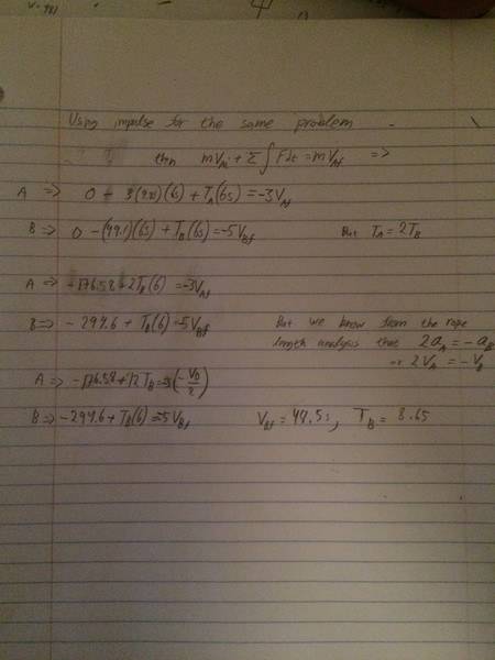

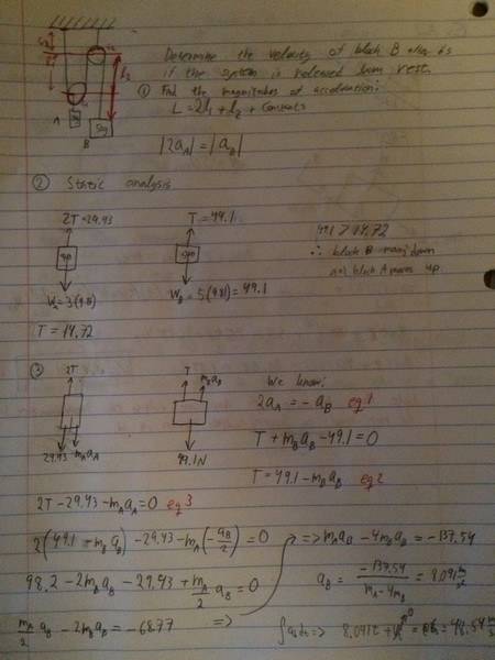

Find the velocity of block B (the one to the right) A has a mass of 3kg and B a mass of 5kg. Pulleys and rope are ideal.
F=ma
I used two different methods, got the same WRONG answer. The correct answer is Vb= -35.8m/s
Let me know if you can't see what the pictures say
How is it consistent for T=49.1 N but 2T=29.43 N if it's the same rope? Tension doesn't vary across an ideal rope, because the rope is massless.
You can't say the tensions are equal to the weights. The objects will accelerate; but if the tension equals the weight, how would the objects accelerate?
I would leave the tension unknown and eliminate it, no reason to solve for it.
I used this method:
Ah, I didn't see that you wrote "static analysis" above that part.
In either eq 2 or eq 3, you have an extra factor of -1 on the acceleration term.
Edit:
Actually, it could be fixed by slightly altering any of your 3 equations; they just need to be consistent.
You said, -ab = 2aa which implies that you're letting ab and aa represent the magnitudes and direction (one of them is negative) of acceleration; but then you have an extra factor of -1 on a3 in eq.3, which implies that you're taking aa and ab to be just the magnitude
