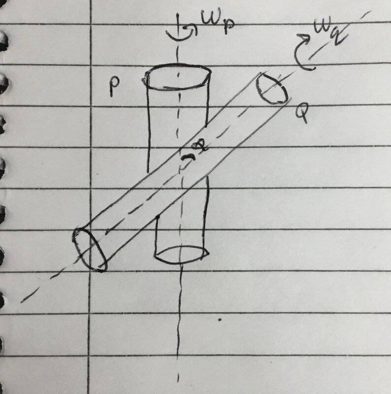

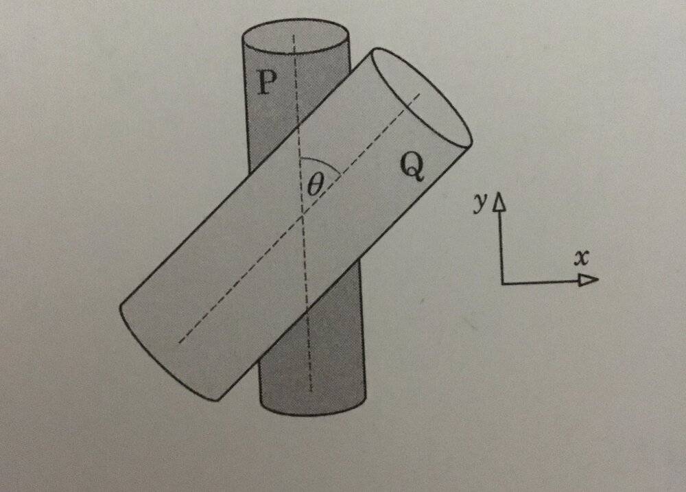

A cylinder P of radius r[SUB]p[/SUB] is being rotated at a constant angular velocity ω[SUB]p[/SUB] with the help of a motor about its axis that is fixed. Another cylinder Q of radius r[SUB]q[/SUB] Free to rotate about its axis that is also fixed is touched with and pressed on P making angle θ between their axes. Soon after the cylinders are pressed against each other, a steady state is reached and cylinder Q acquires a constant angular velocity. Find the final angular velocity of Q and comment on frictional force.
v= ωr
A single pair of points will be in contact between P and Q. The frictional force will try to make the velocity of these points equal.
Say the final angular velocity of Q is ωq.
The velocity of points in contact can never be equal because of difference in directions of ωq and ωp. If I break ωqrq into horizontal and vertical components though, then I can write that its horizontal component must be equal to ωprp.
Thus
ωqrqcosθ=ωprp
And so we get ωq to be:
ωq=[tex]-ω_pr_p/r_qcosθ(sinθi+cosθj)[/tex]​
[tex] Which is wrong. The correct answer is:<br /> <div style="text-align: center">ω<sub>q</sub>=-ω<sub>p</sub>r<sub>p</sub>cosθ/r<sub>q</sub>(sinθi+cosθj)​</div><br /> It seems that I was supposed to break ω<sub>p</sub>r<sub>p</sub> into components instead. But I don't see why I should've done that.[/tex]

As an extreme case of two cylinders are parallel position touching in line so ##\theta=0##,
[tex]v=\omega_p r_p=\omega_q r_q[/tex]
Another extreme case of perpendicular position, ##\theta=\pi/2##,
[tex]\omega_q=0[/tex]
In between
[tex]\omega_p r_p\ \cos\theta=\omega_q r_q[/tex]
We get ##\omega_q## and to make it a vector
[tex]- cos\theta\ \ \mathbf{i} - sin\theta\ \ \mathbf{j}[/tex]
should be multiplied.

Your post is very helpful. Can you please comment if my thought process is right?
[tex]ω_p[/tex] is responsible for making Q rotate. And so we take component of [tex]ω_pr_p[/tex] and equate it to [tex]ω_qr_q[/tex]
This is analogous to the scenario where force is applied on a box which is restricted to move along a straight line. If the force applied is inclined to the straight line, then only the component of the force along it will be responsible for the box's movement. Just like [tex]ω_pr_pcosθ[/tex] is responsible for [tex]ω_qr_q[/tex]
Though not force but velocity, it seems OK.
Rotation of P with tangential speed ##\omega_p r_p## would transmit
tangential speed of Q : ##\omega_p r_p \cos\theta##
longitudinal speed of Q : ##\omega_p r_p \sin\theta##
So if friction allows motion of the both direction, Q rotates around and proceed along the axis.
The latter is prohibited by some mechanical arrangement and the only former survives.
