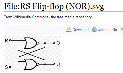

In the RS flip flops using a NOR gate if we replace the NOR by an OR gate all the outputs will be indeterminate. Both outputs Q and Q' will every time yield 1. Can you explain how the inputs 0 and 0 will give 1 1 as output
Try this,
Start with Set and Reset both being 1, and determine the outputs Q and Q-bar.
Then change either input ( or both ) to 0, and determine the outputs.
Start with Set and reset both being 0, and determine the outputs.
Change either input to a 1 ( or both ), and determine the outputs.
Repeat at your leisure.
Adding a diagram to help the OP:
https://commons.wikimedia.org/wiki/File:RS_Flip-flop_(NOR).svg
