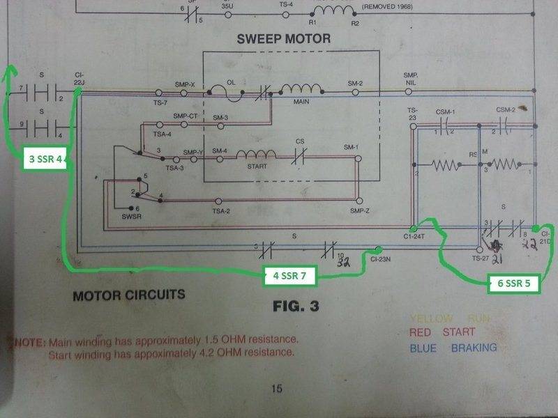

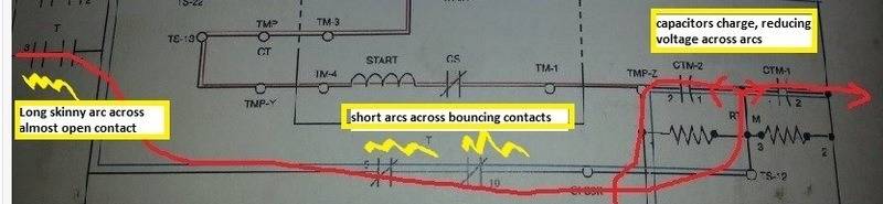

guys some speculation here, followed by a question...
i've been obsessed by the thought the contacts are being eroded by current from the motor
and have tried to operate the braking sequence millisecond by millisecond in my head..
loooking for a relay race between the NO contacts opening and the NC contacts closing
it is necessary for the NO's in upper left to clear before the NC's below close , else we have a near dead short across the supply as shown in post #43
what if... entertain this thought experiment for a moment ... HO12 answered this long ago when he said
H012 said:
The only fact I know is that the NC arcing occurs when they open, only because I can see it.
when what opens ? The NC's or the NO's ? We established by test that there's no current through the NC's when they open by measuring voltage at junction of the two capacitors if i understood. It drops to zero after motor starts and remains so until braking.
So if the arcing is observed at braking time when the NO's in upper left open, that's not surprising because they are interrupting motor current and it's an induction motor.
Anybody who's arc-welded knows an arc can persist surprisingly long
so in the thought experiment, think millisecond by millisecont from the instant the S relay plunger starts to travel to de-enegrgized position
1. NO contact opens a ten-thousandth of an inch establishing an arc
2. NO contact continues its travel, arc gets longer
3. NC contact makes initial contact , connecting motor to capacitors which are nearly a dead short
4. Current through NC contact consists of current from motor plus any leftovers from the arc - at this instant NC does not yet have full contact pressure so some melting might occur
5. NC that's NO contact continues widening its airgap, quenching the arc (sorry for the mistake :mad::mad:):frown:
6. NC contact establishes full contact pressure and commences to cool whatever metal was melted in 4.
Now here's the speculation
Which comes first ? 4 or 5 ? If NC makes before NO has extinguished its arc, we have a short across supply through a not quite extinguished arc and a not well seated NC contact that's still bouncing... see post #87
Is that scenario plausible?
so the relay race i was looking for isn't contact vs contact mechanical travel overlap but contact travel vs arc quenching time overlap.
How does energy deposition between two arcs in series divide?
Is this plausible, guys?
If so, a snubber across motor as in post #89 might help NC NO quench the arc before NC makes.('nother durn mistake :mad:)

H012 said:
I am positive the reason the SSR fail so soon on these machine is the repetitive cycling of the machines when we are busy average is about 15 seconds and the lack of adequate heat sinking on the MOSFETs is the problem.
If the SSR is SCR based and can't turn off the NO contact until a current zero crossing happens,
then there's an interval where it connects 1000 uf right across the line which could be a bodacious surge.
Looking for holes in that line of thinking
and any thoughts on how to test for it.

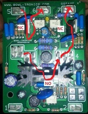

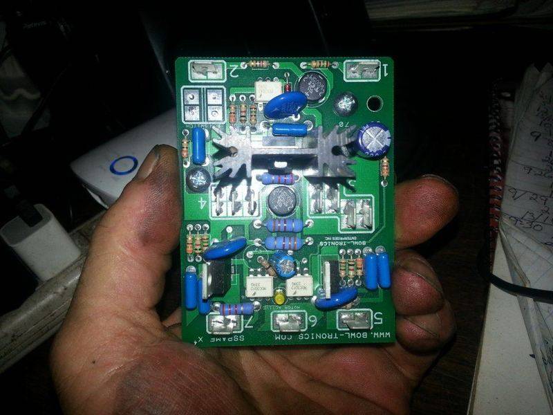

Here is a pic. of a SS relay (bad)
oops step 5 above should say "NO contact continues widening.." instead of NC.. believe me it's frustrating to be so awkward...
will fix now
then look at ss relay picture thanks !

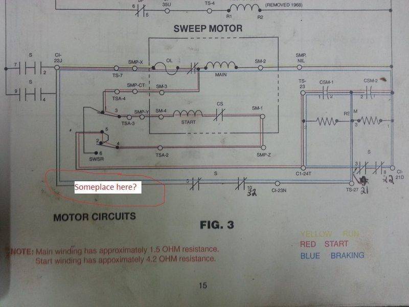

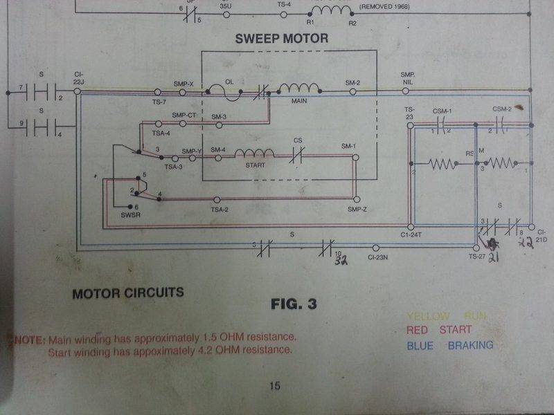

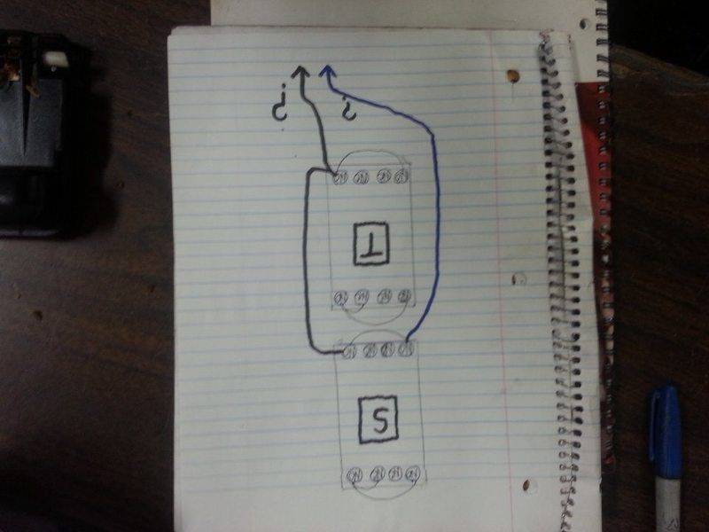

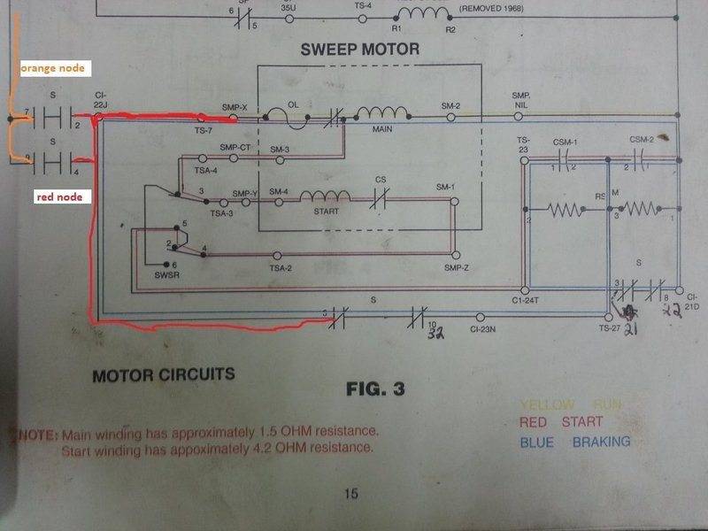

Jim I found this doesn't match schematic.Iook at pic. I tried to upload pic site won't let me Do you have Gmail?
I got it to upload. Jim the black and blue wire are both coming from same hot at all times terminal strip in wire duct? Am I dumb!

still trying to figure out that SSR
Mosfets. Hmmm
the little white MOC3012's are optocouplers ,
http://www.ti.com/lit/ds/symlink/moc3009.pdf
probably they make gate drive for whatever are those big power semiconductors ?
Do those have a part number ?
I'm a little behind you HO12...
Mosfets. Hmmm
check your "Inbox" button at top...
I will look at PN# at home can't see it without magnification. Thanks
gotcha. Can you tell any difference in arcing ?
not at all, just learning the details of your machine.

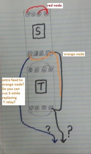

Jim I don't check them. Same as always sweep doesn't work when bowler bowls. The sweep really is tough on relays. Thing is it's not heavy. Just has to run 3 times for every one time of the table.like tonight these machines have been running more or less since 9 am
ref Post #132

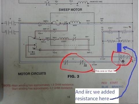

H012 said:
I don't think so because wouldn't run anyway. I went just for the heck of it and took out the black wire. As I thought runs and breaks fine.[/color] I did this on a different machine. Not the one with the resistor as someone is bowling on it. The arcing is still there but it's not blueish white it's white. I have a chassis I'm finishing up with new relays. Going to put resistor on that machine
I put the new relays in.
I lost track of something here. If the removed Black wire refers to the sketch showing Black and Blue duplicate feed to the S and T relays, that shouldn't make any difference if the schematic matches the real world.[/color]
HEY GUYS, THAT REDUCED THE ARC TEMPERATURE BY 1000 TO 2000 DEGREES C. On the right track!

Tom.G said:
ref Post #132I lost track of something here. If the removed Black wire refers to the sketch showing Black and Blue duplicate feed to the S and T relays, that shouldn't make any difference if the schematic matches the real world.
ref post #129
@jim hardy
TRIACs.
Exactly my thoughts. That's why I took it out.
Because it didn't match. When I leave here I want whomever not to have guess. To what it's supposed to be.
At least we agree that as a wire just in parallel with another wire, it shouldn't make any difference. Sounds like it wasn't just in parallel. Tracking down where things are really connected may find other anomalies or the root cause of the relay arcing problem.
Unfortunately in the real world, we sometimes have to go with what works and move on.

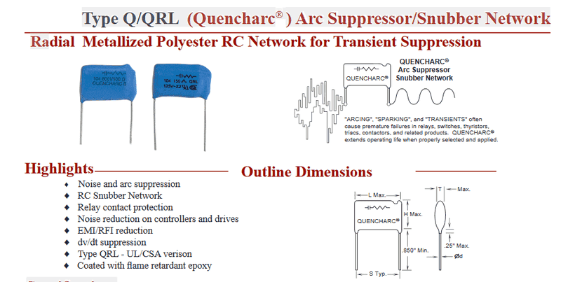

Did the arc get less intense? White and small vs blue and big? Resistor ought to do that.
I never did get it real clear whether you can see arc on NC's or NO's or both...
If you have that motor run capacitor, tack it across motor main winding and see if arc changes. Dont leave it there without some resistance in series,
but if it makes arc smaller take a look at this product
http://www.digikey.com/product-sear...t=0&page=1&quantity=0&ptm=0&fid=0&pageSize=25
http://www.cde.com/resources/catalogs/Q-QRL.pdf

As I stated the arcing at NC was a blueish white now it,s just white as far as intense
I can't really tell the arc happens so fast. There is a few relays that the NO do arc but these relays have some age one them. Jim I had looked into the QuechArc but the formulas are over my head. I,m still going to get the run cap and try it. Thanks I will let you know.
Ahhh it's at the NC - Thanks !
Since we don't have a peak capture ammeter or o'scope your observed intensity is our measure. Those Quencharc equations do look scary
Had you needed instead to protect the NO contacts from arcing when they open, the approach i use is this simpler one
...objective is to give the load current a path into a capacitor ( instead of through the contacts) for those first few microseconds while the contacts separate those first few thousandths of an inch
that way the inductive kick charges the capacitor instead raising the voltage enough to strike an arc
just like points in a car ignition are protected by the condenser
the car ignition uses around 0.22 uf for coil current of maybe two amps, ~ 0.1 uf per amp
what rate of voltage rise does that give ?
i = c X ΔV/ΔT
2 = .22 X10-6 X ΔV/ΔT
ΔV/ΔT = 2/.22 X10-6 = around 9 volts per microsecond
.1uf per amp would be 10 volts per microsecond
and that seems to protect the contacts in automobile points, which cycle a few hundred times per second
your six amp motor by that criteria, 0.1uf per amp, would get about 0.6 uf
so i just picked a Quencharc with a little more capacitance than that
and lowest resistance they offer
because the voltage across that resistor appears across the contacts and 6 amps X 22 ohms is 132 volts at instant of contact opening,
a lot less than the full inductive kick would make.
Hope that helps in your next relay adventure ...
old jim
Since we don't have a peak capture ammeter or o'scope your observed intensity is our measure.Those Quencharc equations do look scary
i = c X ΔV/ΔT
old jim

found an old Quencharc datasheet that includes the "how to" attachment i remember reading years ago
http://www.panconcorp.com/PDFs/capacitors/QRL-Quencharc.pdf

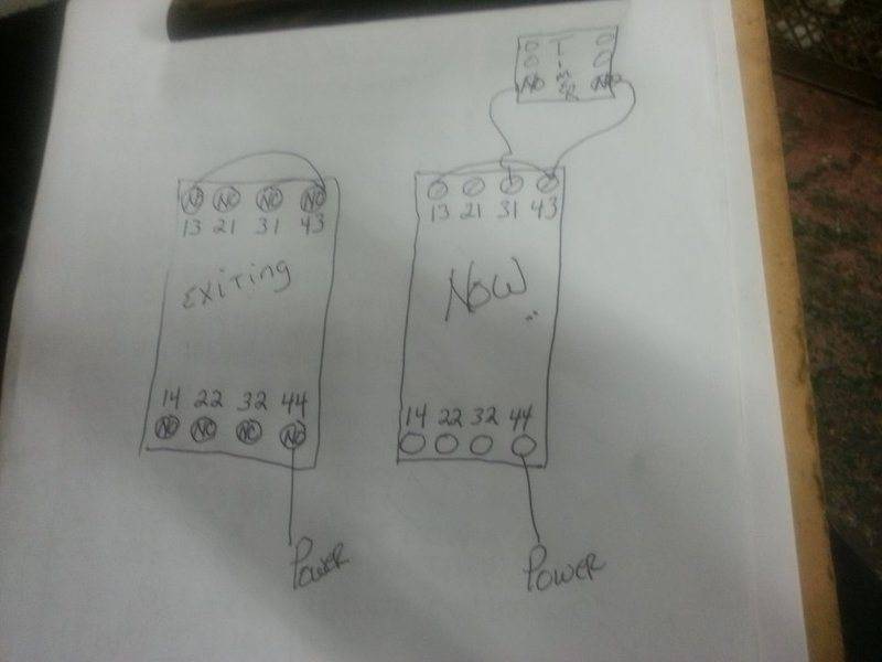

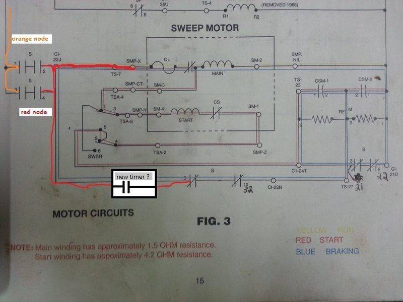

Thanks Tom. Well today before I saw this post I put a chassis in the lane Jim had me put the resistor in with 2 new Table and Sweep relays The NO contacts are still arcing. I wanted to eliminate the old relays. As the contacts being the cause.
Okaayy... We seem to be switching back and forth on whether it's the NO or NC contacts that are arcing. I suspect they are both arcing under different conditions/faults on different machines, but so far it is very confusing. Getting this settled is important because appropriate fixes depend on the timing and specific conditions that the arcs occur. It would be extremely useful if you could post a video of a Sweep relay for a whole sweep cycle showing arcing. Ideally using one of the old style open frame relays so we can see the contact movements and where the arcing occurs, and infer where in the operating cycle it all happens.
