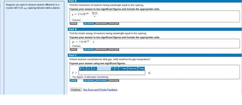

pat666
703
see attached
\lambdamaxT=2.898*10^-3
\lambdamedT=4.107*10^-3
I have tried both the above equations (12834375K and 9056250K) both are wrong..
not sure where to go?
thanks for any help
