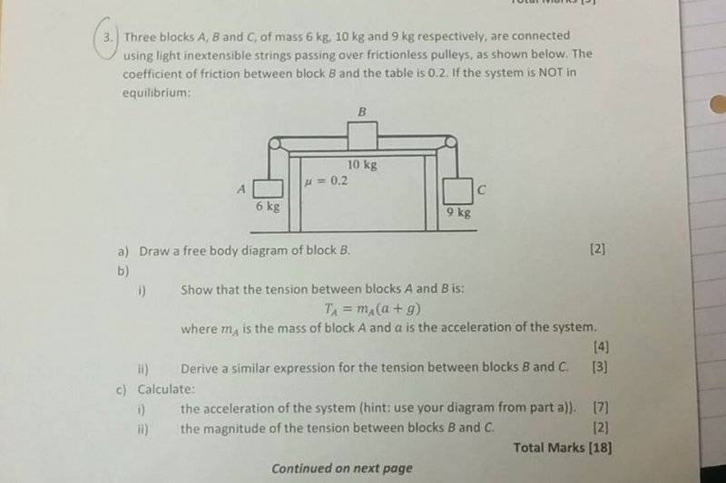

... this does not follow from b(i). Please show your reasoning.bii) Tc=mc(a+g)
... did you read the hint?Have no idea what to do though really...
Simon Bridge said:... this does not follow from b(i). Please show your reasoning.
But you should complete b before starting c.
