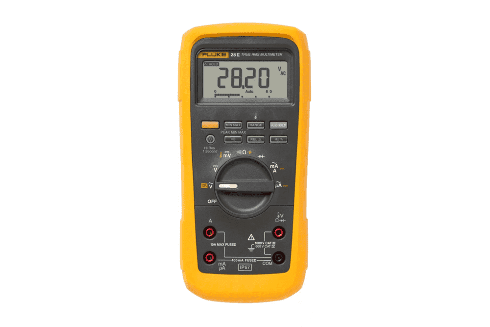

On my Fluke DMM, I can lock it into the lowest DC voltage range, and it has a handy bargraph at the botttom of the display to help see quick changes in the DC voltage. Does your DMM have a similar feature?
https://dam-assets.fluke.com/s3fs-public/fluke-28ii.jpg
