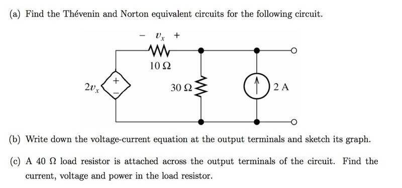

Voltage-current equation of Thevenin circuit
  • Thread starter Thread starter ali297
    Circuit Thevenin
The discussion focuses on understanding the voltage-current equation in the context of a Thevenin circuit. The Thevenin resistance is confirmed at 15 ohms, with an open circuit voltage of 30 V and a short circuit current of 2 A. There is confusion regarding whether the "voltage-current equation" refers to Ohm's Law. Participants suggest expressing the relationship between output voltage and output current, potentially by introducing a voltage source to measure the resulting current. Clarifying this equation is crucial for solving the homework problem effectively.
ali297
I need help with part (b).
The Thevenin resistance is 15 ohms, voltage open circuit 30 V and the short current circuit is 2 A. You can take these for granted, I've confirmed with a friend.
I really don't know what they mean by "voltage-current equation", are they talking about Ohms law?
Write an expression that relates the output voltage to the output current (or current vs voltage).
Consider sticking a voltage source on the output and "measuring" the resulting current.
