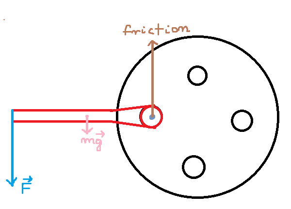

Let's say we want to change a wheel in a car. We want to remove bolts fastening the wheel using this tool:
I have also drawn a diagram of the forces in operation:
Now, from experience I can say that the point of rotation of the wrench will be the blue point. Now, trying to determine the torque relative to that point leaves us with a net torque anticlockwise (friction gets canceled out).
Yet, we know that removing these bolts requires some effort. Therefore, there either are more forces in action or the axis of rotation I chose is incorrect (or both)
What am I missing?

ChessEnthusiast said:
Why is friction acting at the center of the bolt?
What am I missing?
There is a frictional torque as well as a frictional force.

I see. So, to recap:
There are three forces acting on the wrench:
  • gravity
  • the force we apply
  • the force the bolt applies
The last force does not contribute to the net torque. There are three factors contributing to it:
  • gravity
  • the friction torque
Is it correct so far?
1. Friction occurs at the threads of the nut/bolt, and on the mating face of the lug nut (not at the center of the bolt)
2. There is a 'normal' force perpendicular to the plane in your picture - it is the result of 'stretching' the stud and deforming the wheel/hub.
russ_watters said:
No, there's no frictional force; friction applies the torque. The linear force shown on the diagram is applied by the bolt.
Good catch! Yes, you are right. That is a normal force from the bolt, not a frictional force from the nut.

What you are missing is the concept of couple (which results in a torque). First, the force you call 'friction' is mislabeled. You should call it 'reaction force'. When you apply the force at the end of the lever (in addition to the force due gravity), you have a reaction force from the stud itself that is equal and opposite to the sum of those forces. You can see that by noticing that the tire will squeeze a little bit more because you are pushing down on it (If you were pulling the lever up, you might even lift up the wheel off the ground).
Because the forces are misaligned, they constitute a couple, which creates a torque (in this case, anticlockwise). You seem to think that because the forces are equal and opposite, they "absorb" each other and thus cannot contribute to the torque. That is not the case. In static (i.e. no motion), forces must be opposed by other forces and they all contribute to torque. If the sum of the torques they create is zero, then there is no resultant torque.
In the case you presented, you should add a clockwise torque on your diagram. This torque comes from the friction between the thread of the stud & nut and it will be equal and opposite to the torque created by the couples coming from the applied forces (your hand & part of the reaction force, and the force due to gravity & the rest of the reaction force).
