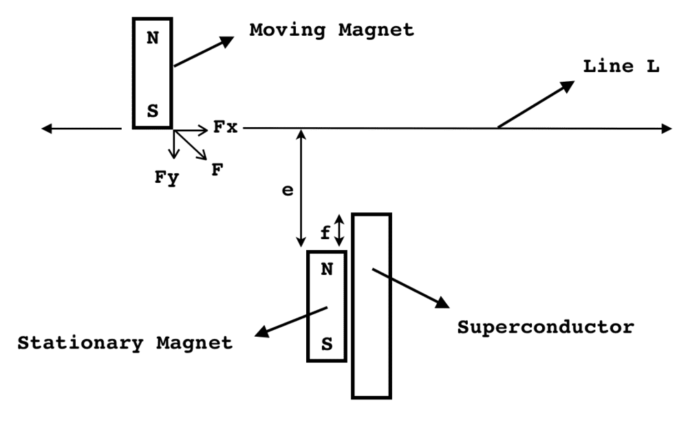

Consider the following setup:
Stationary magnet and Superconductor are fixed and Moving magnet is allowed to move freely in the horizontal direction.
Assume the superconductor as Type I superconductor.

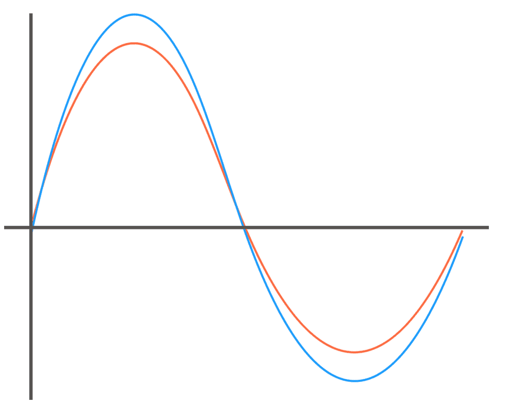

Following figure shows the Horizontal Force acting on Moving Magnet vs Distance curve:
Red is when Superconductor is at temperature greater than critical temperature of superconductor (T > Tc).
Blue is when Superconductor is cooled down to a temperature less than critical temperature of superconductor (T < Tc).

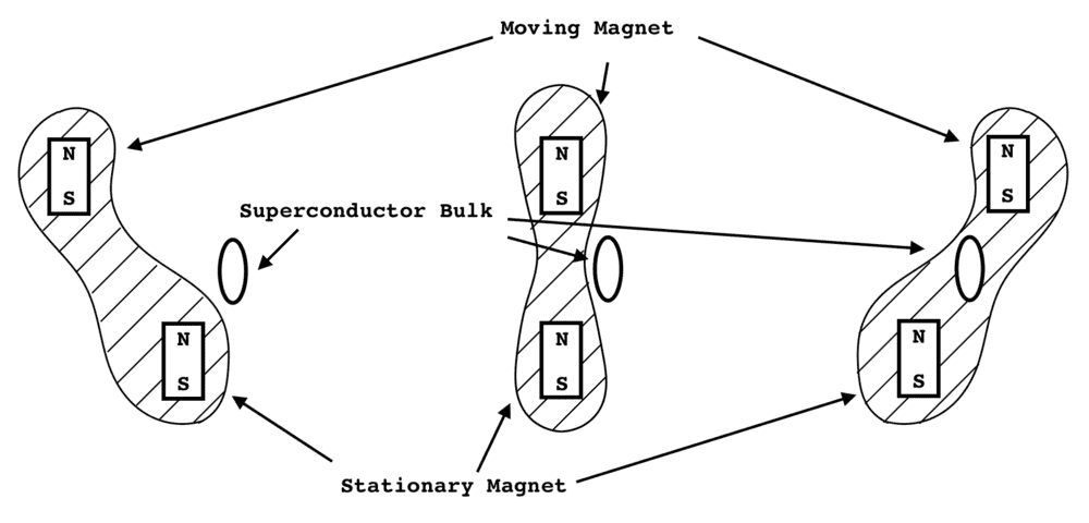

Following is an illustration of magnetic field distribution with shaded region having H > Hc:
What would happen to the temperature of superconductor after one complete cycle?

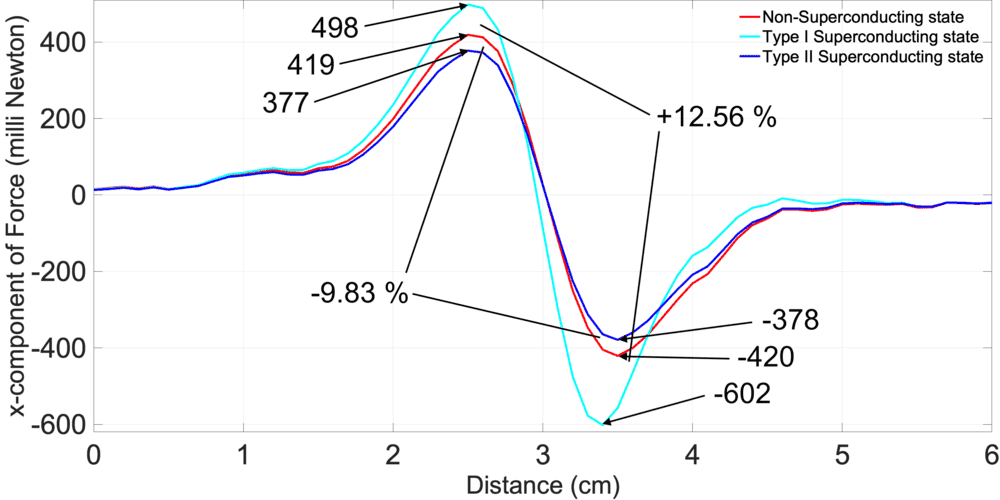

The figure is just for illustration. Yes, it should be asymmetric when the superconductor is in superconducting state and symmetric when it is not. Also the ends would flatten.
One can obtain these results from any commercial software, I used flux software.
The point is that the net area in both cases is zero. But the total area is greater with blue curve than red curve. Agree?
Looks plausible. The point where the force switches its sign will differ between the two scenarios.

Above are the actual results from flux software. Kindly ignore results from Type II(the model implemented is not correct)
