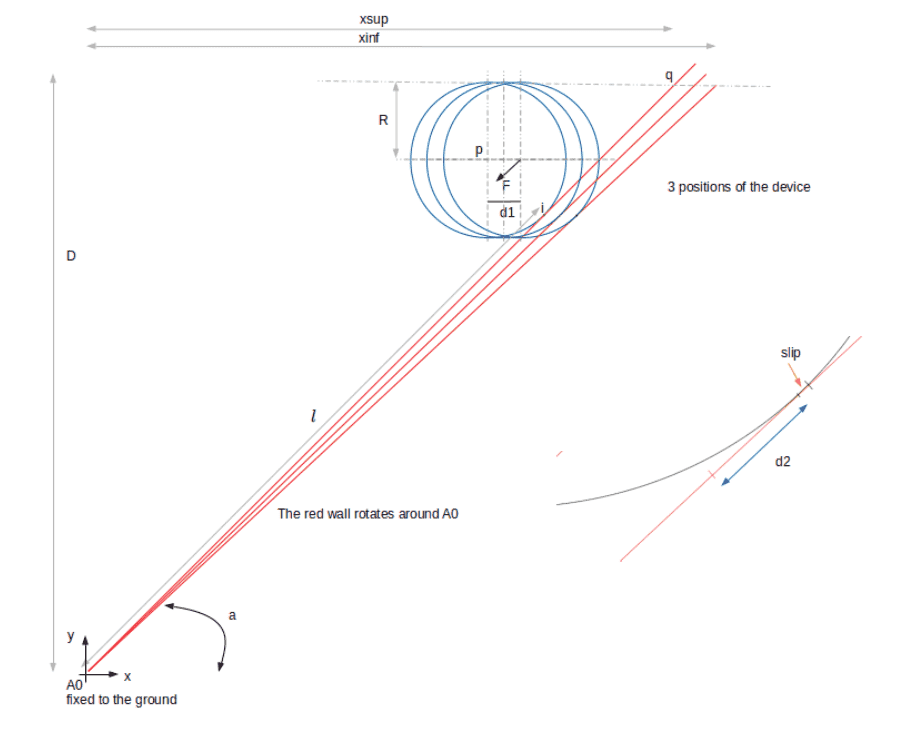

JrK said:
Summary:: It is a cinematic question of a basic movement of two shapes.
Hi,
It is my first message :) I hope you are all fine and safe in these difficult days !
I cannot find the good orientation of the vector of friction. A circle moves in translation to the right and in the same time the wall rotates around A0. A0 is fixed to the ground. There is always the contact between the circle and the wall. The circle doesn't rotate around itself, it is just a translation. There is a friction between the circle and the wall, I supposed the friction constant in value, not in orientation, for a small angle of rotation of the wall. At start, I thought the vector of friction has the same orientation than the wall but if I supposed that : the work from the translation of the circle is higher than the work from the friction. So, I think the orientation of the vector of friction is not like I think, how can I draw the good orientation of the vector of friction ? When I draw the length that the force moves along the wall I find a distance lower than I thought because there is a "slip" due to the modification of the angle of the wall and so the position of the dot of contact between the circle and the wall. So, is there a method to construct by drawings the orientation of the vector of friction ?
I drew 3 positions of the device with a small angle of rotation of the wall. And I drew an enlargement of the dot of contact:
Have a good day guys !
Friction is always opposite to movement. You've chosen the wrong frame of reference. I guess.

That is a non-inertial reference point. Not really useful for energy calculations.
  • #222
I saw the force from the needle: F1
The needle is very small: the size of one atom if I can. The circle is fixed.
At start, I would like to study my example not the pure rolling. But why not, in that case, the circle and the wall has tooth like gears, otherwise the red wall will escape. The tooth are useful for the red wall not for the needle.

  • #227
JrK said:
... inflate ...
What does this have to do with your original scenario? It was rigid bodies only.
  • #228
But the method is not universal ? it works for some examples not for others, so how to know if for an example it works or not.
  • #229
The universal method is integrating force dot relative velocity.

  • #238
JrK said:
Yes, it is because I think with the dot of contact ...
It has nothing to do with their contact point. The wall rotates while the circle doesn't, so the orientation of the wall relative to the circle changes.
  • #239
Have the equations I need to integrate ?
  • #240
The 2nd equation in this section (v is the relative velocity of the materials in contact)
https://en.wikipedia.org/wiki/Work_(physics)#Mathematical_calculation
But in your specific scenario you can derive an analytical formula for the slip distance (sum of green and violet lines in post #179), and then multiply it by the constant force of friction.
