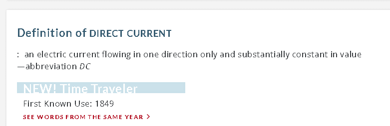

Webster:
Dictionary entry showing the definition of direct current: an electric current flowing in one direction only and substantially constant in value, abbreviated DC. Below it, First Known Use: 1849.
You have to filter out the AC component to make it 'substantially constant in value' .This
