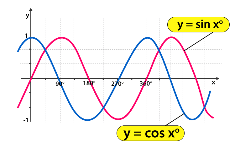

I thought it was kaput, until I noticed the difference of squares under the radical:
$$ \begin{aligned} y(x) &= \int \frac{\sqrt{ ( (A^2 + 1) - 2A )( (A^2 + 1) + 2A) } }{2A} dx \\ \quad \\ &= \int \frac{\sqrt{ (A-1)^2 ( A+1)^2 }}{2A} dx \\ \quad \\ &= \int \frac{A-1}{2A} dx +\int \frac{A+1}{2A} dx \end{aligned}$$
Surely this is a complete blunder...I'm getting that:
$$ \int \frac{A-1}{2A} dx +\int \frac{A+1}{2A} dx = \int dx = x-x_o $$
What...
$$ y(x) = x - x_o$$
??:redface:

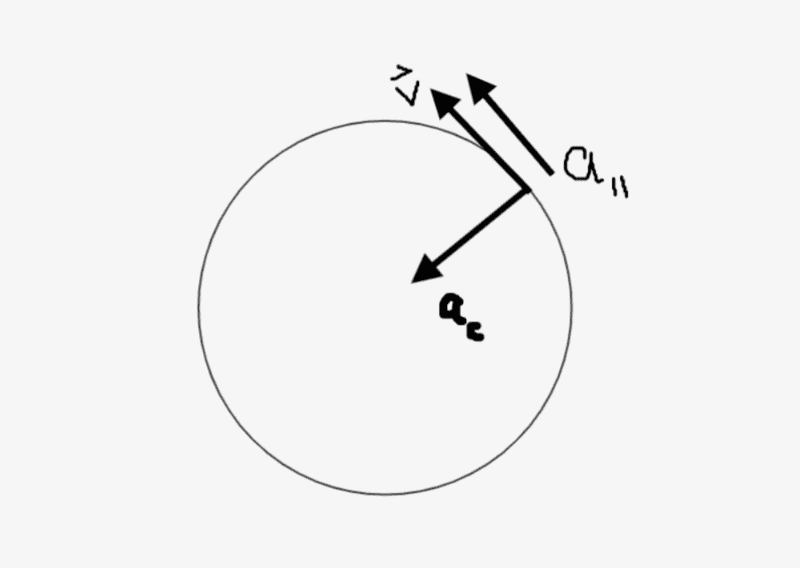

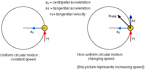

Lnewqban said:
What happens during circular movement?
Could you have another acceleration vector that could be combined with the vector of centripetal acceleration in such a way that the resultant acceleration vector forms a constant angle with the velocity vector of the ball?
I understand that the velocity vector and acceleration vector are perpendicular to each other at every location on the circle in uniform circular motion at a constant speed because the acceleration vector points in the direction of the circle's center and the velocity is always tangent to the circle. Where should I draw "another acceleration vector" that you have pointed out in the above question?
The centripetal acceleration is the acceleration component normal to the velocity, so any other acceleration must be parallel to it. That's the tangential component.
Does it look like this?
Yes, though it does not have to be a circle. The diagram works for any section of the path short enough to be approximated as an arc of a circle.
Thank you, that makes sense!
You understand correctly.
In accelerated circular movement there is a component of the acceleration that is tangential.
Oh, thank you so much. A lot is explained by these two diagrams. Worth it. I've learned something far more thoroughly than I anticipated.
