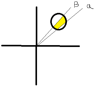

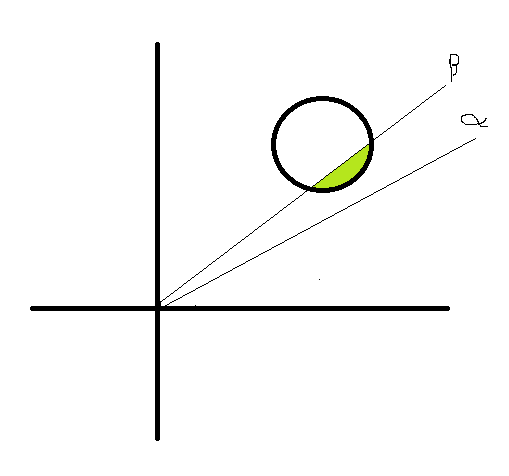

Hi, I'm trying to find the area of a circle in polar coordinates.I'm doing it this way because I have to put this into an excel sheet to have a matrix of areas of multiple circles.
Here is an example of the problem.

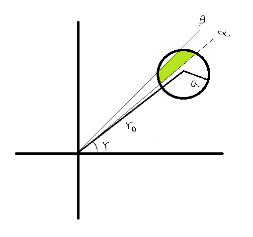

a= radius of small circle
(gamma, r0) = polar coordinate system where phi is the angle and r0 is the distance to the center of the circle
gamma = phi (sorry for the confusion) just another constant
They are all constants except for theta.

I'm sorry, but we aren't mind readers here. What are ##a,r_0, \theta, \phi##? And is the ##r## in the first equation supposed to be the same ##r## in the second equation?
Sorry I'll upload a better picture with a description
Yes the r's are the same. I changed phi to gamma. Not sure why I did.

Now that you've updated your figure:
For a circle of radius, a, centered at (r0, φ ) in polar coordinates, the equation in polar coordinates, (r, θ), is like the one you found on wikipedia:
\displaystyle <br /> r=r_0\cos(\theta-\varphi)\pm\sqrt{a^2-r_0^2\sin^2(\theta-\varphi)\,}​
Added in Edit:
If a ≤ r0, then the limits of integration for θ should be \displaystyle \varphi\pm\sin^{-1}\left(\frac{a}{r_0}\right)\ .

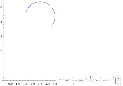

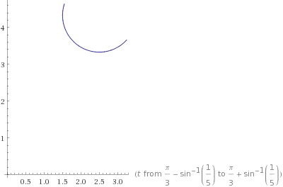

As that math prof. said,
Using the plus sign of ±√, gives part (at least a little more than half) of the circle, which he called ro, for rOUTER . The minus sign of ±√, gives part of the circle he called ri for rINNER .
Find the area from the origin to rOUTER. Subtract from that the area from the origin to rINNER
Below is rOUTER .
Below is rINNER .
(From WolframAlpha)

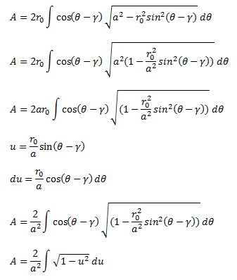

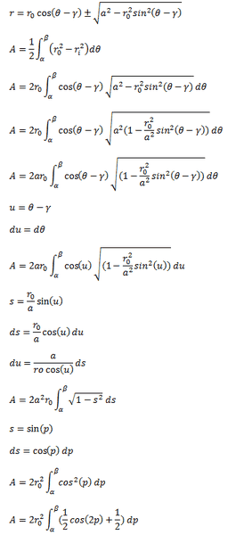

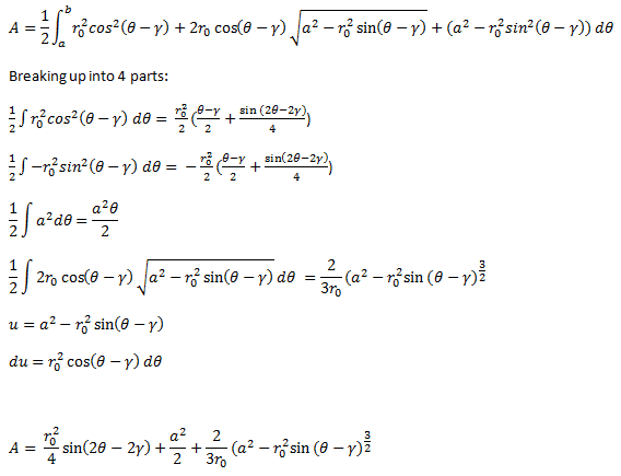

Okay I understand now. This is the general equation I should be using throughout excel.
After working this out, I came to this equation. How do I integrate this?
Is this correct? Not sure where to go after this.
*ignore 2nd to last line*

It seems crazy, but the next thing to do is a trig substitution.
Let u = sin(t) ...
Thanks, I see how this works.
One more question. Are my trig identities correct where:
u = sin(theta-phi)
du = cos(theta-phi)

They're not really identities, and they're almost correct.
du = cos(theta-phi) d(theta)

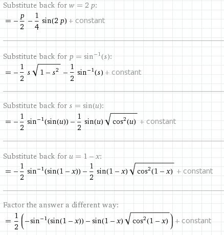

I tried to do this and checked my math with Wolfram Alpha. I'm confused on one of the steps
*for some reason I input x-1 but it kept putting 1-x*
My question is how does this work?
sin(2p) ----> s√(1-s^2 )
So I checked my work on Wolfram and I think this is correct. But when I try to plug in values, they don't work.
I'm not sure what I'm doing wrong.
If you're asking in regards to sin(2sin-1(s)), then the double angle formula for sine.
cos(sin-1(s))=√(1-s2) .
