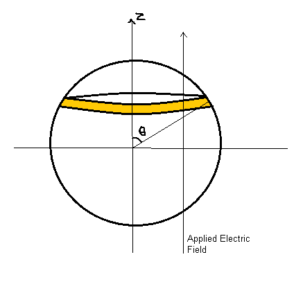

@TSny $$E=\frac{\partial\Phi}{\partial r}\hat{r}+\frac{1}{r}\frac{\partial\Phi}{\partial\theta}\hat{\theta}$$
$$E=-E_0\left(1+\frac{2a^3}{r^3}\right)\cos\theta\hat{r}+E_0\left(r-\frac{a^3}{r^2}\right)\sin\theta\hat{\theta}$$
$$\sigma=\epsilon_0E_{r=a}=-3\epsilon_0E_0\cos\theta$$
As @rude man pointed out, charge density depends only on ##\theta##.
Diagram of a sphere with a horizontal axis and vertical z-axis, a shaded band near the top of the sphere, angle theta measured from the center, and an arrow labeled Applied Electric Field pointing upward on the right.
Should I now integrate ##EdA\sigma##?
OK, but don't forget the negative sign in the basic equation ##\vec{E} = -\nabla V##.
There's a factor of 1/2 that's easy to overlook here. For example, see this video. Be sure you're awake at around time 7:45 in the video.:bugeye:

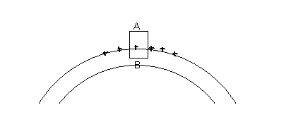

At the surface, ##E=3E_0\cos\theta##. This electric field is due to both the applied electric field and due to the induced charge.
Diagram of a thin curved conducting shell with a small rectangular pillbox straddling its outer surface, labelled A at the outer edge and B on the inner edge, with small arrows along the outer surface pointing outward from the shell.
Near a conducting surface (that is, at A) , the electric field due to the conductor is ##\frac{\sigma}{\epsilon_0}##
Let E1 be field due to the charge inside the pillbox and E2 be other electric field.
Total electric field at A is $$\frac{\sigma}{\epsilon_0}=E_1+E_2$$
Inside the conductor, at surface B, ##E_1=E_2##
$$E_2=\frac{\sigma}{2\epsilon_0}$$
Force is ##\frac{\sigma}{2\epsilon_0}dq##
Yes.
##\sigma / \varepsilon_0## equals the net electric field just outside the surface of the conductor. This net electric field includes the field of all charges on the conductor as well as any other charges not on the conductor and any applied external field.

$$dF=\frac{\sigma}{2\epsilon_0}\sigma dA=\frac{9}{2}\epsilon_0E_0^2\cos^2\theta\hat{r}$$
$$dA=2\pi a^2\cos\theta\sin\theta d\theta$$
Only force along $z$ remains (that is, along rcosθ). The other components cancels out.
$$dF=9\epsilon_0E_0^2\pi a^2\cos^3\theta\sin\theta d\theta$$
$$F=\frac{9}{4}\epsilon_0E_0^2\pi a^2$$

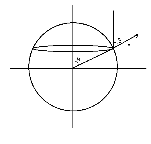

I have dA = a2 sinθ dθ dφ = 2πa2sinθ dθ.
The radius of the ring is ##a\sin\theta##. Its width is ##ad\theta##. Yes. The area is ##2\pi a^2\sin\theta d\theta##.
Then $$dF=\frac{\sigma}{2\epsilon_0}\sigma dA\cos\theta$$
since other component cancels out.
The final answer is same. I think I made some typing error. (I also missed 'dA' in the first line).
Why the cos θ term? Looks to me like it should be sin θ, not cos θ, since the "pull" is maximum at the equator where θ = π/2, and zero at the poles where θ = 0 and π.
So that would make $$dF=\frac{\sigma}{2\epsilon_0}\sigma dA\sin\theta$$, with
dA = 2πa2sin θ dθ.
