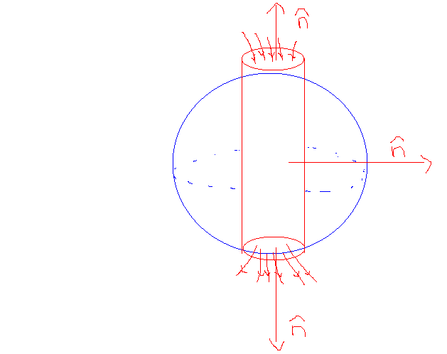

I drew my sphere with the electric field lines. I think they move from top to bottom.
However, I was using a sphere as a Gauss' surface, but this is still my initial question, I don't see how to check the boundary conditions.
Should I use a different Gauss' surface for boundary conditions?

sphere top to bottom.
I have to check the boundary conditions for all 3 faces of the cylinder.
For the top face.
since if ##\vec{D}## is parallel to the surface ## \vec{D}^{above}_{||} - \vec{D}^{below}_{||} = 0##
##\int_S \vec{D} \cdot d\vec{a} = \vec{D}^{above}_{\perp}- \vec{D}^{below}_{\perp} = Q_f = 0##
##\int_S \vec{E} \cdot d\vec{a} = -\vec{D}^{above}_{\perp}+ \vec{D}^{below}_{\perp} = \frac{\sigma}{\epsilon_0} = \frac{\sigma_b}{\epsilon_0}##
I don't understand this. Please describe your cylindrical Gaussian surface in more detail or perhaps post a drawing of it and the dielectric sphere.
Hand-drawn sketch of a blue circle with a vertical red cylinder passing through it, with red arrows labelled n-hat pointing outward at both flat ends of the cylinder and an outward n-hat arrow pointing right from the centre.
That will not do much for you. I don't want to lead you astray by offering misleading advice. Your statement of the problem is "Find the Boundary conditions for (E and D) for a dielectric sphere." Is that exactly how it was given to you?
If "no" I need to know exactly what was given to you. If "yes" you need to review your notes or textbook where the boundary conditions were found for a flat surface and make sure you fully understand the derivation. It requires drawing a Gaussian surface for the normal component of D and a closed loop for the tangential component of E. The goal is to adapt the derivation to the case of a dielectric sphere. I can guide you through that but not if you do not fully understand the derivation; it will be a waste of your and my time.
Let us know when you're ready.

What you are doing is not really wrong but it won't take you anywhere either because these are the boundary conditions for a conductor. Here you have a dielectric. You need to
(a) Write down the boundary conditions for a dielectric-vacuum interface.
(b) Find the D and E fields inside the dielectric sphere and in the vacuum. Griffiths does that for you and you have to find it.
(c) Use the results of (b) in the equations of (1) and see whether the left-hand side of each equation matches the right-hand side. That's the verification part.

Look in Griffiths chapter 4 for (a). Look carefully. What else did you see?
You can use a very small pillbox for a Gaussian surface, so small that the surface of the sphere that it encloses is flat, just the floor of the room you' re in which is on the surface of the spherical Earth. Put it at some arbitrary angle ##\theta## relative to the z-axis and definitely not along the z-axis.
