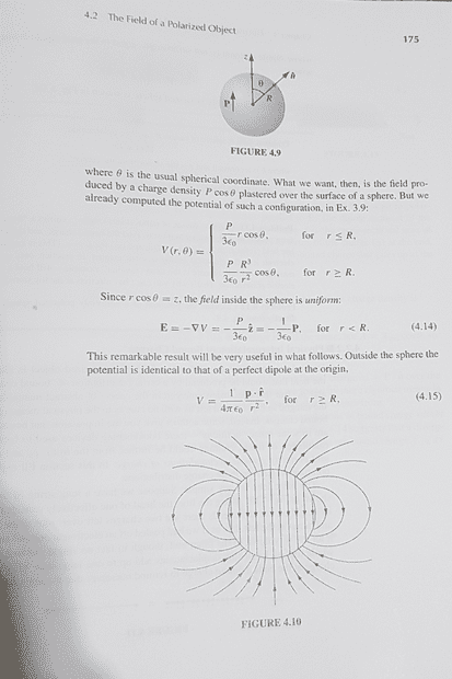

It is a well-known problem. OP has a copy of Griffiths which treats it. In my edition it is example 4.2. Evidently OP didn't notice its presence. @EpselonZero please look it up and study it.

I see that, but I don't understand why what you said in post #10 doesn't work. I mean, that's why I was and I'm so confuse. Both doesn't give me the same result, so I thought example 4.2 wasn't correct for my problem.
Furthermore, the problem is about the boundary conditions, maybe I'm wrong, but I don't see the link between E inside the sphere and the boundary conditions.

Using ##V(\vec{r}) \int_V \frac{\vec{P} \hat{}r}{r^2} d\tau##
I found ##\vec{E} = - \frac{P\hat{z}}{3\epsilon_0}## r<R
##\vec{E} = \frac{\vec{P}\hat{r} R^3 2}{3\epsilon_0 r^3}## r>R
If the boundary conditions gives me the electric field at the surface of the sphere. Then ##\vec{E}## found with boundary conditions should be the same as the electric field found inside the sphere, since there are only the surface charges.
The one calculation that is fairly simple is to compute the electric field at the center of the sphere from Coulomb's law. I'm not sure what you did for the above, because you didn't show your work.

I only have the griffith as textbook and that's what he did in the example 4.2. The example Kuruman told me to look.

I edited my post with the example from the book
See https://www.physicsforums.com/threa...ormly-polarized-cylinder.941830/#post-5956930
The above is the problem from Griffith's that we worked a couple years ago on the Physics Forums. Griffith's uses a different method to solve this one, but I do recommend you get familiar with the Legendre method of solution. For the Legendre method, you are given a series of terms of powers of ## r ## and ## \cos{\theta} ##, etc. , and you make an educated guess for a solution. If you can show your solution satisfies the boundary conditions, it then is indeed the correct one.
I don't know what it means that my solution satisfies the boundary conditions. Are they the same?
There's not even an example on how to find the boundary conditions for E and D, I'm not even sure of what I'm doing. I can't find answers to my questions. I didn't know I can't use ##D = \epsilon E##, so I lost a lot of time.
