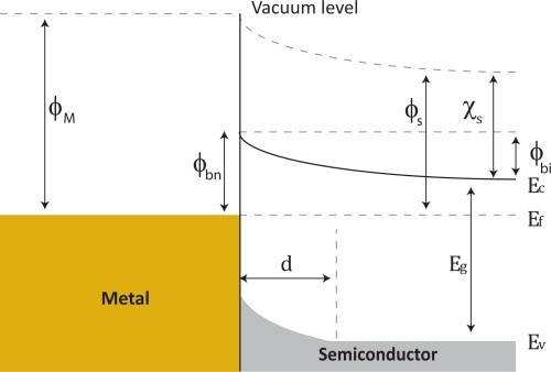

Hi,
I am studying the Metal-Semiconductor junction. I cannot find any clear explanation of the continuity of the vacuum level at the interface. Can someone help me?
My reference book provides me with the following:
When two different materials are brought into contact, they must share the same free electron level at the interface, i.e. the free electron level is continuous from one material to the next. This is because at the interface of two materials, an electron that is free from the crystal field of one material is also free from the crystal field of the other material.
This explanation doesn't convince me because at the interface the bands are not continuos. So speaking of " the energy of an electron at the interface" doesn't make any sense for me...
Thank you

The discontinuity of the bands at the interface is a consequence of the continuity of the vacuum level. In fact, for each of the materials electron affinity (e.a.) is inherently constant; since, in general, the metal and the semiconductor have different electron affinities, if the vacuum level is continuos then bands must be discontinuous.

In order to make the discussion easier I post the band diagram.

The conduction band seem to be discontinuous at the interface (please, refer to the image I have posted). Actually the bands of the metal are not showed, so I guess the conduction band is somewhere below the Fermi level. Where is the mistake?

Vacuum level is the energy of a still electron in the vacuum, and it is taken as reference. Free electron energy is the energy required to set an electron free from the lattice, to free the electron in the vacuum.
In the image I have posted, vacuum level is taken as reference and is drawn in the top part of the figure. Do we agree about what I wrote till now?

Take a look at the image. The highest level in the figure, called "vacuum level", is indeed the vacuum level according to the definition you wrote in post #8?
