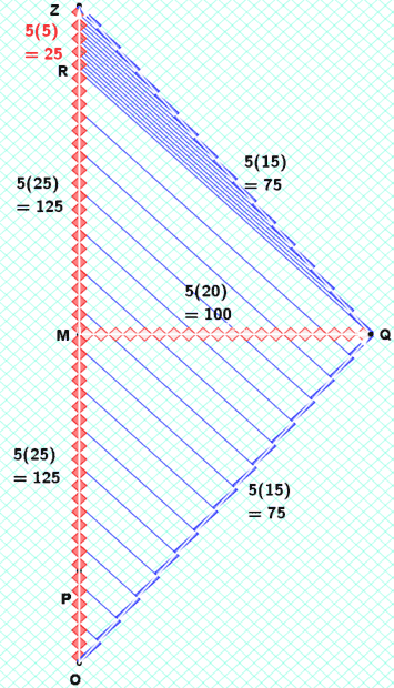

in a discussion on the twin experiment, I read that an author (Darwin) proposed that the non-inertial traveler twin sees the transition between the redshifts and blueshifts at the very moment when he turns around, while the inertial twin sees this transition with a delay, which means that for him the perception of redshifts exceeds that of blueshifts, and therefore he receives less flashes than his brother. Does this argument seem valid to you?
Likes FactChecker
It's one way of doing the analysis, yes. It's reasoning from direct observables (the received flashes) to predict another direct observable (clock readings at meet-up), which is a very experimentally oriented approach.
Likes vanhees71 and Kairos
Thank you. This delay was not obvious to me.
The traveller sees a change in frequency immediately when they turn around because the frequency change is caused by them accelerating. The stay-at-home doesn't see a change in frequency until the first pulse emitted by the traveller after turn around reaches home, which is after half the journey time. So the stay-at-home has more time receiving redshifted pulses than the traveller.

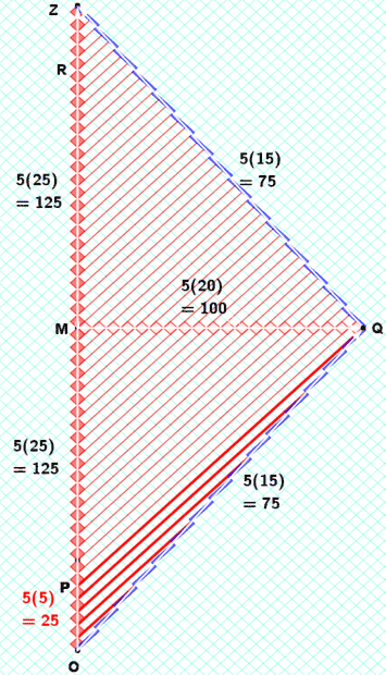

Okay. And if we suppose that instead of turning back, the traveler stops. He returns to the same inertial reference frame as his brother, but at a distance. Based on the number of redshifted pulses received, he is also younger in this case?
Ambiguous, because the traveller and stay-at-home are not in the same place so cannot compare clocks without first agreeing a simultaneity convention. Using the obvious Einstein synchronisation in their mutual rest frame the traveller would be younger, yes. You can use Doppler analysis to establish this, but you still need the simultaneity convention.
By the way "returns to the same inertial reference frame" is meaningless. Everything is always in all reference frames. You could say "returns to rest in his brother's rest frame" or "he has the same inertial rest frame as his brother".

This didn't need to be "proposed"; it's obvious as soon as you look at the worldlines of the light pulses being emitted by each twin and how they intersect the worldlines of the twins themselves. For a good if brief discussion, see the Usenet Physics FAQ article on the twin paradox; the two most relevant pages are the Doppler Shift Analysis [1] and Figure 2 of the Too Many Analyses page [2].
[1] https://math.ucr.edu/home/baez/physics/Relativity/SR/TwinParadox/twin_doppler.html
[2] https://math.ucr.edu/home/baez/physics/Relativity/SR/TwinParadox/twin_vase.html

Your logic here is incorrect. The "periods" do not change duration; there is no such thing as a "redshifted period" and a "blueshifted period": each "period" between two successive signals is the same amount of proper time (1 hour) for the observer sending the signals.
In the scenario you describe here, the traveling twin emits 150 signals (not 90--there are not 45 traveler periods during each of the outbound and return legs, there are 75--see further comments below) total during his trip, and the stay at home twin emits 250 signals. That means the traveling twin experiences 150 hours of proper time and the stay at home twin experiences 250 hours of proper time. Geometrically, this corresponds to the length of the traveling twin's path through spacetime being 150 hours, and the length of the stay at home twin's path through spacetime being 250 hours. (These "lengths" are given in time units because they are timelike worldlines.)
Let me expand your description of the scenario somewhat to illustrate the points I have just made. Here is a more detailed description of the traveling twin's experience:
The traveling twin, on his outbound leg, receives 25 signals from the stay at home twin. He receives these signals over a period of 75 hours by his own clock. (75 comes from the Minkowski metric formula for the length of the traveling twin's outbound leg: ##\sqrt{125^2 - 100^2} = 75##. That means he receives one signal every 3 hours, for a Doppler redshift factor of 3. Note, however, that this says nothing about how much time elapses on the stay at home twin's clock between signals. That time is still 1 hour, not 3 hours. The Doppler redshift factor of 3 gives the ratio of the interval between signals being received, by the receiver's clock, to the interval between signals being sent, by the sender's clock.
On the traveling twin's return leg, he receives 225 signals from the stay at home twin, over a period of 75 hours by his own clock. That means he receives one signal every 1/3 hours, for a Doppler blueshift factor of 1/3. Again, this does not mean the sender's clock marks only 1/3 of an hour between signals; it only means the receiver's clock marks 1/3 of an hour between signals.
So the traveling twin receives a total of 250 signals from the stay at home twin, over a period of 150 hours by his own clock. There's the time difference.
Now let's look at the stay at home twin's experience. For the first 225 hours by his clock, he receives 75 signals from the traveling twin. This gives a Doppler redshift factor of 3. For the last 25 hours by his clock, he receives another 75 signals from the traveling twin. This gives a Doppler blueshift factor of 1/3. So he receives a total of 150 signals from the traveling twin, over a period of 250 hours by his own clock. Again, there's the time difference, and both twins agree on it.
Kairos said:
According to my simple above calculation which I believe complies with the laws of special relativity
It doesn't. See my post #24 just now.

It is hard to see where you went wrong since you didn't post the derivation, just your final numbers, but this is not entirely correct. Using units where ##c=1## and ##v=4/5## we do have a Doppler redshift factor of 3 and a Doppler blueshift factor of 1/3. Everything below is done in the stay at home twin's frame which is inertial and the coordinates are given as ##(t,x)##.
The worldline of the home twin is $$r_{home}=(t,0)$$ while the worldline of the traveling twin is $$r_{twin}=
\begin{cases}
(t,t \ 4/5) & t \le125 \\
(t,200-t \ 4/5) & 125\le t
\end{cases}$$
The worldline of the n-th outgoing (from home to traveling twin) light ray is $$r_{out}=(t,t-n)$$ while the worldline of the m-th ingoing (from traveling to home twin) light ray is $$r_{in}=\begin{cases}
(t,3 \ m-t) & m\le 75 \\
(t,200+m/3-t) & 75 \le m
\end{cases}$$
With ##\Delta s^2=-\Delta t^2+\Delta x^2## and the above worldlines we can confirm that the proper time between each emission and the next is 1, and we can confirm that the proper time between each reception and the next is either 3 or 1/3. So, the Doppler shift formula is correct.
There are a total of 250 emissions from the home twin and a total of 150 emissions from the traveling twin corresponding to a time dilation factor of 5/3, as expected for ##v=4/5##. The traveling twin receives 25 signals on the outbound leg (25*3=75) and a total of 225 signals on the inbound leg (225/3=75) so they received redshifted signals for half the trip and blueshifted signals for half the trip. The home twin receives a total of 75 redshifted signals (75*3=225) and a total of 75 blueshifted signals (75/3=25) so they received redshifted signals for most of the trip and blueshifted signals for only the last little bit of the trip.
The times are not equal.
