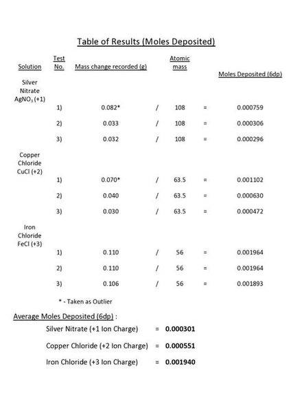

I think I am getting off track here, i have updated my coursework now, it has my graph I've scanned onto, which i think you will find interesting, my mass change results, my moles results, and some analysis. Shall i attach it to my next post?
Thanks again, Adam
Yeah, let's see what are you got.
  • #32
Heres the Improved coursework, its still missing a detailed analysis, evaluation and conclusion.
You should be able to view straight away, if not i can email it to you, or upload the pictures like gokul did :)
Adam

Have you got any more information on currents? At thirty seconds, minute, end of run?
  • #36
i do but i dont, i have the initial currents for all three. i don't have the end current for the +3, and theyre all over the place anyway. What do you think of my graph, and the gradient analysis?
  • #37
Without the current data, it is meaningless.
How much of the definitions given for "I = nAve" is from material given to you with the assignment, and how much is paraphrase? There are some misunderstandings that are killing you, and we've got to get them identified.
  • #38
I only have initial current readings, that's all really. They were all 0.65A. But i didnt use currents to work out moles deposited. I am measuring moles deposited, and i found that out by dividing the mass change by atomic mass.
  • #39
Let's look at something else a bit --- try a different tack.
Compare the sequence of mass changes for each series of three runs of Ag and Cu to that for Fe. Anything strike you as interesting?
  • #40
In my view, the trend should be linear. Look at +2, if we took the average to be the top outlier, there would be a linear fit/trend. It wouldn't be prefect but my results arnt completely precise. This would also make the trend directly proportional, this is what i would have expected, but i can't explain why.
This begs the question, that maybe 0.001102 ( the outlier ) is infact the real answer, and 0.000670 and 0.000472 are outliers, its plausible and would make sense. I will include this in detail in my evaluation OR conclusion
Adz
  • #41
AdamCFC said:
(snip) there would be a linear fit/trend. It wouldn't be prefect but my results arnt completely precise. This would also make the trend directly proportional, this is what i would have expected, but i can't explain why.(snip)
Ah-hah! Now, you take advantage of odd little observations made during the experiments. For instance, looking just at the three runs with Ag, what can you tell me about them? Did you use the same pair of electrodes for all three? Did you notice anything about the metal plated onto the electrode? (Coverage, bare spots, that sort of thing) And, just a general question, what can you tell me about the surface area of the rough side of a piece of sandpaper compared to the "smooth" side?

Why should the trend be linear?
  • #47
"n:" decreased through each run as material is plated on the cathode; changed from Ag to Cu to Fe as number of anions increased.
"A:" increases or decreases as material is added to the cathode (forming dendritic growths to increase, filling pores to decrease), but cannot remain constant. Compare the Ag and Cu results from 1 to 3.
"v:" no current measurements, no way of knowing much of anything about anion current; switching anions from nitrate to chloride; changing cation masses; changing cation radii (sizes); and none of this is even going to be on your radar until AFTER you've been through your first chem course.
"Why linear?" If n, A, v are constant, the expression I = k times e is linear in e.
  • #48
Are you saying my analysis of n A and v are wrong? or are you adding to them?
Isnt this charge, not number, as i am changing ion charge?
Yes, by comparing my results from 1-3 on Gold and Copper, i see the mass changes decrease slightly over the 3 runs. Wouldnt the "growths" and "fill ins" roughly equal up? or do they have tendencies to do just one?
Velocity, didnt i control these well, both through temperature and input voltage?
Finally, I = k x e - what is k?
Ive heard k is "so many times" something? e.g k X 9 would be the 9 times table?
Thanks

"n" is the concentration of ions per unit volume; "e" is the charge of a particular ion. 0.1m AgNO3 ionizes when dissolved in water to give you 0.1m NO3-1 and 0.1m Ag+1 which is not the same value of "n" for 0.1m FeCl3, 0.1m Fe+3 and 0.3m Cl-1. The current carrying product of n and e for the two salts is different, 0.2 for Ag and 0.6 for Fe.
:/ i don't understand much of this.
So, I = k x e ... = ... I = ( n x A x v ) x e
so because i just increased e in equal increments, that's why the line/trend should be linear. but my slight errors in keeping n constant have caused it to become a curve?
Can i include this, and that equation in my evaluation/conclusion?
and what did u think about the start of my analysis on the last page?
  • #51
Just an extra thing to my last post. I would like to include a hypothesis, does this sound suitable and where would i put it?
If moles deposited is related to ion charge, then increasing the charge will increase the current and mass change, which in turn will increase the amount of metal deposited.
Do the bits in bold need to be re-arranged?

You predict a "linear trend." Let's work on that, because there is something in "I=nAve" that is still leading you off into the weeds.
Looking just at silver and iron, +1 and +3 charges, you expect to see the current triple; you are going to "measure" current by weighing the cathode of each cell before and after a timed electrolysis and calculating moles plated onto the cathode. What is your prediction for the number of moles of iron? Less than, greater than, or equal to the number of moles of silver?
  • #55
er, I am not sure. I don't think i expect iron+3 to have three times more moles deposited than silver +1. I do expect a proportional relationship though. I expect more moles deposited on the cathode after using the iron electrolyte than the silver electrolyte. This is because iron ions have a higher charge.
Am i right in thinking, because silver has almost double the atomic mass of iron, that 10 iron ions would need to be plated to equal 5 silver ions?
If this is the case, because iron deposited a higher mass change than silver, many many more ions were deposited on the cathode than the amount of silver ions deposited.

Ok, so to your previous question, I predict there will be more moles of iron deposited than moles of silver.
Whats that?
  • #58
Silver ion at +1, current is I; ferric ion at +3, current is 3I. WHAT is the definition of current? Same time for both cells, total charge transferred is what for silver? And what for iron? Reducing how many moles of silver? And how many moles of iron?
You've got two guesses left.
  • #59
Current represents the flow of electrons through a conductive material.
Silver needs 1 electron to become an atom again, Iron needs 3.
  • #60
Current is defined as CHARGE per unit time, be that charge carried by electrons, or ionized atoms or molecules.
