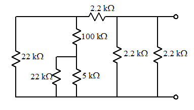

Find the Thorton equivalent of the circuit shown
[/B]
Resistor circuit schematic with a 15 V source, a 6 V source, a 5 V source, resistors of 22 kΩ, 22 kΩ, 2.2 kΩ, 2.2 kΩ, 2.2 kΩ, 5 kΩ and 100 kΩ, and terminals labelled Iab and Vab.
Voc=IscRs
Rseries=R1 +R2+...
Rparallel=R1-1+R2-1+...
So, I thought I should first solve for the Rsource, by shorting all of the voltage sources:
Hand-drawn resistor network with labeled values: 22k, 2.2k, 100k, 2.2k, 2.2k, 22k and 5k resistors arranged in a bridge-like configuration between two nodes.
However, I don't think the value I am getting is correct.
One value I got is 2111.66 ohms(I combine the 2.2, 2.2, and 5k in series and parallel that with 100k. Then I add the 22k and 22k with the calculated resistance and that is in parallel with the 2.2k)and the other I get is 51663 ohms. (I put the 2.2k from the right with the 2.2k in parallel. Then that combo is in series the other 2.2k and the 5k. That is in parallel with the 100k, and that, finally, is in series with the two 22k)
Please, can someone help me?
I'm not seeing how your 2.2, 2.2, and 5k can be in series.
Try a bit of manipulation of your suppressed-source diagram before you start combining things. Note how the 5K and the 2.2K it connects to are really both tied to the bottom rail? So is one end of both of the 22K resistors. Redraw the circuit to make that more obvious:
Circuit schematic with resistors labelled 22 kΩ, 100 kΩ, 2.2 kΩ, 2.2 kΩ, 2.2 kΩ, 22 kΩ and 5 kΩ, with two output terminals on the right side.
Does that help?
I think I understand it a little better. Thank you!
