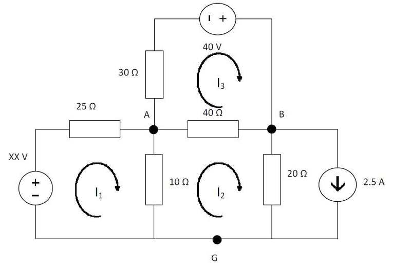

Where XX is 60V
I'm trying to find the node voltages at point A and B, however each time I've tried this and then checked using circuit wizard it has come up incorrect. Yes my circuit in circuit wizards is correct.
V1: I1=I2+I3+Iground
60-V1/25 = V1-V2/40 + V1-40/30 + V1-0/10
then i multiplied by 600 to remove the denominators
1440-24V1=60V1 +15V1-15V2+2-V1-800
2240=119V1-15V2 (Eqn 1)
V2: I2+I3=2.5+Iground2
V1-V2/40 +V1-40/30=2.5 + V2-0/20
then i multiplied by 120 to remove the denominators
3V1 - 3V2 + 4V1 - 160 = 300 + 6V2
7V1-9V2=460
I then put them into a matrix and tried using cramers rule to solve for v1 and v2
119 -15 l V1 l l 2240 l
7 -9 l V2 l l 460 l
119x-9 - -15 x 7
Doriginal= -966
2240 -15
460 -9
2240 x -9 - -15 x 460
D1= -13260
119 2240
7 460
119 x 460 - 2240 x 7
=39060
V1= -13260/-966 = 13.7V (Circuit wizard shows it as being 2.37V)
V2= 39060/-966 = -40.43V (Circuit wizard shows it as being -9.71V)
please help!

I would put everything on the left side of an equation, and equate to zero, include parentheses and fix a sign error and an omission:
(V1-V2)/40 + (V1-V2+40)/30 + (V1-0)/10 + (V1-60)/25 = 0
Multiply through by 600, collect terms and get Eqn 1:
119V1 - 35V2 = 640
For the second equation:
(V2-V1-40)/30 + (V2-V1)/40 + (V2-0)/20 + 2.5 = 0
Multiply through by 120 and get Eqn 2:
-7V1 + 13 V2 = -140
Solving, I get:
V1 = 570/217 = 2.6267
V2 = -290/31 = -9.3548
