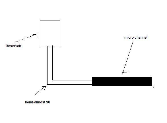

As seen in the attached picture, i basically have a small reservoir of fluid, whose properties are known...and it is made to flow through the pipe and enter a microchannel, whose resistance to flow is known, say R.
Now, as seen, there will be head losses due to the sudden contraction of fluid path from reservoir to pipe, due to the bend, and due to the sudden expansion into the microchannel, and also viscous resistance, ofcourse.
The head loss due to all the above can be calculated in terms of the inlet and outlet velocities through each of them separately.
However, my goal is to make a simple equation, which takes into account all these losses and relates the height/elevation of the reservoir from the micro-channel and the final flow rate through the microchannel achieved, without having to see the velocities at each step...
can anyone give me a clue how to do this?

OK, so someone could atleast tell me if the following is correct:
Let's assume datum is at outlet of micro channel, height of fluid surface of reservoir is H, and reservoir area far bigger than micro channel area, this allow us to neglect head loss from reservoir.
First write Bernoulli's equation between the free surface reservoir(s) and entrance of elbow bend(1).
p1-ps/ρg = (zs-z1) - V1^2/2g
p1-ps/ρg = H - V1^2/2g
Next write energy equation between elbow bend (1) and outlet of micro channel(2).
p1-p2/ρg = (z2-z1) + f(L/D) (V^2/2g) + Kmc(V^2/2g) + K1(V^2/2g) + ...Kn(V^2/2g), z1 = z2
p1-p2/ρg = f(L/D) (V^2/2g) + Kmc(V^2/2g) + K1(V^2/2g) + ...Kn(V^2/2g)
where,
Kmc = loss coefficient for micro channel
K1 = loss coefficient of elbow
K2, K3, ..Kn = other coefficient losses
Note: p2 = ps = Patm
Combining the two equations gives,
(fL/D + Kmc+K1+...Kn + 1) V^2/2g = H
or
V^2 = (2gH) / (fL/D + Kmc+K1+...Kn + 1)
V = [(2gH) / (fL/D + Kmc+K1+...Kn + 1)]^0.5
Flow rate
Q = V*A_mc = [(2gH) / (fL/D + Kmc+K1+...Kn + 1)]^0.5 * A_mc
A_mc = area of micro channel outlet

He wanted to estimate the losses. For estimation purposes is is much cheaper to just use equivalent length tables, and then use your friction factor to find the losses in an equivalent length of straight pipe.
what does the equivalent length mean? Does it apply to all the types of losses?..i thought friction factors only for viscous losses...please clarify.
However, please note that I'm trying to account for all the losses and have the only variables as my Q(flow rate) and h...height of the reservoir above the microchannnel
