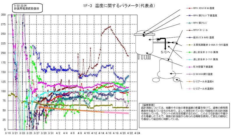

Tepco knew a lot more than is openly or willingly given to public. I have come across below documents, these published ten minute logs of water level and pressure parameters at the most critical time after the tsunami and before explosions, and temperature after 20/3 and depicting were actual temperature sensors are placed.
There are some interesting data like unit 3 the fuel was uncovered 3/4 (-3metres) for more than two hours on the 19th March (does anyone remeber this event?)

Nice images of temperature graphs and temperature sensor locations

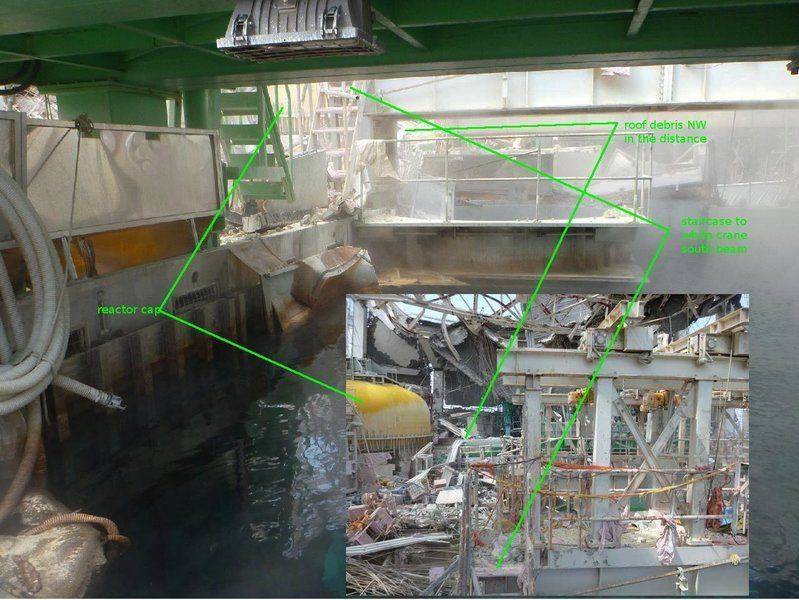

MadderDoc said:
Here is another stab of it (a higher resolution image is attached):
http://gyldengrisgaard.dk/fuku_docs/20110324_down_3thumb.jpg
3) Signature of heat on the winch, and possibly a burn through of the southern boom in this location
4) Missing rails on the top of this section of the southern boom.
5) Areas in which the booms have sunk into the concrete deck of the service floor, extending the NW broken region of the floor.
Excellent work.
3) IMO the crane is not 'burn through', here the crane directed the steam to the release path.
4) there everything covered with that gray dust.
5) On one of the T-Hawk videos it can be seen that the service floor is broken only under the north crane boom.

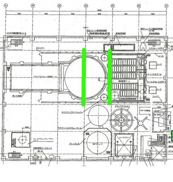

Jorge Stolfi said:
Your sketch shows 30*(7+7+12+12+10)+40 = 1480 slots for fuel assemblies; perhaps there are another 60 in the blind corner at right. On the other hand, some slots seem to be empty.
Yet a previous post claims that there were (548 in-use + 1331 spent + 202 new) = 2081 assemblies in the pool. If that number is correct, then we are missing 500 to 600 assemblies. Seems a bit too much for roundoff error...
At 2010 Dec. there were 783 spent assemblies. Plus the core (548) gives the 1331 for 2011 March. Plus the 202 new -> 1533. According to the various sources the maximal capacity of that pool was 1590.

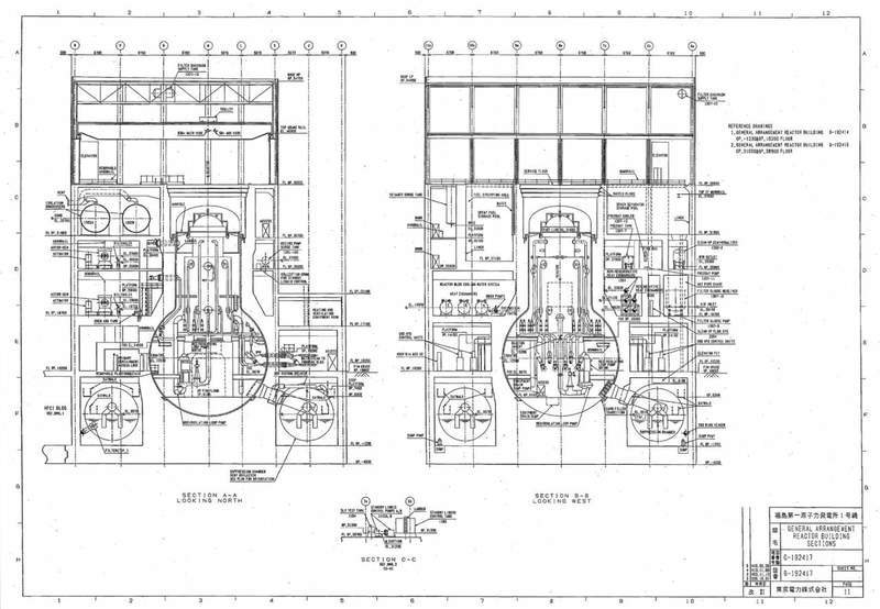

You see that the SFP is tied into the outside of the containment concrete. It hangs sort of like a window box off of the containment structure. There is a very thin piece of concrete that ties the bottom of the SFP to the outer frame of the building. There is nothing supporting the SFP from below.
From looking back at that GE cut-out drawing of a mark I containment, there seem to be at least a bunch of pillars unders the SFP. Well, but for my personal taste there could be a bit more structural support down there.

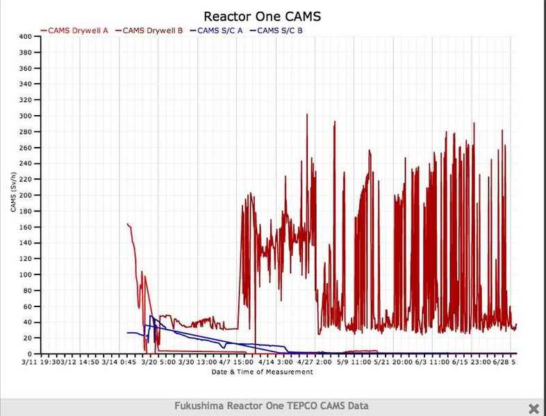

I think one reason TEPCO is not so worried about the unit 3 is the CAMS readings.
On March 14th 7:00 they had quite high reading (167,0 Sv/h) but after that it has been going steadily down. On March 18th it was still 105,0 Sv/h but after a month it was only 15,8 Sv/h.

http://i.min.us/ilnMjk.pdf
On May the levels have also been going down. On May 1st it was 13,7 Sv/h and on May 9th it was 12,1 Sv/h.
CAMS D/W(A)
May 1st 5:00 13,7 Sv/h
May 9th 5:00 12,1 Sv/h
http://www.tepco.co.jp/nu/fukushima-np/f1/images/031_1F3_05090600.pdf
I think what they are more interested in each reactor is the radiation readings and only if they see both temperatures rising and radiation rising will there be a "strong" reaction but if there is only temperature rising the reaction is subtler.

pdObq, it's better to look the overall trend, not some big values every here and now.
For the unit 1 it mostly makes sense until April 7th 18:00 (31,1 Sv/h), then you suddenly get these mega values after which CAMS D/W(A) stops working.
I wouldn't trust the values between April 8th 0:00 - April 8th 13:00 for the unit 1.
Hmmm, the sudden high readings at 4/8 coincide with the sudden temperature rise of that N4B sensor (sorry, too lazy to put the japanese label into google translate). The other temp. sensors seem not to see that.
