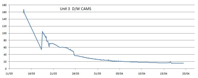

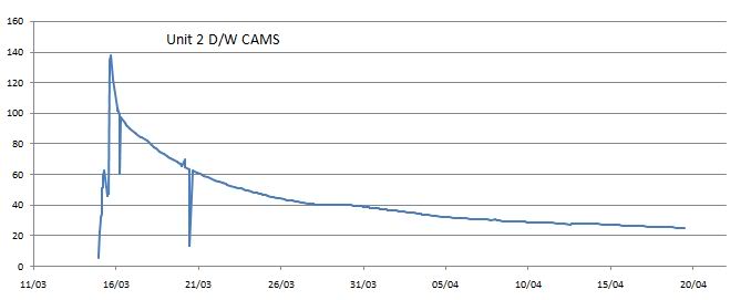

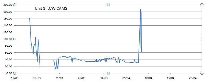

[quote="elektrownik, post: 3291239"]OMFG did you saw CAMS data 3/14 for unit 3 ? It is error or 100% of unit 1 core is damaged[/QUOTE]
elektrownik comment made me study the other files in detail and I plotted D/W CAMS data over the time period provided (Sv/h vs date)
[ATTACH=full]142711[/ATTACH]
[ATTACH=full]142712[/ATTACH]
[ATTACH=full]142713[/ATTACH]
Now note that spike in Unit 1, and Tepco refrained from publishing any more D/W CAMS data after that event, their reports mention that the unit 1 D/W Cams is out of order, both of them the A and B channels
But are they out of order? or is there something happening in the reactor that we are not supposed to know or deduce from their data, now look at the temperature plot, on the same day 8th April there was a sudden spike coinciding with the spike of the CAMS data
I leave it for the experts to comment, was there a sudden small sub-critical event on the 8th April?
