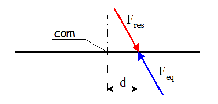

Ask yourself this question: If the tool was floating by itself in space with no forces acting on it except for the equilibrant and one we'll call the resultant, with the equilibrant being located where you previously calculated it to be, where would you place the resultant so that no motion (translation or rotation) would occur?
  • #47
That's a good way to put it to be honest, I'm guessing 2.41m on the opposite side of the equilibrant?
So basically what you said but dumbed-down for myself..
  • #48
Yes, that's where I'd put it. Since we weren't given any information about the 3D dimensions of the tool we have to treat it like a slender rod, and all forces effectively act on the axis of the rod. So conceptually you have a situation like this:
  • #49
Ah okay thanks a bunch, that's basically me done that whole question now, wouldn't have made it without you to be honest so thank you very much, and did you draw that diagram just to show me? If so I applaud your dedication to helping someone understand something :)
  • #50
You're welcome.
Yes, I made the drawing. Took a couple of seconds using Visio, so very much worth the effort if it helps makes things clear.
