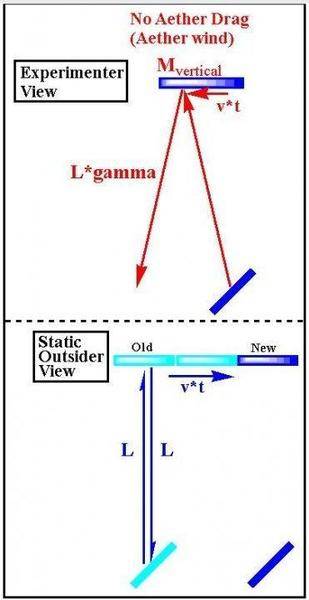

Hi Peter,
That was huge help. Reduced lot of problem. I can ignore the aether drag hypothesis also. So, overall I have to think about only half now! Thanks for all the help.
PeterDonis said:
They're calculating for the no aether drag scenario.
I tried to calculate the same and I am seeing opposite path. Path length is same but lagging behind and not reaching same point as horizontal beam.
I have made a figure and can you please check see what is wrong. Thanks.
The top figure is how the experimenter in the rotating/moving Earth frame will perceive. Relative to the experimenter, the mirrors will be static but the light will be dragged behind (due to aether wind or static aether). So, it will come back to the inclined mirror at 2*v*t distance behind and so it may not overlap with the horizontal beam. Notice that the path bends backwards (towards source side) not forward! This is a highly exaggerated view for clarity.
The bottom figure is how an outside observer (in static aether frame) will perceive. This observer will see that the light goes straight up (because of being in same aether frame) and come back at same path (if it did not miss the moving top mirror) buy by this time the inclined mirror would have moved 2*v*t distance forward. The aqua color mirrors are old positions of the mirrors. Time dilation most likely will compensate for the difference in path lengths. It is not necessary to calculate both but using it as a cross-check for consistency.
But now I have the separation of 2*v*t between the beams by either view, in where they hit the inclined mirror on return. Length contraction rectifies the horizontal-vertical path length difference. Does the length contraction also makes this separation go away? If that will be the case, then that would have further reduced the vertical path length and the horizontal-vertical path length difference will remain again! A last bit of confusion remains.
But to show this, you have to show how the horizontal beam moves, under the assumption of an aether wind. The beam is going against the wind one way, and with the wind the other, and that turns out to mean a different round-trip travel time (again, under the assumption of an aether wind and Newtonian mechanics) than the vertical beam going "crosswind" both ways. That's the whole point of the Wikipedia page calculation.

It looks to me as if you forgot two things:
1. Light reflection from a moving mirror. You wrote: "my thinking is that the light will not be following the mirrors. It will just stay with static aether and move straight up/down". That is wrong: even if it "just stays with static aether", it bounces off a moving mirror. That it must deflect under an angle you can find by means of a Huygens construction.
2. Length contraction. For a perfect compensation of motion, you must adjust the mirror orientation by accounting for length contraction. That changes the mirror's angle. Next when you repeat the Huygens construction, you will find that the light beam will follow exactly the same path as a beam in rest.
Many years ago I worked that out for myself, but I recall that I have seen an article about it (perhaps in the AJP). If you like, I can try to find it back.
PS I found it back: see my old post https://www.physicsforums.com/threa...nt-for-true-length.469311/page-9#post-3140506

I understand that this was to "test" the old theory. But I just wanted to see if I can derive and see how their explanation was working even with the "ad hoc" length contraction which is not "classical". I thought the setup and math was easy enough, but not looking so!
Thanks Harold,
I have not read about Huygens construction. I have to read about it (the link to the paper in that post no longer works). May be that will help.
But length contraction and changing angle are a bit confusing. Won't the length contraction be zero and the angle be same as claimed (45 or 90 degrees) for the experimenter on the same frame?
If we use static aether frame as reference, then the bottom of the figure (in post 7 above) will be the case. Then length contraction will be like one leg in water and one leg in land!
I don't follow that. The Wikipedia drawing is about a mirror that is moving in the ether, from the perspective of an ether in rest (note that the calculation is identical to that of a moving mirror in SR as seen from a "rest system").
That figure is wrong on two points as I explained. The drawing to which you refer in your first post will be the case for the light path (drawing and animation on the right), however the mirror angle is slightly wrong in Wikipedia because also there the length contraction of the moving mirror is ignored.

Same way I have problem to understand the mirror angle changes caused by length contraction. I can only visualize all parallel contractions without any angle changes. [..]
Once more, did you actually try to draw a length contracted mirror on paper, or are you merely trying to picture it in your head? Or, a cheap and simple trick is to use Microsoft Paint. Draw your mirror at 45°. Now shrink the picture horizontally. Tell me what you get. :oldwink:
I have visualized the scenario from experimenter frame and static aether frame (in post 7), without length contraction and without Huygens. Still not sure how they will affect the angles and compensate exactly. [..]
Without Huygens you make effectively the error that Michelson made originally; it is mentioned in the same section of Wikipedia. :oldeyes:
Mere mention of shrinking Microsoft Paint made it easy to visualize the angle changes on length contraction (even without drawing!). It looks to me that on extreme contraction all angles will reach 90 (and on extreme stretching all angles will reach zero) degrees. So, to the observer in the same frame, the angle will be whatever it is (no distortion). If the observer is moving at speed of light (!), all angles will become 90 degrees (just vertical line). In between speeds, all angles will tilt toward 90. Did I get it right? May be it is not that simple?!
That was a neat trick to show the point! Thanks.
That is the qualitative part. Is there any quantitative part (equation)? That will be the next step to look for! May be it is a function of gamma itself.
But on further thinking, still I have problem! Because as per this part, the reflection of the inclined mirror should bend the beam back towards the source (as the top figure in post 7 even from aether frame), not forward like shown in Wikipedia. Am I missing something again!
If the inclined mirror is moving, the reflection by length contraction will seem to bend in the OPPOSITE direction of mirror motion.
Still waiting to fully understand the Huygens construct effect on moving mirror. I got the refraction and reflection on stationary mirror!
If the mirror is moving, the reflection/refraction will seem to bend in the SAME direction of mirror motion. Did I get that right?
Again, if there is some equation, that will allow for quantitative treatment rather than only qualitative idea. Don't know how to derive one.
But without two equations, hard to see their overall effect. I don't think all these were combined anywhere before without equations!
I think I gained more understanding from your last post. So, if there is any more mistake, please point out and suggest some tricks! Thanks a lot.
Kanesan said:
Mere mention of shrinking Microsoft Paint made it easy to visualize the angle changes on length contraction (even without drawing!). It looks to me that on extreme contraction all angles will reach 90 (and on extreme stretching all angles will reach zero) degrees. So, to the observer in the same frame, the angle will be whatever it is (no distortion). If the observer is moving at speed of light (!), all angles will become 90 degrees (just vertical line). In between speeds, all angles will tilt toward 90. Did I get it right? May be it is not that simple?! [..]
Yes it is that simple. :smile:
But on further thinking, still I have problem! Because as per this part, the reflection of the inclined mirror should bend the beam back towards the source (as the top figure in post 7 even from aether frame), not forward like shown in Wikipedia. Am I missing something again! [..] Still waiting to fully understand the Huygens construct effect on moving mirror. I got the refraction and reflection on stationary mirror! If the mirror is moving, the reflection/refraction will seem to bend in the SAME direction of mirror motion. Did I get that right?
The length contraction is needed to get the correct angle with the Huygens construction. It's great that you managed to do the construction for a stationary mirror. For a moving mirror you must draw the mirror at different positions, and indeed the effect is the one that you are looking for. You are on the right track now.
Again, if there is some equation, that will allow for quantitative treatment rather than only qualitative idea. Don't know how to derive one. [...]
If you send me a PM, I can help you with a copy of the paper that you cannot access; it explains everything in detail complete with equations.
Hi Harold,
Thanks a lot for expanding my knowledge in this area! I will send a PM to get even more!
Hi Harold,
Thank you very much for that reference. It was great help. I really appreciate it.
It is interesting to note that it took more than a year to get accepted and 1.5 years to be published, in 2004. It also mentions an earlier paper (R. A. Schumacher, ‘‘Special relativity and the Michelson-Morley interferometer,’’ Am. J. Phys. 62, 609–612, 1994).
It is quite surprising to find that it took more than 100 years for these papers to appear! But the early result seems to have appeared in 1922 itself.
A paper freely available on this subject can be found at http://arxiv.org/pdf/physics/0701222.pdf (2007).
A nice plot shows how the incident and reflected angles will vary with various v/c ratios.
These papers account for the MMX path calculations exactly as shown in Wikipedia. But still... one piece is left! They do not consider about the top mirror motion affecting the beam reflection. There the angle seems to be taken as if the mirror is stationary. My qualitative expectation is that the Huygens-Fresnel effect will cause further shift of the path from this mirror (possibly by another v*t, causing an overall shift of 3*v*t, rather than 2*v*t).
Sorry if I look like never being satisfied!
Kanesan said:
Hi Harold,
Regretfully in that second paper he describes light as if it propagates like a ball ("photon bounces off"), but nevertheless he applies the light postulate according to which light propagates like a wave. Together with the fact that he doesn't use the Huygens construction there, it may be physically less convincing. See next.
Isn't the top mirror at 0° angle to its motion? He works out in the second paper to which you refer that it makes no difference for the phase interference if the mirror is moving or not. You should find the same by means of the Huygens construction, as the points of reflection as function of time are unaffected by the motion of the mirror.
Hi Harold,
I am using only Huygens construct and from what I can easily understand (still no paper and pencil, only mental picture!), there will be no angle change if the beam hits the mirror at 90 degrees. That will not be the case here because of the changes at the inclined mirror. I have some trouble there as how to draw the wave front points. I am considering these points will be dragged (starting with the first figure in Wikipedia article). May be that is the mistake. They are instantaneously regenerating the new wave front and so their movement does not matter (or they won't be dragged)? If this is correct, then I can understand full MMX correctly! If you can confirm this, that will be great.
Kanesan said:
Hi Harold,
Right (if I correctly understand what you mean)! The wave model has that every point of a wave is itself a wave front generator. If you do a Huygens construction of the top mirror in rest, you will find the standard angle of reflection. If you next do the same construction for a moving mirror on your stationary reference page, the ends of the mirror will shift but the points where the wave is reflecting as function of time are identical to the earlier analysis.
  • #31
Thanks Harold. I got it all finally.
Thanks again for all your patience and staying with me until the last point. I greatly appreciate it.
Likes harrylin
  • #32
We have extensively analyzed the experiment from the view of observer in the aether frame. I am able to completely understand it. So, we know what result an observer staying with aether should get.
But, all MMX data are taken from the experiment frame which is not in the aether frame (unless they move at same velocity, which is not the case).
So, how to connect them? I believe that if they are moving, they will not have same result. If both can get same result while having a relative velocity, that adds confusion. It feels similar to seeing both frames having same clock speed...
Can anyone help connect this gap or point out my mistake?
Thanks.
  • #33
In fact we know much more than that: the Lorentz transformations are symmetrical (not sure if that is the right word), they form a group; the inverse transformations look just the same as the Lorentz transformations. If you work out what a moving observer who assumes to be in rest will observe, those transformations tell you that that observer will get just the same results as if he/she was truly in rest. That is an interesting textbook exercise.
BTW, this is already with classical mechanics and the so-called "Galilean" transformations; the Lorentz transformations are more complex but work just as well between inertial reference systems that are in relative motion..
The analysis is only more complex. The fact of the matter is that you can transform to a "moving" frame and then pretend that it is a "rest" frame, and all physics works as if it is a true rest frame.
As a matter of fact, that's how the whole development towards SR seriously took off: the MMX null result implied that for such measurements one could pretend that the apparatus is temporarily in rest at a certain time and date, but one could equally well pretend that it is in rest at another time and date - even though its velocity will be different. Just as in classical mechanics, no "ether frame" can be detected.
  • #34
Hi Harold,
I understand that we can change frames and whatever frame we are in is the rest frame meaning that all the observations we make within our frame will follow same physics laws. I feel that the use of the word "rest" frame unnecessarily complicates things because everyone/everything is always in its "rest" frame. There is no option! So, there is no problem with that part.
I will try to explain better about what I feel like the problem:
In this MMX case, there are two possible observers because of two frames (but one event/experiment). The observer in the aether frame will see the experiment as moving and the observer in experiment frame will see the aether as moving (if it was there/moving). The observers should see/get two different results, at least expect different results based on real/assumed relative motion. If both observers should get null result, that will be a big surprise because I think no two different frames will get same results. Otherwise it will look as absolute result, common to all frames (at least common to two frames).
We calculated one observer's expected results (that of one in the aether frame) which is not that important I feel. Just a fun exercise!
The experiment's observer (photographic plate) was in the experiment's frame, not moving with aether frame. Since we have the real results in this frame, this is the one for which we should have done all the calculations, but not done so! I don't know how to transform the above calculation result to this frame and even if I could do, the current choice is a puzzle.
So, basically my confusion is that why the aether frame was chosen for calculations rather than the experimenter's frame for which we have results. The understanding of the two frames are clear but the choice selection is not.
I hope this explains my confusion better.
  • #35
Kanesan said:
Hi Harold,
There is no reason to assume that you are at rest in a "rest frame", you are free to assume that you are co-moving with a "moving frame". As a matter of fact, if you are sitting in your garden chair and you look at your GPS receiver, this receiver calculates with the assumption that you are co-moving with the surface of the Earth. And it provides you with your coordinates in your "moving" frame. GPS uses the "Earth Centered Inertial" frame.
Again not so; and this relates to my remark here above. An observer who is co-moving with the apparatus may choose for example the Solar Inertial frame as "rest" frame, which boils down to pretending, for ease of calculation, that the sun is at rest in the ether.
However, in common SR examples, if no precision is given, it is implied that the observer who is co-moving with the apparatus chooses the inertial frame relative to which the apparatus is temporarily in rest, as "rest frame". That is effectively the same as assuming that at that moment the apparatus is in rest in the ether.
The observers should see/get two different results, at least expect different results based on real/assumed relative motion. [..]
That remark is puzzling to me. According to special relativity, we should expect the same results for an interferometer in rest as for a moving interferometer. Perhaps the introduction section of Einstein's 1905 paper will be helpful (just consider the text until the first §): http://www.fourmilab.ch/etexts/einstein/specrel/www/
No, that is wrong. We calculated what in two different states of motion the result of the experiment will be, based on certain assumptions. That interference produces for example a certain interference pattern on a photographic plate. The result of such an experiment is an "absolute"; such facts cannot depend on who is looking! Assuming length contraction, you should find how an observer who assumes that the apparatus is in motion will give the same prediction as an observer who assumes the apparatus to be in rest.
:oldconfused: Everything is always in any inertial frame...
[..] So, basically my confusion is that why the aether frame was chosen for calculations rather than the experimenter's frame for which we have results. The understanding of the two frames are clear but the choice selection is not.
Perhaps the concept of the experiment is not clear. Light was modeled as a wave that propagates at c relative to the ether. Michelson and Morley first repeated an experiment that showed that light propagates independently of matter, and is even little affected by motion of matter through which it propagates. They saw this as a confirmation of the stationary ether model. They expected to be able to detect the velocity relative to the ether because they assumed that moving objects keep the same shape as objects in rest. It was unlikely, but possible, that the Earth was temporarily nearly at rest in the ether, and it was therefore planned to measure at different times of the year. I think that they did not do that, but others did.
Whatever inertial frame you choose as "rest frame", the apparatus will be moving in it at some time. Thus a good theory has to explain the null result for the apparatus in rest and for the apparatus in motion.
