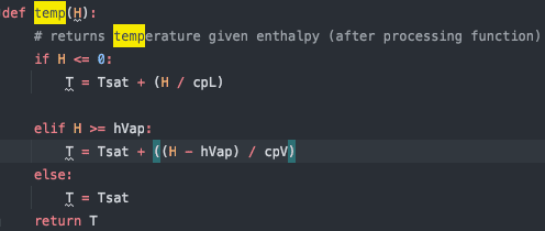

  • #342
Chestermiller said:
Pressure is not constant in a flash calculation, right? And, in a flash calculation, heat of vaporization is implicitly included.
Yes you're right I think my terminology is poor. I assume when you say flash you mean going from P1 to P2 where P1>P2. What I meant was using the known P and H values to calculate T, density, etc. In the thermo library this is called 'flash', however yes I agree its not really 'flashing' in the real sense. Are we on the same page there? And what is the name for the calculation I'm describing, if not flash?
Chestermiller said:
Now that you are adopting this approach, you should do the calculations outside the bed model, and parameterize the relationships between temperature and density vs enthalpy and pressure using analytic fits to the results of the flash calculations. That seems like the easiest thing to do. Then you won't have to be doing flash calculations or VLE calculations within your main model.
Ah I see. For reference, here is the line of code that I use to calculate the temperature and mass holdup of the air mixture given the enthalpy and pressure:
The setup of the air mixture is a bit more complex. However as you can see its very simple to use the flasher itself to calculate H and P dependent properties. We mentioned earlier getting analytic fits for T(H,P) and density(H,P). Unless I'm misunderstanding, the flash calculation gives us this fit indirectly (and easily) i.e. we in effect have T(H,P) and density(H,P) through the flash calculation. Do you agree with that?
If the above is true, then it seems like its slightly easier to use the above code, rather than extract the analytic relationships T(H,P) and density(H,P)?
I also think it would be useful to post the 'flow' of the code with the added flash calculation now. I'll do this today

  • #345
Chestermiller said:
I think you need to ascertain exactly what this calculation does. Is it a VLE calculation or an actual flash calculation.
A VLE calculation, where P and H are known, and are used to find T and density yes
Chestermiller said:
OK, provided we are convinced that it is just a VLE calculation, where you specify the T and P and it calculates everything else, including split. Still, there is an iteration that is going to be involved in specifying H and P and extracting T and density. After all, in the model, you dependent variable is H, not T.
Exactly, H and P are specified, and T and density are extracted (after some iteration etc). However what I'm saying is that the thermo library takes care of this iteration for us. So all we have to do is supply the library with P and H, and it will do the iteration required to solve for T and density. This is useful because it means there are no large blocks of iteration code to be seen in the main script
So what I can do is replace our previous temperature function here:
With this new function:
The advantage of the second one is that it is analytic, so that single line allows us to take our known H and P values and convert them to T values
The same thing can be done for the mass holdup function, as the VLE calculation done in the thermo library also allows us to get density. I can just multiply by volume to give mass holdup
The final function to be replaced by an analytic one is the ## \frac{d\rho}{dH}## one. As shown in the earlier message above, are there any properties we can assume as constant (while density and enthalpy change)? We can multiply these derivatives together (chain rule) to get to the objective derivative ## \frac{d\rho}{dH}## I think
EDIT: The T(H,P) and density(H,P) functionality is now in place so we have analytic values for T and density at each H and P value. I think replacing the ## \frac{d\rho}{dH}## derivative is a natural next step as it is the only remaining non analytic function

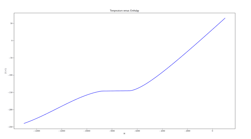

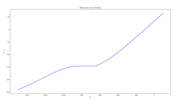

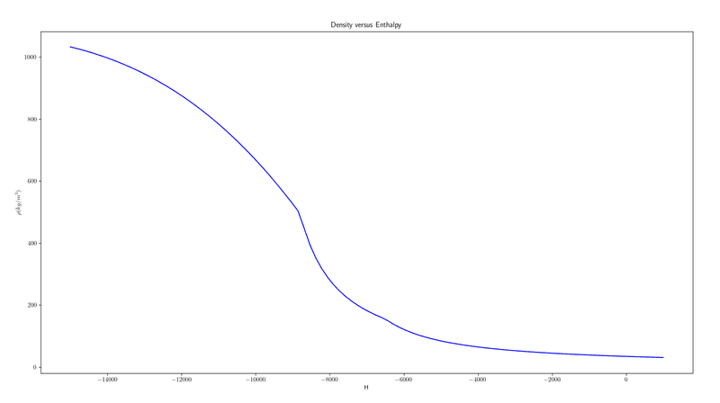

  • #347
Chestermiller said:
Maybe you can supply some graphs of T(H,P) and rho(H,P) to examine?
Yep can do

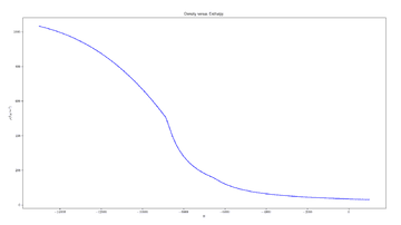

  • #348
Hi Chet, T(H,P) and rho(H,P) plots as mentioned (at 30 bar for a range of enthalpies):
We can clearly see the phase change zone in the temperature plot (constant temperature).
These plots were produced assuming constant pressure of 30bar. They were also produced with the d(rho)/dH function you derived. As mentioned, we can replace this derivative with an analytic one, as they are available in the thermo library, however its not clear to me which derivatives to chain rule to get d(rho)/dH
What info were you hoping to examine in these plots?
Thanks

  • #349
Thanks
The temperature should not be constant in the 2 phase region. It should be varying a little with enthalpy. Just for clarification, you are assuming in these calculations an overall mix of 80 mole % N2 and 20 mole % oxygen, right? Also, is it possible to provide the vapor-liquid split (molar or mass) vs enthalpy? Other pressures? The enthalpies presented in the plots are per mole of mixture or per kg of mixture? The densities are molar densities or mass densities?

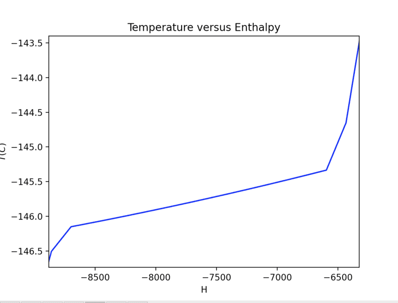

  • #350
Apologies yes it does vary. Zoomed in plot of enthalpy versus temperature for the two phase region, showing the temperature increase of approx 2-3C :

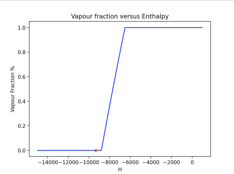

Effectively. The exact mole% breakdown is: N2 = 78.08, O2 = 20.95, Ar = 0.97%
The Argon boiling point falls between that of N2 and O2 so our assumption of a single boiling point rather than an envelope is valid still
Vapour-liquid split (molar) vs enthalpy (J/mol)
Enthalpy units: J/mol
Density units: kg/m3
Yes the units are not of the same basis, however I just picked kg/m3 units for the density plot as its easiest to visualise. Are there preferred units? I can provide either easily
Note also these plots are not packed bed related model output plots just plots of various properties of air as a function of enthalpy and pressure
If there is any other enthalpy/pressure dependent info required at this point I can provide it
OK. If you're happy, I'm happy.
For the d(rho)/dH, this comes from the d(rho)/dt term for a tank. Since rho is now a function of H and P, strictly speaking there should be contributions from d(rho)/dH and d(rho)/dP. However, I think that the latter is not going to contribute significantly, and can be neglected. Besides, we are not directly calculating dP/dt for each tank (although, I suppose it can be lagged one time step).

  • #354
Great
So to get an analytic solution for d(rho)/dH, is it correct to say that you're suggesting using our existing d(rho)/dt, which is dm/dt divided by volume (?), and then using our existing dH/dt to get:
$$\frac{d\rho}{dH} = \frac{d\rho}{dt} * \frac{dt}{dH}$$
Or if not, then we have analytic solutions for a number of property derivatives (post #343) that might be useful?

No. In the mass balance equation, we had to provide a relationship for ##d\rho/dt##. This was done by expressing it as $$\frac{d\rho}{dh}\frac{dh}{dt}$$. ##d\rho/dh## comes exclusively from the thermodynamics.

No. In the mass balance equation, we had to provide a relationship for dρ/dt. This was done by expressing it as dρdhdhdt. dρ/dh comes exclusively from the thermodynamics
Ok, so you're saying that ##\frac{d\rho}{dH}## comes from the thermodynamics. Does this mean we can use existing derivates to 'chain rule' to ##\frac{d\rho}{dH}##? Thermo library provides a number of these derivatives. Would any of the derivatives in post #343 be suitable here?
Just evaluate it as drho/dT divided by dH/dT at constant P and overall mixture.
  • #360
Hmm to confirm - drho/dT is found by (1/V)*dm/dt and we get dH/dt values from the energy balance. Then d(rho)/dH = d(rho)/dt * dt/dH
Two questions on that -
1) We will be calculating d(rho)/dt, an expression that depends on dm/dt while dm/dt itself depends on d(rho)/dt also. Do I need to calculate d(rho)/dH values at time j, from d(rho)/dt and dt/dH values at time j-1?
2) Leading on from that, at time t=0 we don't seem to have values for either of these. Can I Assume both derivates = 0 at t=0?
I can code this if the above is all true
