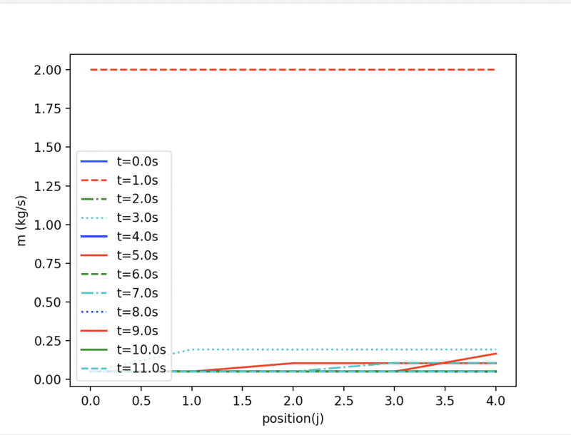

Chestermiller said:
What does ##\dot{m}## vs tank number at various fixed times look like?
Here's the same for n=32. there's a bit of chance involved in capturing good time increments given how short they are. n=32 does give a better sense of the 'wave' moving along the bed. Here it is:
The trend seems to be that the flow downstream of the saturation zone is much higher than the gas flow upstream of the saturation zone, and that this increased flow becomes less significant as we move downstream
  • #302
casualguitar said:
Given the spikes in mass flow are narrow, its hard to pick suitable time intervals that show this. However, this is a plot of the first 11 seconds in intervals of 1 second:
Its a poor quality plot (as I say difficult to plot when the saturation last <1 second at each position), so I'm working on presenting this clearly.
But yes for now this shows that after 1 second the mass flow in the tank is at a maximum of 2kg/s (much larger than the inlet flow), and this value matches the previous plot of time vs flowrate.
Also at approx 3 seconds we can see from the previous plot the flow is almost 0.25kg/s around the middle to the end of the tank (still much larger than the inlet flow), and this matches the position vs flow plot also
So yes while this plot isn't great it does line top with the last one
Your results do show the expected behavior that the mass flow rate increases monotonically with position through the bed. We ought to be able to get an idea of the amount of time it takes for the liquid phase to be fully cleared from the bed.
I'm still concerned about spikes in the results.

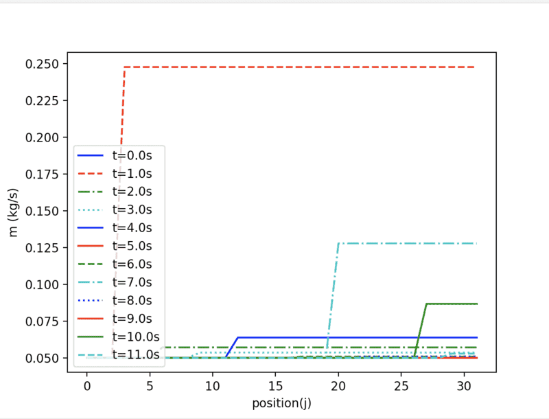

  • #303
This is more like what we expected. It looks like it takes only about 11 seconds to fully clear the liquid from the bed. After that, all you have is single phase vapor.
  • #304
Question: In your numerical scheme, when do you update the ##\dot{m}## variation?
(a) for all tanks simultaneously, at the end of each time step (before the next time step is initiated)
(b) for each tank in sequence, after the time step for the tank under consideration is completed and the same time step for the subsequent tank is to be implemented.
If you do case (b), do you use the average ##\dot{m}## over the time step (exiting the previous tank and entering the subsequent tank) as the input for this subsequent tank.
  • #305
(b), if I understand the differences between the two correctly.
After a given time step, equations 4b and 4a are used to generate the new ##\dot{m}## values for each tank in sequence.
No I use the value entering the subsequent tank, and don't take the average.
To do this, I guess I could use effectively the same calculation flow as I'm currently doing i.e. calculating mdot for each tank in sequence. Except, instead of taking the flow entering the subsequent tank as input to tank n+1, I can take the numeric average (min-mout)/2 as input to tank n+1. Correct? If so this is an easy change
Is it correct to say the reason for taking the numeric average here is because I'm currently evaluating the flux at the boundary, rather than at the tank centre? Taking the average would in effect be evaluating the flux at the centre

Chestermiller said:
All the liquid downstream is at 2 kg/sec, not just the spike. And all the vapor upstream is at the higher pressure. How does this effect the VLE? How are the flow and pressure boundary pressures imposed on this bed?
Whoops, yes I read the plot incorrectly. So yes the max pressure drop across the system could be close to 4 bar.
The VLE: How does the higher pressure vapour affect the VLE, or how does the pressure drop (about 4 bar) affect the VLE in the lower pressure regions? When you say how are the flow and pressure boundary pressures imposed on the bed, what do you mean by this?

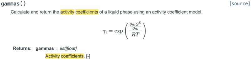

Chestermiller said:
Do you have any information on activity coefficients (or excess free energy) of liquid mixtures of N2 and O2?
I think so actually. There is functionality in the thermo library to return the liquid activity coefficients:
Chestermiller said:
What is understanding of how close the liquid behavior is to an ideal solution?
Effectively none. I'm not sure how to quantify this. What I could do, is take some things like heat capacity etc and plot the percentage variation between the ideal liquid heat capacity and the real liquid heat capacity versus temperature. Something like this?

Checking the literature for the O2-N2 liquid mixture VLE behaviour doesn't seem to return much regarding the activity coefficients.
To possibly simplify further I have one question - why not use an existing EOS model rather than the activity coefficients to model the vapour and liquid phases? If we used an EOS (one already written in code) it seems we could calculate any T or P dependent property easily, and we could assume non-ideality for the liquid phase because the work it would add would not cause a significant increase in modelling difficulty
That said, although I very much prefer the idea of using existing functionality rather than hard coding my own, I don't want to move too fast on that and lose understanding myself
What are your thoughts on using a prewritten EOS instead of an activity coefficient model?

So yes back the EOS point, the thermo library in Python has existing functionality to calculate both ideal and non-ideal heat capacities of pure O2/N2 and mixtures of these. It can also get the non-ideal enthalpy(T,P)
https://thermo.readthedocs.io/thermo.phases.html?highlight=mixture enthalpy#module-thermo.phases
I think we could save lots of time, and add more complex functionality if we use this. Do you think it is reasonable to use this functionality rather than hard code our own?
EDIT: Also, I'm working on getting the activity coefficients for air plotted as a function of temperature using this thermo library. I will post this plot once its working
