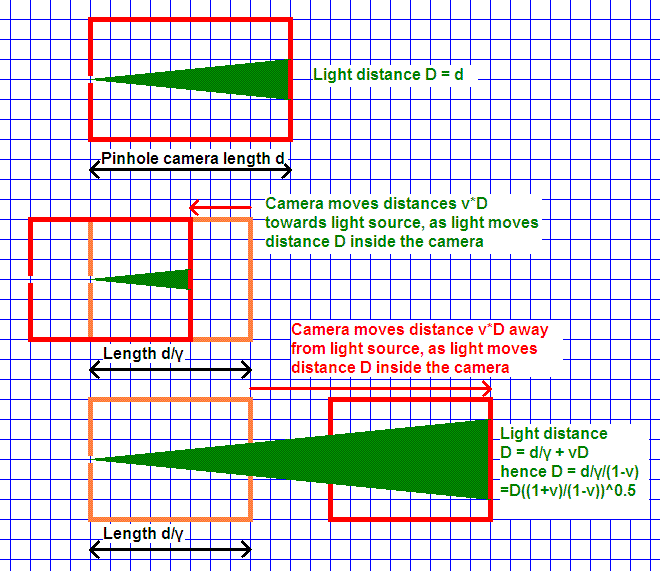

"From the point of view of spectators, the starship [...] remains the same size."
1. Wouldn't length contraction cause a sudden decrease in the starship's length from the perspective of the spectators?
"From the point of view of passengers [...] the Earth [...] remains the same size."
2. Wouldn't length contraction, in addition to reducing the distance to the star that the passengers observe, also contract the length of Earth and the star themselves?
From your diagrams, and from "However, if you find that the star ship is suddenly much much further away, then you must have altered your perspective":
3. Why would a suddenly inbound traveler (at the turnaround point) see the distance to Earth suddenly increase? Wouldn't they see it either suddenly decrease (if they were stationary at the turnaround) or stay decreased from the outbound trip? Doesn't length contraction work in all lengthwise directions?
4. I seem to have a lot of questions about length contraction. Am I misinterpreting the way length contraction works?
From the point of view of the space ship, they see the distance increase because the distance really is larger. Distance depends on perspective, and when you have a new perspective, there's a new and larger distance.
Note that this has nothing particularly to do with Lorentz contraction. It is simply difference in the distance co-ordinate for a given point in spacetime under two different Lorentz transformations; for velocity v and velocity -v.
You can also get a different way of looking at the same thing, from the point of view of aliens on the star watching the spaceship suddenly reverse direction. The spaceship has a little pinhole camera which is capturing light from the Earth. The size of the image on the back of the camera suddenly reduces when the ship reverses direction. (And note that the size of the image is transverse to motion, and is the same for the aliens as for the space ship; no Lorentz contraction involved.)
From the point of view of the travelers, the smaller size is because of a larger distance to Earth.
From the point of view of the aliens, the smaller size is because the camera is now moving into the stream of light from the Earth. The back of the camera moves towards the point where the pin hole used to be, and so the effective length of the camera is reduced, making a much smaller image. If the camera is length d, and moving away from incoming light at velocity v/c, then the light entering the pin hole has to travel a distance (1+v/c)d before it hits the back of the camera. When it reverses, the distance is (1-v/c)d, and the image is smaller by a factor of (c+v)/(c-v).
Lorentz contraction doesn't come into this either, because although "d" is along the direction of motion, it is equally "contracted" for +v and -v.
You calculate the same number exactly by using the new distance to Earth from the point of view of the spaceship.

Excuse some self-indulgence...
The notion that the angular size of an object in the sky depends on your velocity is not one that is often raised in traveling twin discussions, but it is one I have found useful, so I thought it worth while to explore a bit further.
You can use the Lorenz transformations as shown in the previous post to show that the light you see from a distant remote object is actually emitted at distances that depend on your velocity, according to the factor
[tex]\sqrt{\frac{1-v}{1+v}}[/tex]​
where v is your velocity away from the object. Hence you should expect the apparent size in the sky to vary by this factor as well, though inversely. (I am using units where c=1 throughout.)
You can also get the same result by reasoning from the point of view of an observer stationary with respect to a distant object, and thinking about the size of the image obtained within a pinhole camera.
Suppose you have a pinhole camera of length d. It will project an image of a certain size at the back of the camera, which is proportional to the length of your camera, and to the size of the object, and inversely proportional to the distance to the object.
Now take your camera, and move it rapidly towards, or away, from your light source. The image in the camera changes size. Here's a diagram of how it works:
At the top is a simple pin hole camera, length d. The distance to an object is inversely proportional to the size of its image. The images were constructed assuming velocity of 0.6 light speed, in which case the gamma factor is 1.25, and the Doppler scale factor is 2. The image on moving towards the object is half size; and on moving away it is double size.
Suppose you move the camera rapidly away from the object. The camera is Lorenz contracted to be length d/γ. If the light moves a distance D inside the camera, then the back of the camera has moved a distance Dv away from the pinhole over the same time. Hence the total distance moved by the light from entering the pinhole until it hits the back of the camera is
[tex]\begin{equation*}\begin{split}<br /> D &=d/\gamma + Dv \\<br /> D &= \frac{d}{\gamma(1-v)} \\<br /> &= d\frac{\sqrt{1-v^2}}{1-v} \\<br /> &= d\sqrt{\frac{1+v}{1-v}}<br /> \end{split}\end{equation*}[/tex]​
Moving towards the source is the same, except that v is negative.
Since special relativity is self consistent, we obtain the same answer as was given just by working in the frame where the camera is at rest and the source is moving, in which case the size of the image is given by the distance to the object, which is obtained from Lorenz transformations.
Cheers -- sylas
