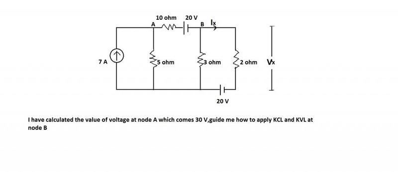

The current Ix and Vx in the below circuit are
Circuit schematic with a 7 A current source on the left feeding node A, a 5 ohm resistor below A, a 10 ohm resistor and 20 V source between A and B, a 3 ohm resistor below B, a 2 ohm resistor on the right with current Ix, a 20 V source at the bottom right, and voltage Vx marked across the right side.
Volt at node A= V.
Applying KCL at node A,
V/5+ ((V-20) /10) -7=0,
3V =90,
V=30.
Please show your working for calculating the voltage at node A.
