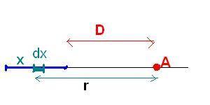

As shown in the figure, a rod of length 9.8 m lies along the x-axis, with its left end at the origin. The rod has a non-uniform linear charge density λ = αx, where α = 0.009 C/m2 and x is the position. Point A lies on the x-axis a distance 3.59 m to the left of the rod, as shown in the figure.

The potential is additive, you need to integrate the contribution dV of a small segment of the rod dx with charge dq=λdx for the whole rod:
V(A)=∫(kdq/r)=∫(kλdx/r).
ehild
  • Diagram of a horizontal line segment with a thick blue portion labelled x on the left, a small dx marked near its left end, a red point A on the right, a red arrow D spanning from the segment's right end to A, and a blue arrow labelled r from the segment's left end to A.

Maybe this will help: r = 3.59 + x

dV is the contribution from dq to the potential at A (with respect to infinity). The integral of dV is simply V(A) the potential at A. Without charge, V is zero.
ehild
ok, so the integral for dv would be from 0 to 3.59 because you're integrating to the potential at A?
dV is in volts, not in meters. dV is integrated over the potential belonging to zero charge to the actual potential V(A) of the total charge of the rod. The integral on the right-hand side goes along the length of the rod, from x= to x=9.8 m.
You need to use the 3.59 m in the term "r", distance from the charge dq to A.
